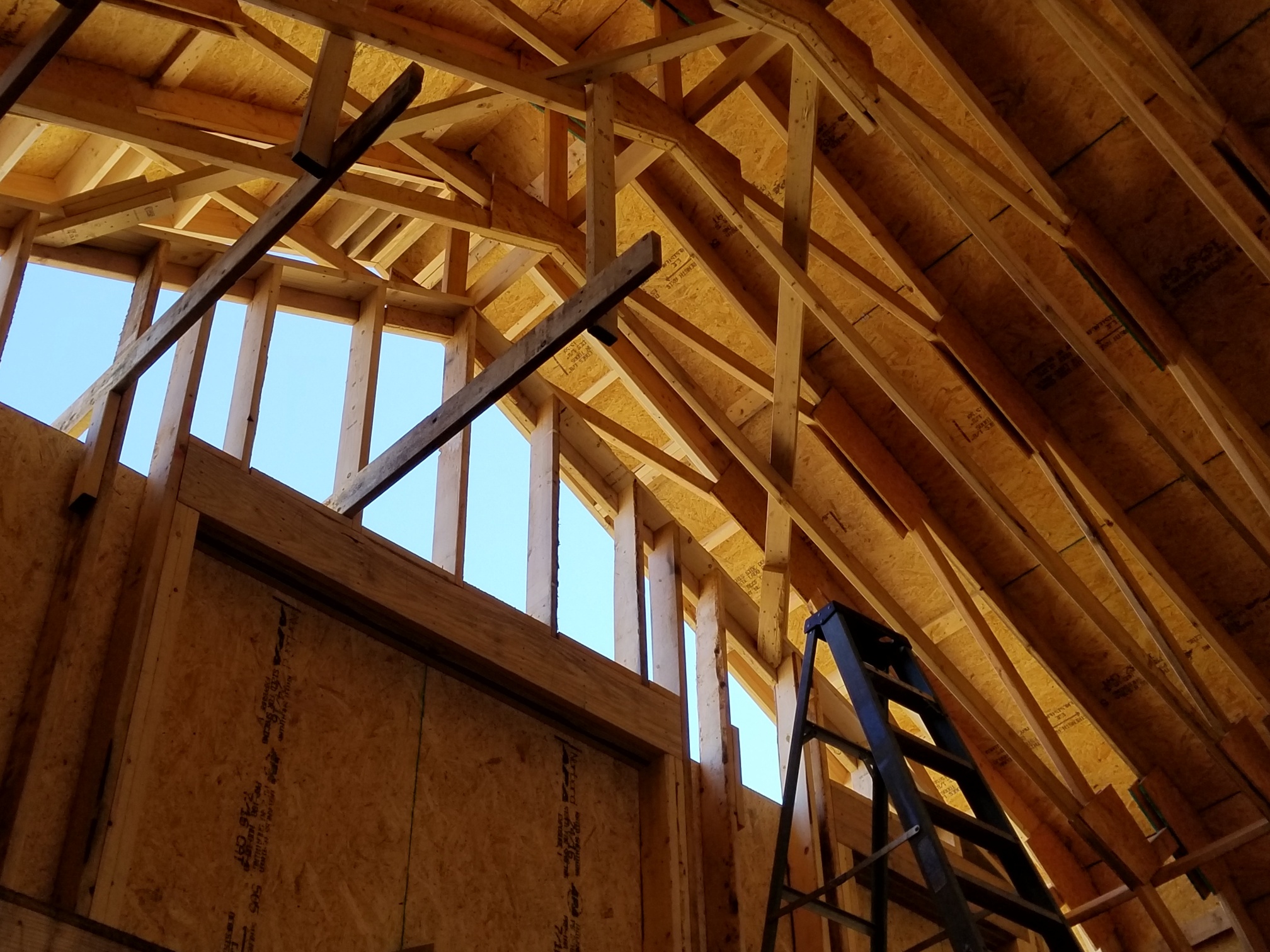

I'd be concerned about cutting trusses to install the dormers.
It was scary. The roof was tight. All trusses straight and true. We could call it done! Nope. We wanted the dormers. Read the plans again. Mark for the cuts. Read the plans again. Check the marks. Fix them. Read the plans again. Make sure we understand the headers. Read the plans again. Check the marks. GOOD! Cut the osb. Read the plans again. Cut the trusses. Take in the view. Pat self on back.
The trusses and the dormers, including cutting of the trusses, are done according to the engineered plans from barnplans.com. Truss stumps have headers, adjacent trusses are reinforced. Whew.

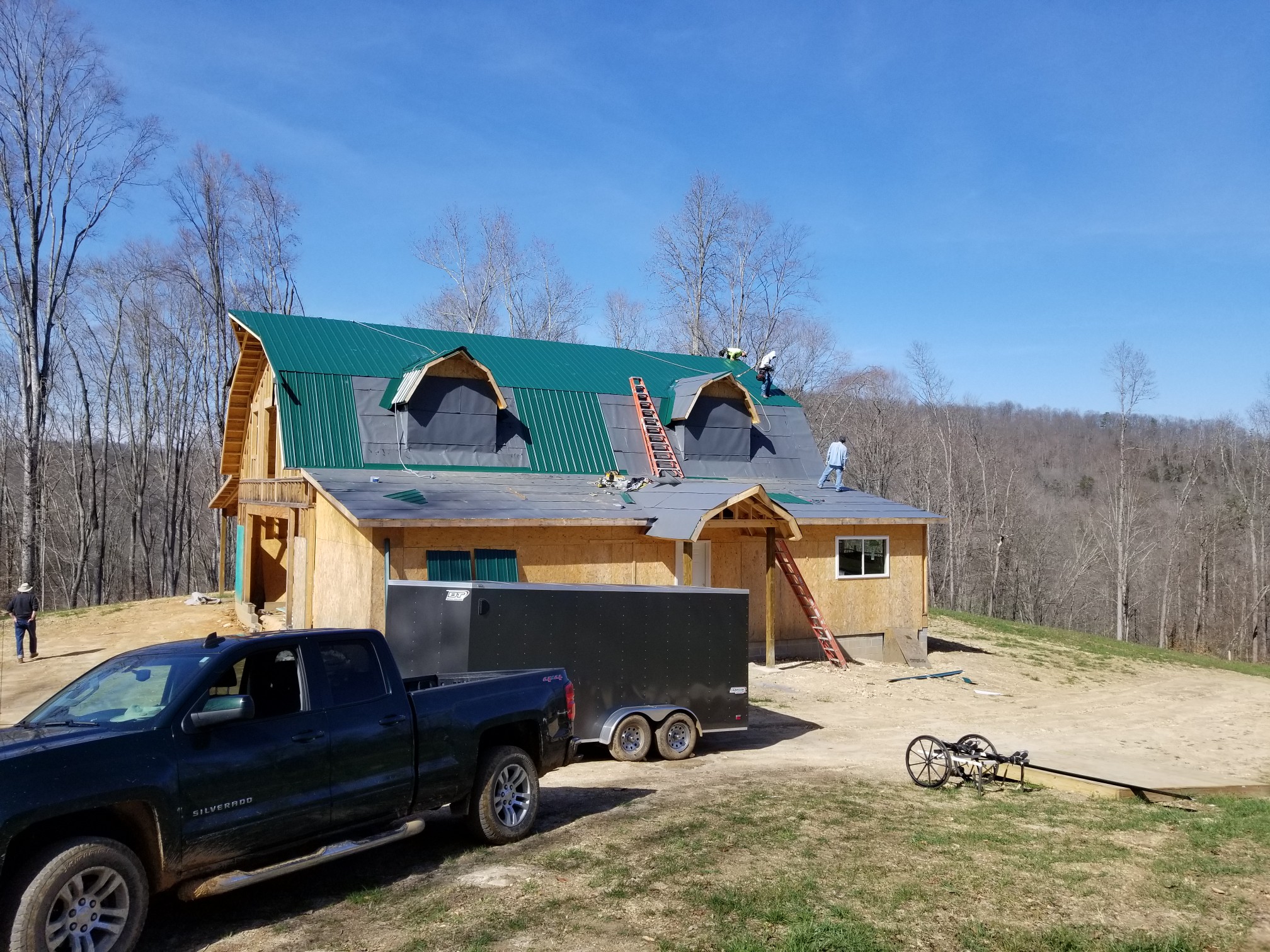

We left for home in January a little disappointed that the cold had limited our progress on that trip. The metal guys had just started on the metal when we headed north.
The entry porch roof was finished in February by my neighbor, including pouring the concrete in the now-thawed holes around the posts. We had some roof water problems in the next few weeks. It was finally determined that water was hitting the vertical osb on the front of the dormers, then running down and getting in. The roofer put some ice & water shield on the front of the dormers and stopped the intrusion.

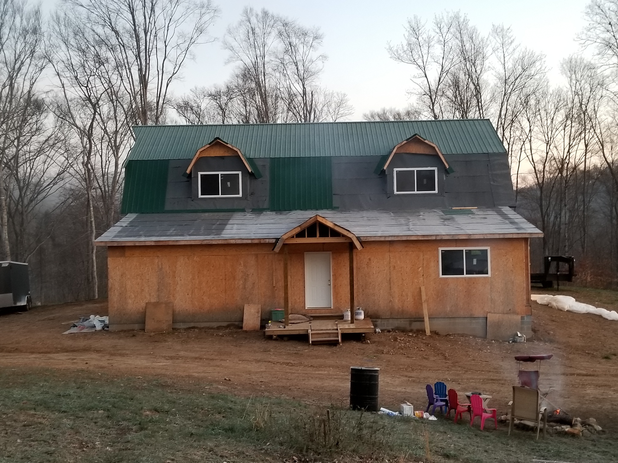

We got to spend another week there in early April. Our first job on arrival was cleaning up the chairs and construction debris that had been scattered by the wind. We then cleaned up the inside for company and got the trailer ready for the week. We had a bunch of family fun during the week, and also completed a few barn projects:
We added 2 more lvls to stiffen the 2nd floor joists next to the loft opening.
We installed windows in two of the four dormers.
We rebuilt the front entry porch around the new entry roof posts.
We purchased barn door hardware, framed the opening, and modified hardware to fit.
We completely sheathed the west gable end wall, and mostly sheathed the east gable end wall.
We sheathed over all door openings.

The roofer came out, and we discussed the plan to get the metal done.

Yes, Eddie. Tough to leave when things are exposed to the weather. The roof is weathertight, even without the metal being done, so that helps. The sheathing on the gable ends is finally stopping the rain from sitting on the subfloor. We will decide at siding time if any of the sheathing in the splash zone will need replacing. When we started construction I expected to be retired and living there by now. Life happens, and we are doing what we can to get it weathertight ASAP.
