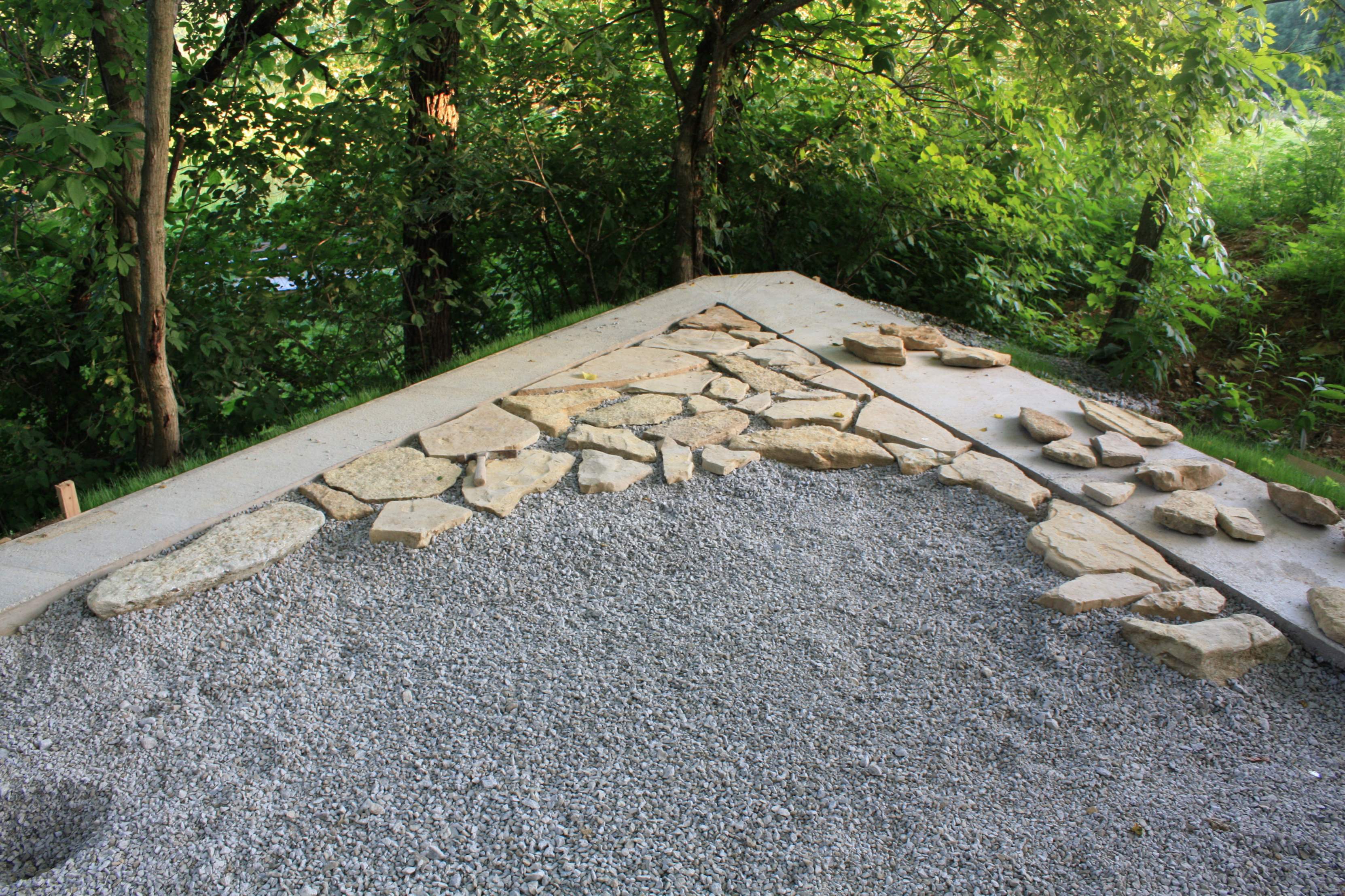

#25
Started laying the rocks, its a slow process for me, no 2 are the same thickness, and I have some pretty big rocks to lay by hand. To give an idea of how big they are, the one on the left is 36" long, and 6" thick. I know its not gonna be perfect and smooth, but I really like the look. I'm going to put sand in the gaps.

Looks good. I wish i had your rocks. What type of sand did you use to fill the gaps, and how did it hold up?

When I did a rock patio floor like you are I used decomposed granite to fill in between the stones. It's packs in real tight and you can get a spray to use on it to really lock it in place. I didn't use the spray stuff and really didn't have any problems with it. Bye way grate job on the project.
/ Outdoor Kitchen #40
When I did mine the first one we used the polymorphic sand (gets hard when watered down.) and it held up for one season OK. It (polymorphic sand) stained the first rocks anywhere it got on top of them. By 2nd season it was coming up in hard hunks of stuck together sand. On the other one I used the same coarse sand (back fill) for around the rocks and under them as a setting layer. The rocks are pretty good but have up to an inch + of miss thickness 1" one side maybe 2 inches on the other so I had to build up some with a compact-able fill sand to SET them into to keep them from moving much. When I did the Fire Pit we used the same sand around all of them. While it sweeps out it also didnt stain the rocks & the weeds pull out easily when they inevitably get growing in there. I dont use much ground clear weed killer as I like to drink my water without chemicals...
The size of the one you are doing is a BIG undertaking though. I did most of mine myself with some help from the woman (she helped more getting the stones out of the creek bed) but then she gave up attempting the jig saw puzzle that came next. Out of all of them I dont think I cut more than 8 or 10 rocks. used masonry blade/grinder wheel on a 9" grinder I bought at HF just for the job. Cut from the back side about 1/2 way thru then lay it over a edge & whack with a hammer.
