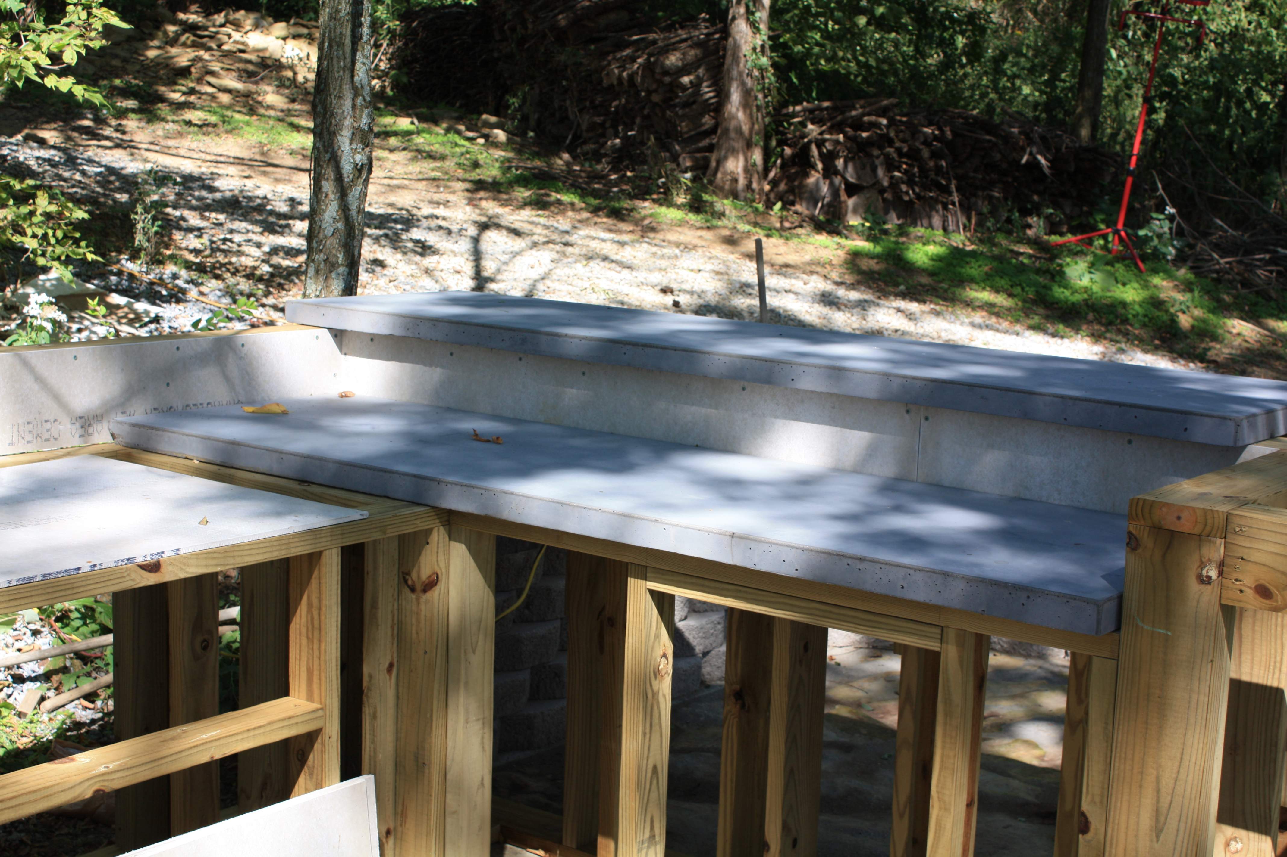

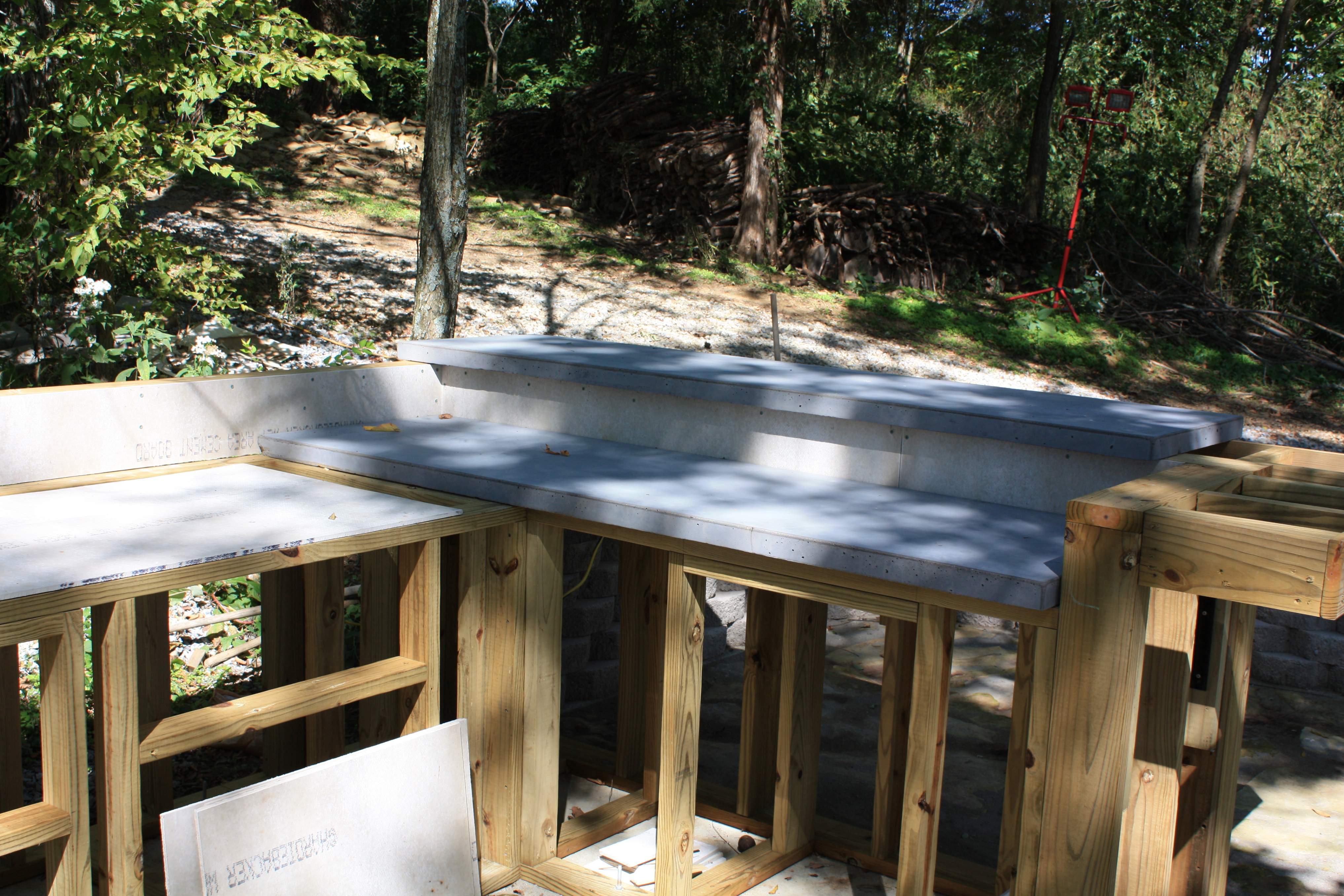

ustmd, I actually poured the first of the countertops two weeks ago, here's some pics of them already in place. I was very happy with how they turned-out. My wife wants to put them in the house when we finish the outdoor kitchen. These have been sanded through 400 grit. There is some tiny air holes, but i'm gonna wait until they are all in place before putting the slurry coats on, and final sanding.

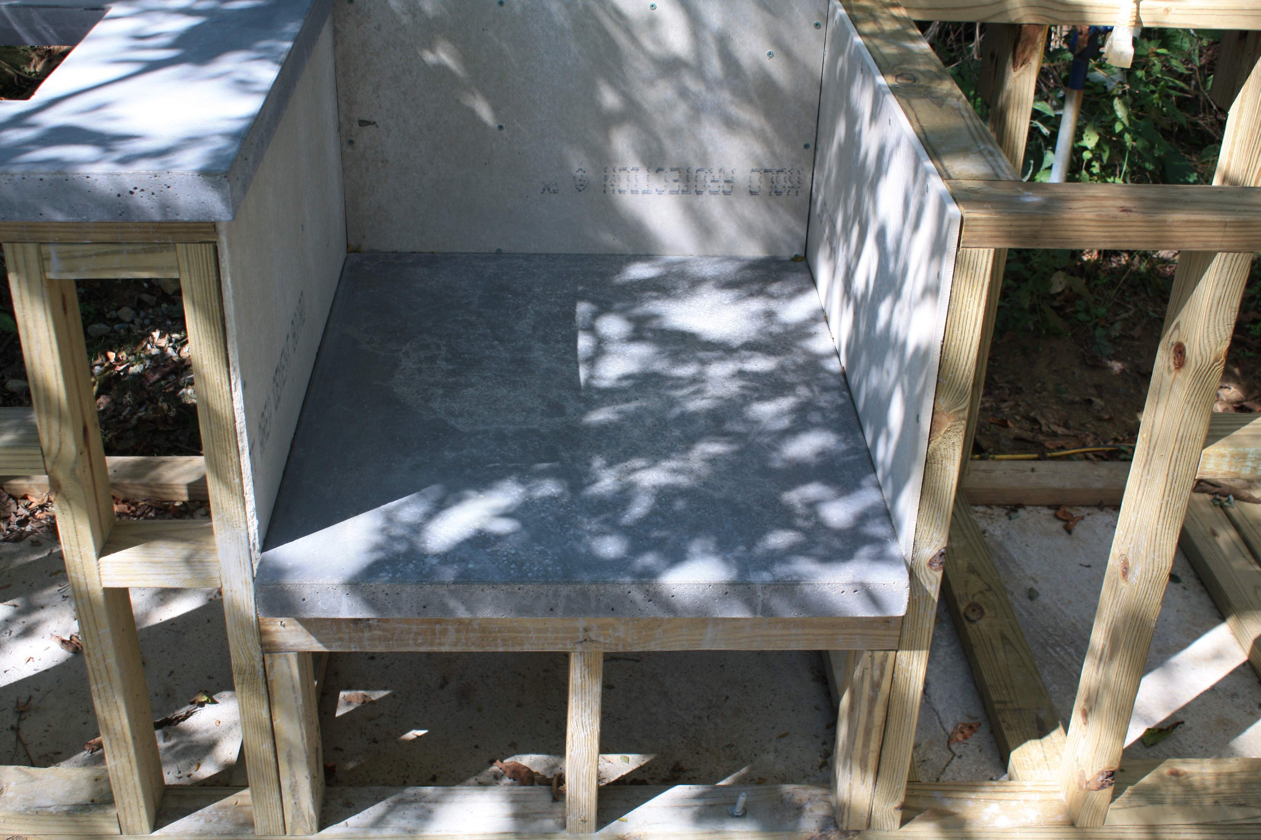

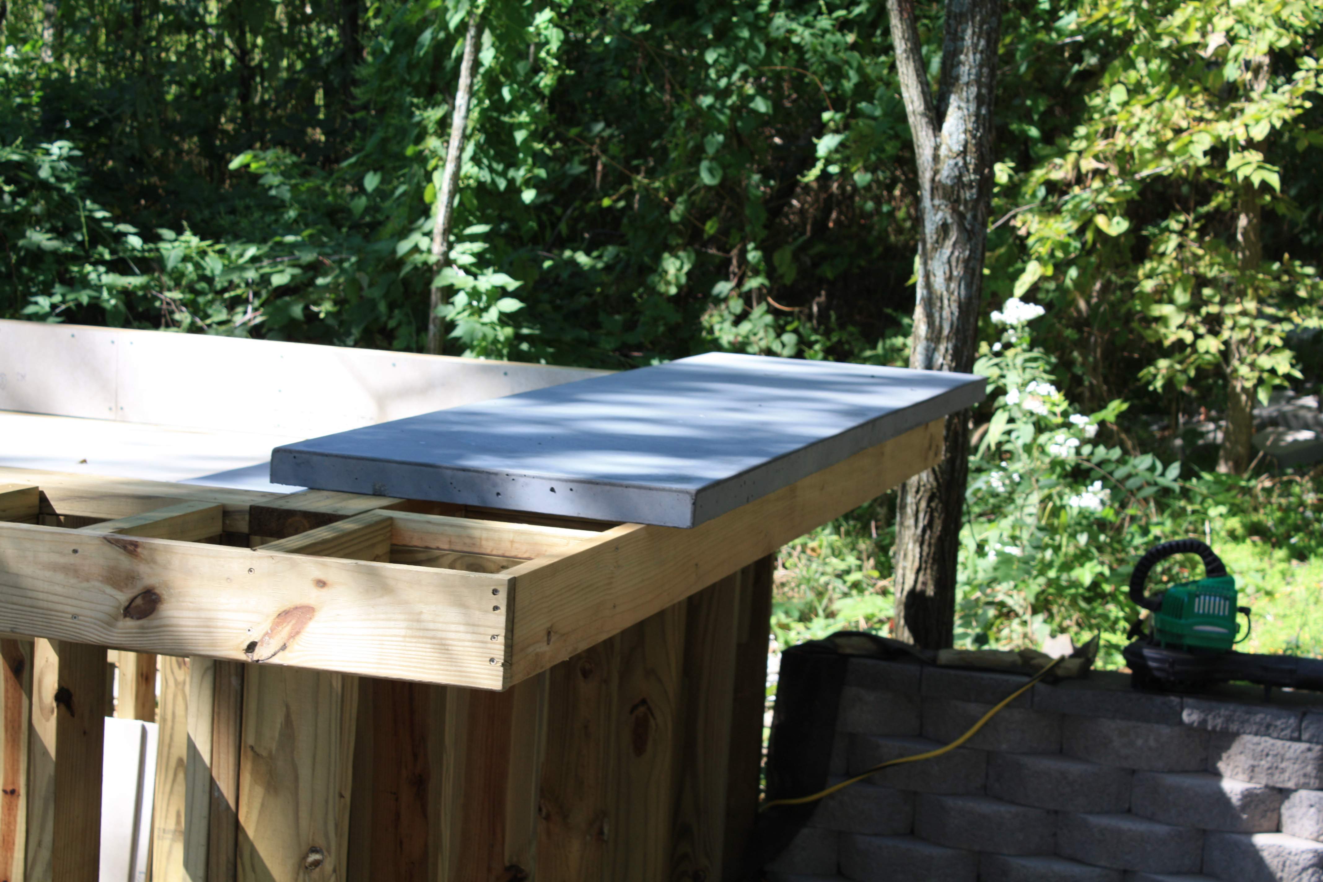

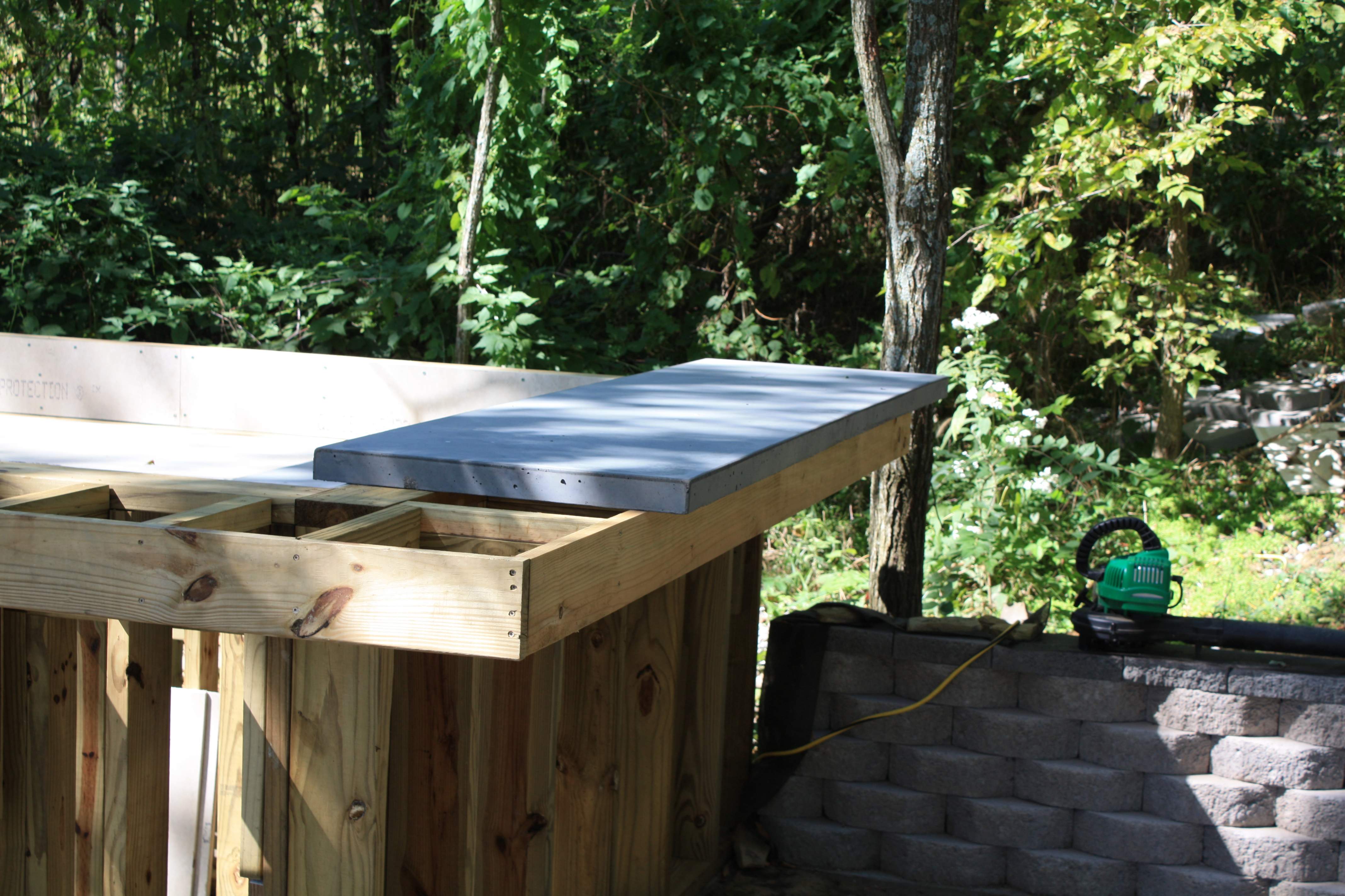

/ Outdoor Kitchen

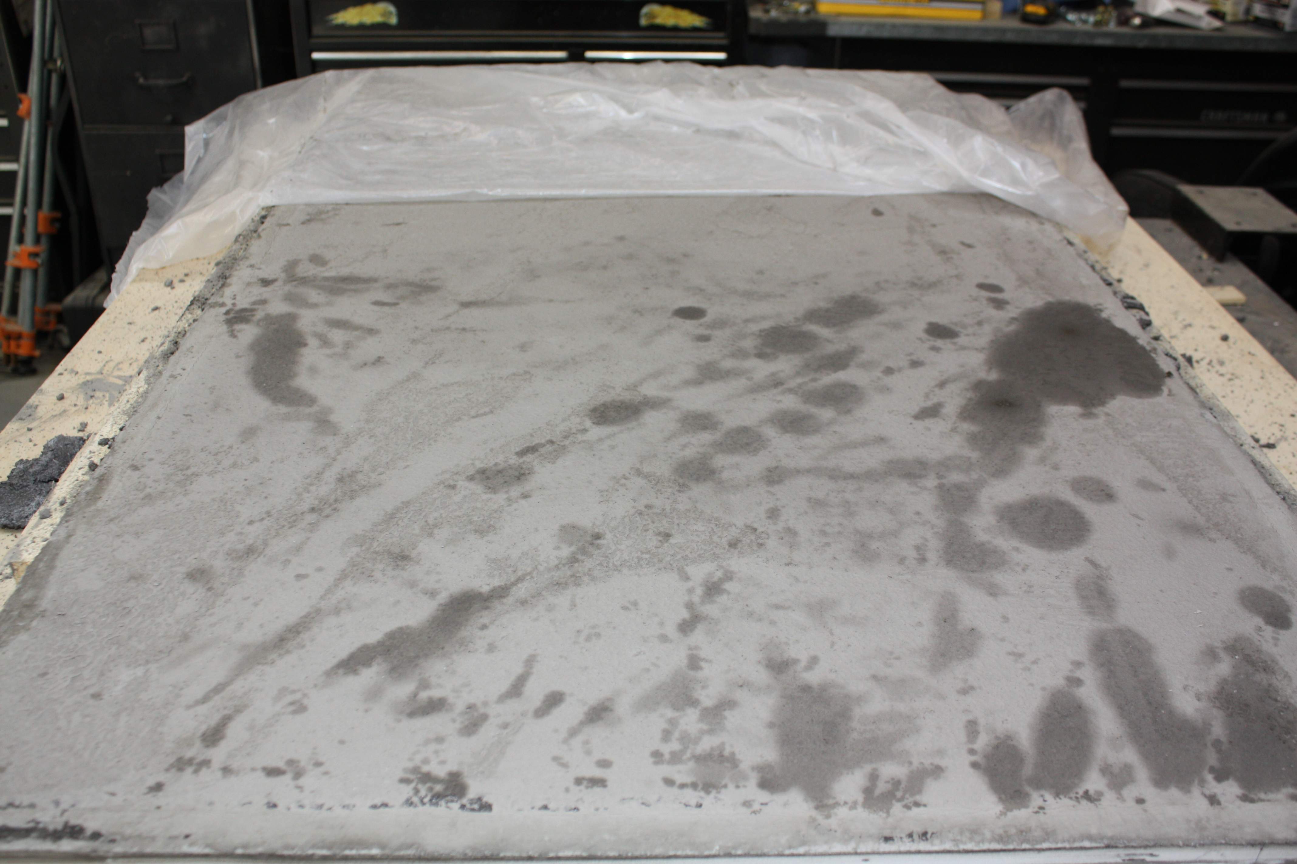

#76
These haven't been sanded at all. They are heavy. They feel almost as smooth as a granite countertop right out of the mold. If not for the tiny pin-holes, i would prob. just seal them as is.

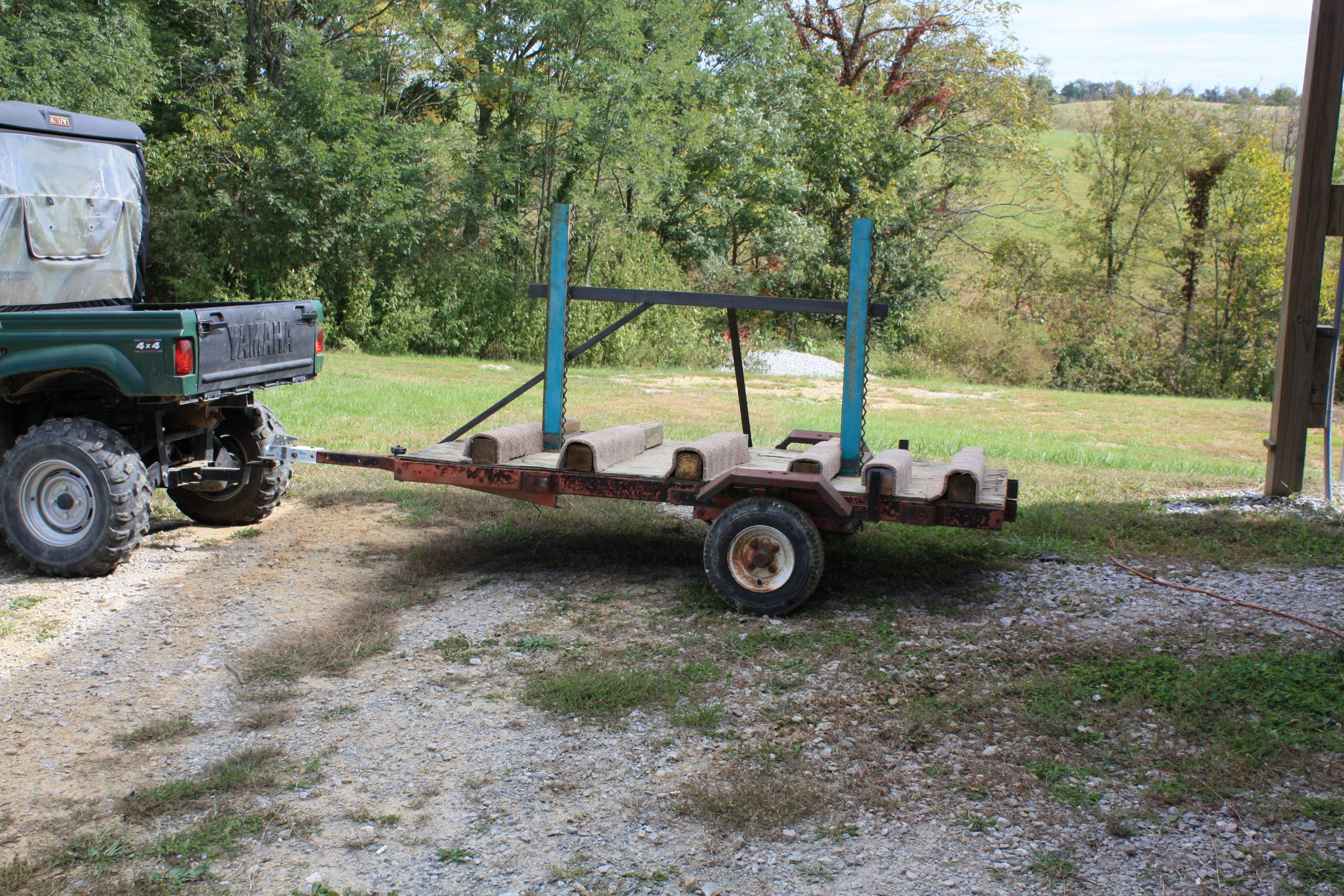

#78
This is what i came up with to move the countertops from the shop to the kitchen. I wanted to transport them on their edge, was afraid laying them flat they may crack. I didn't want to use the Kubota, figured it was to heavy for the rock floor. (it would have been perfect, i could have did it alone with it)

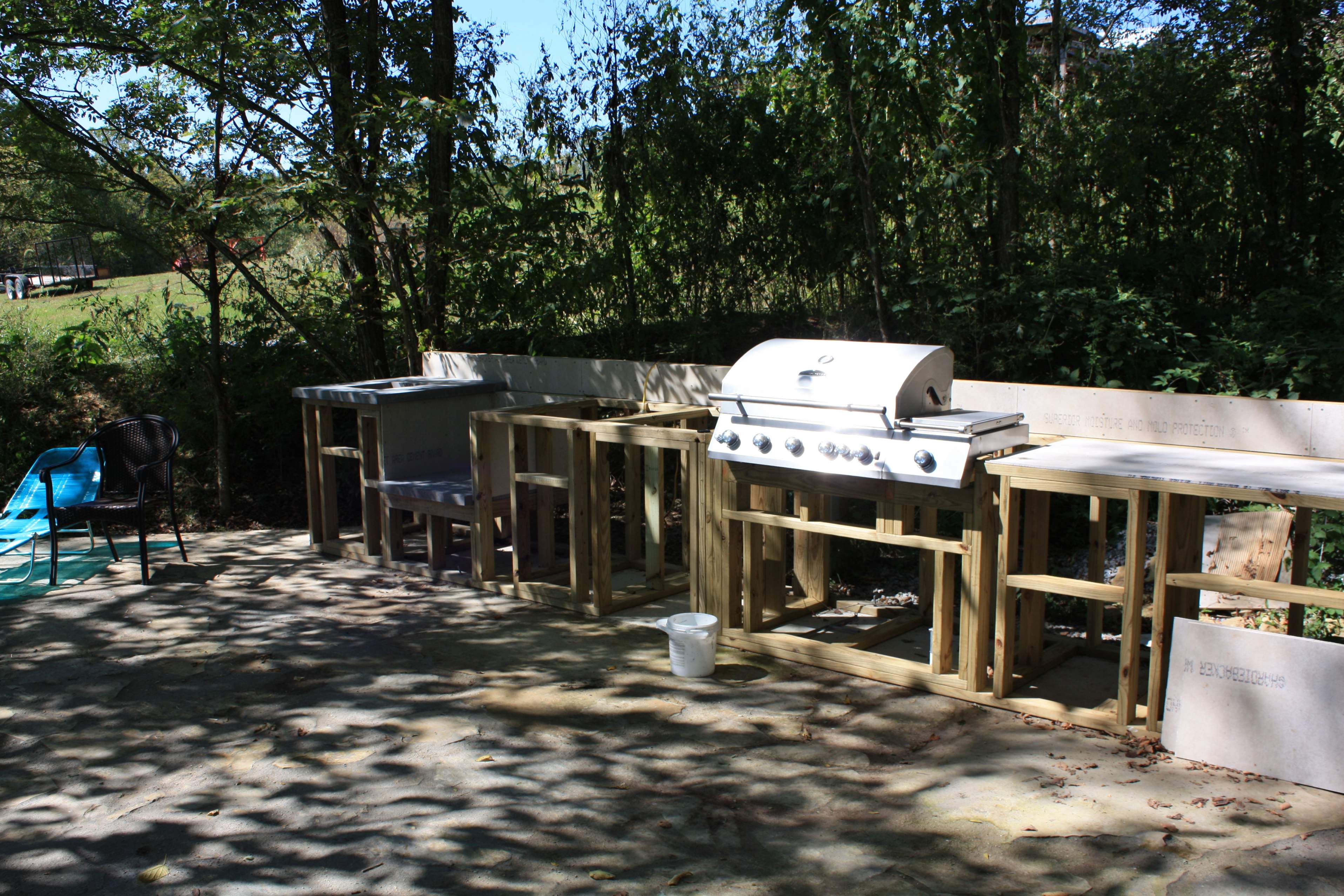

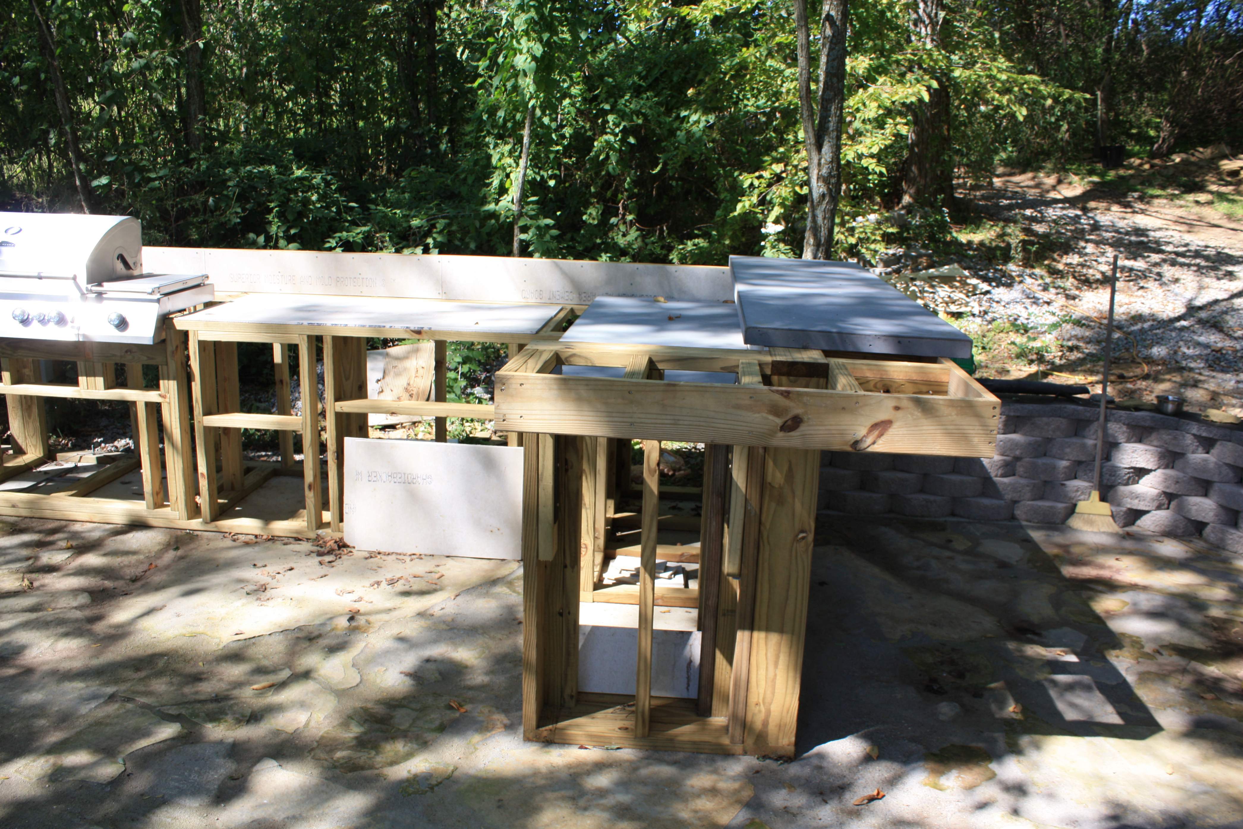

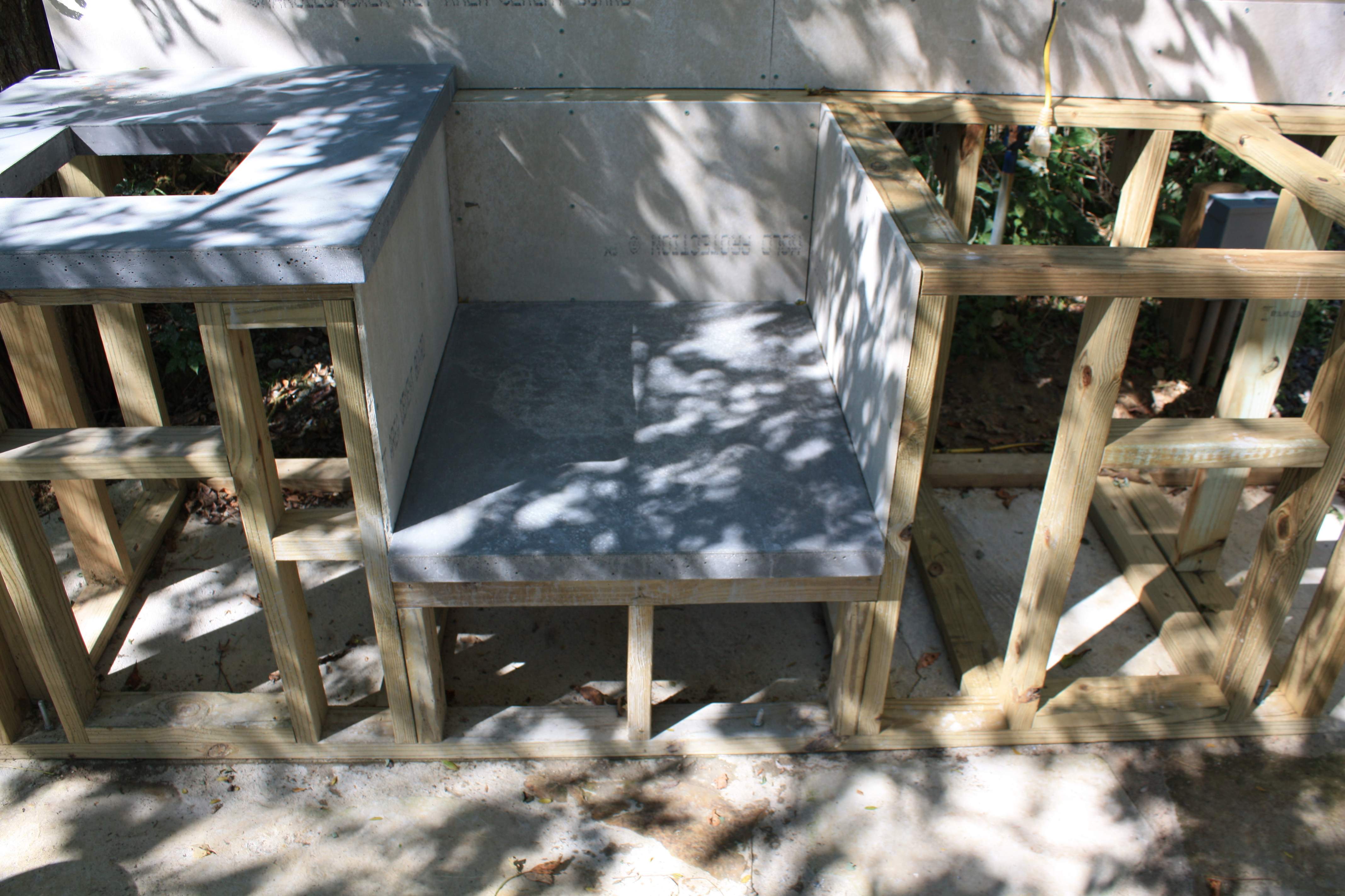

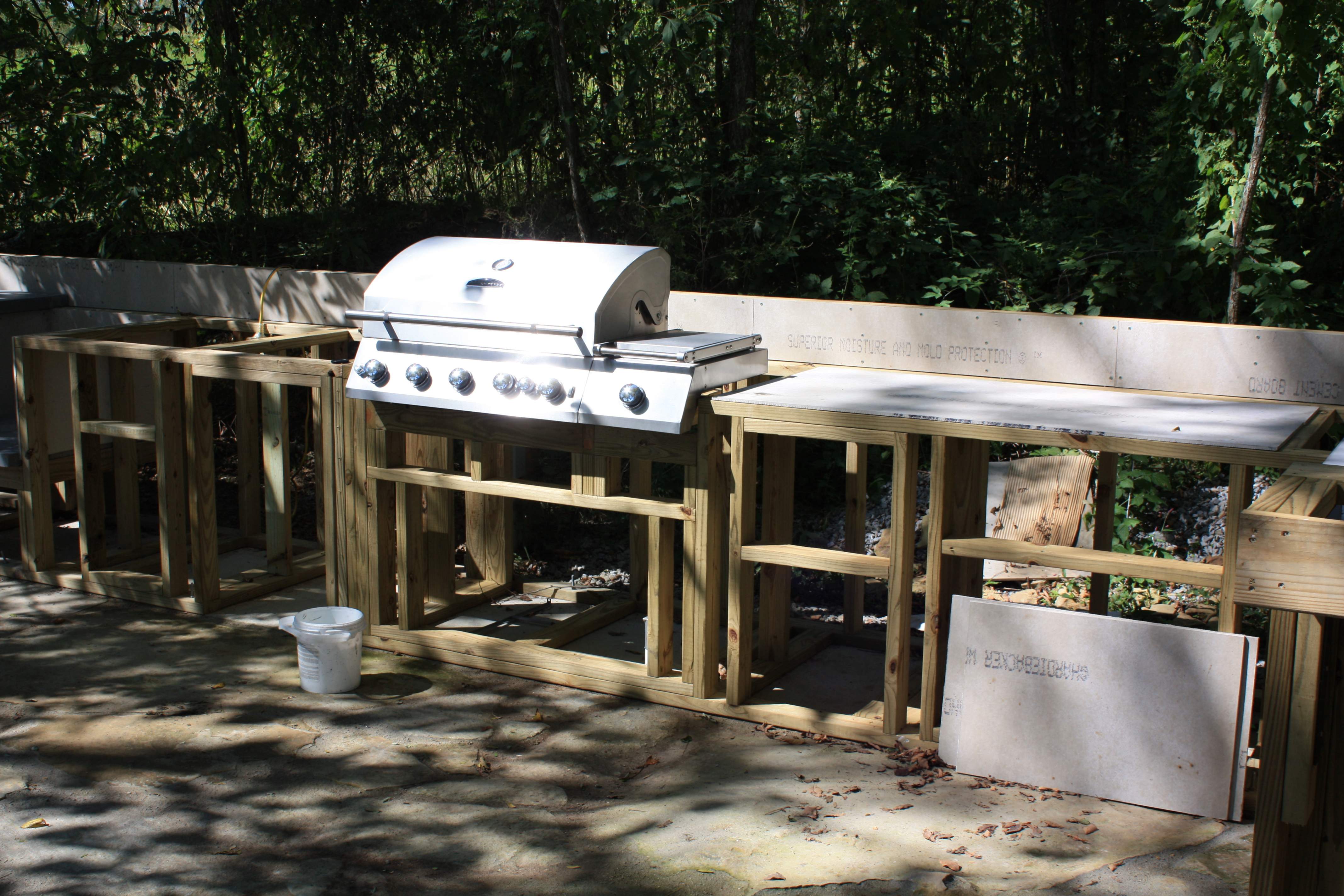

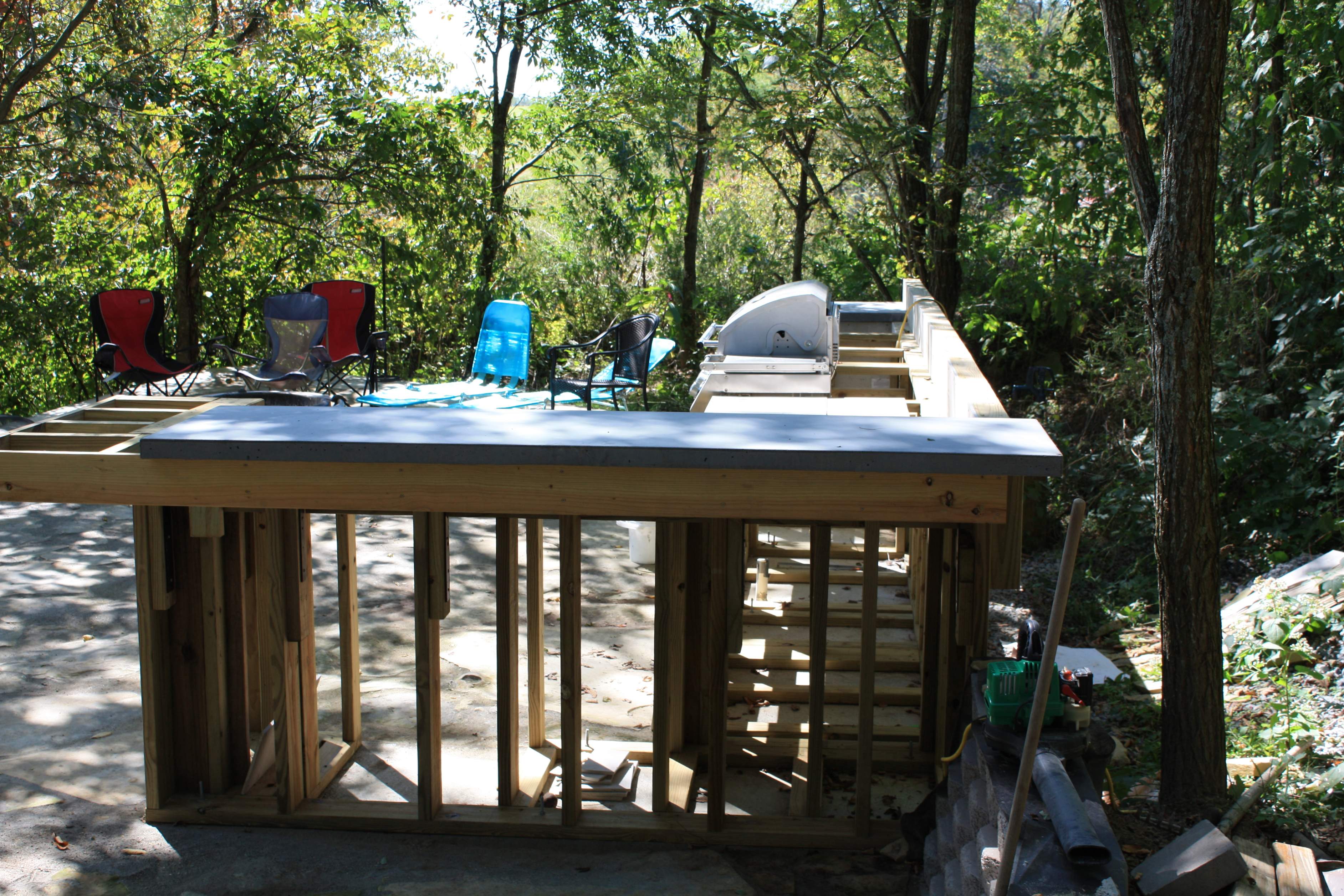

#80
Here's some pics of the framing. It's L shaped, 22 feet long with a 9 foot bar on the end.
