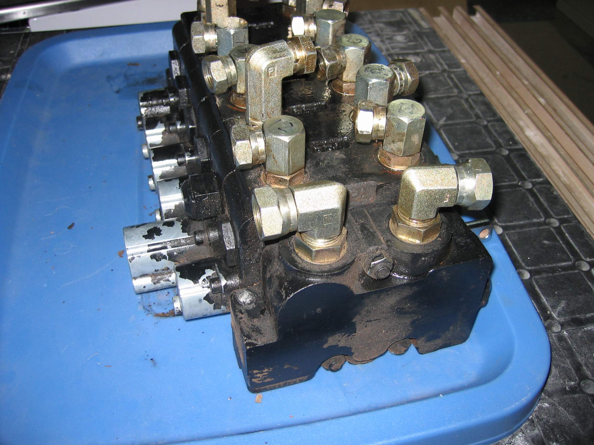

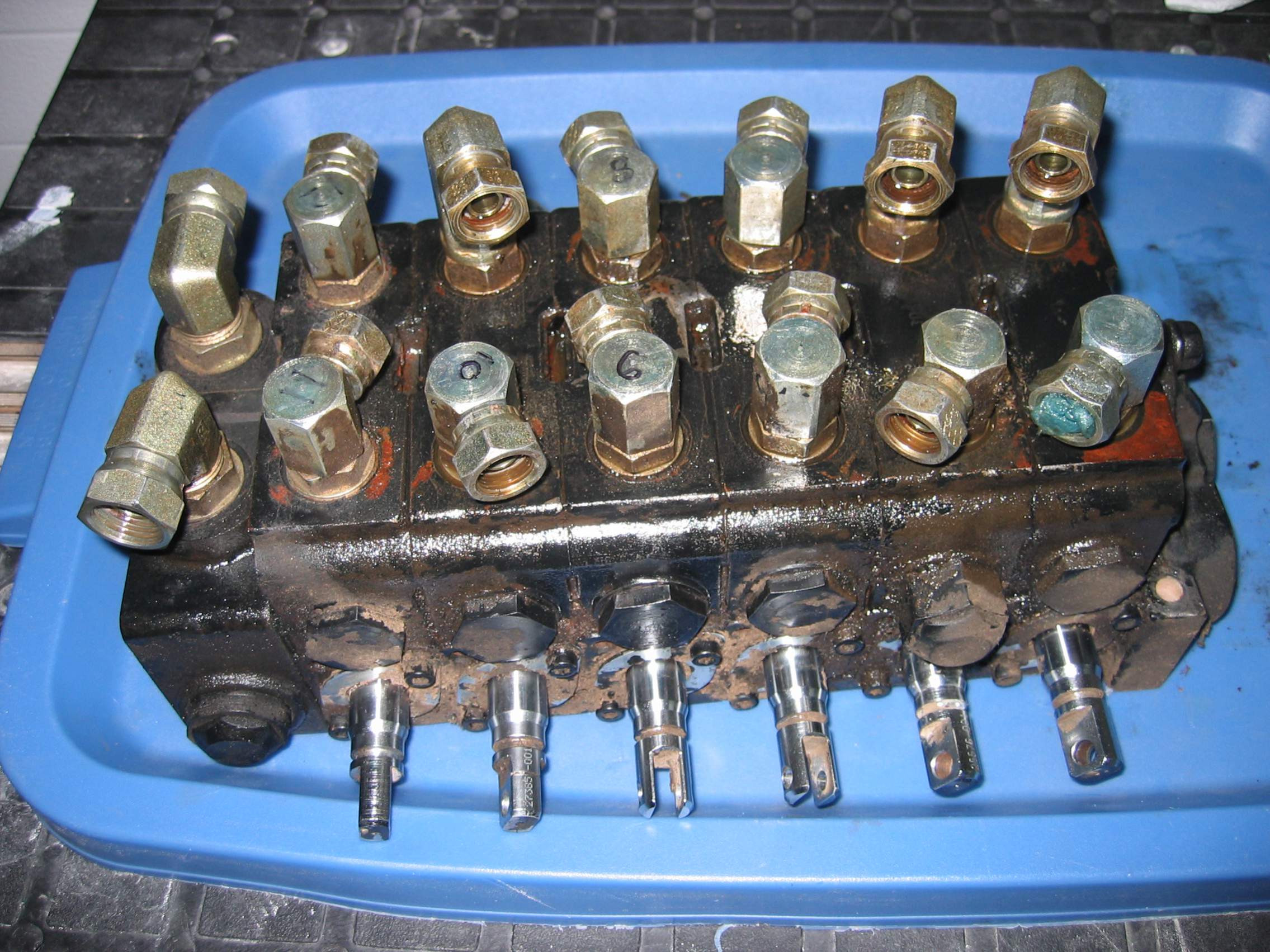

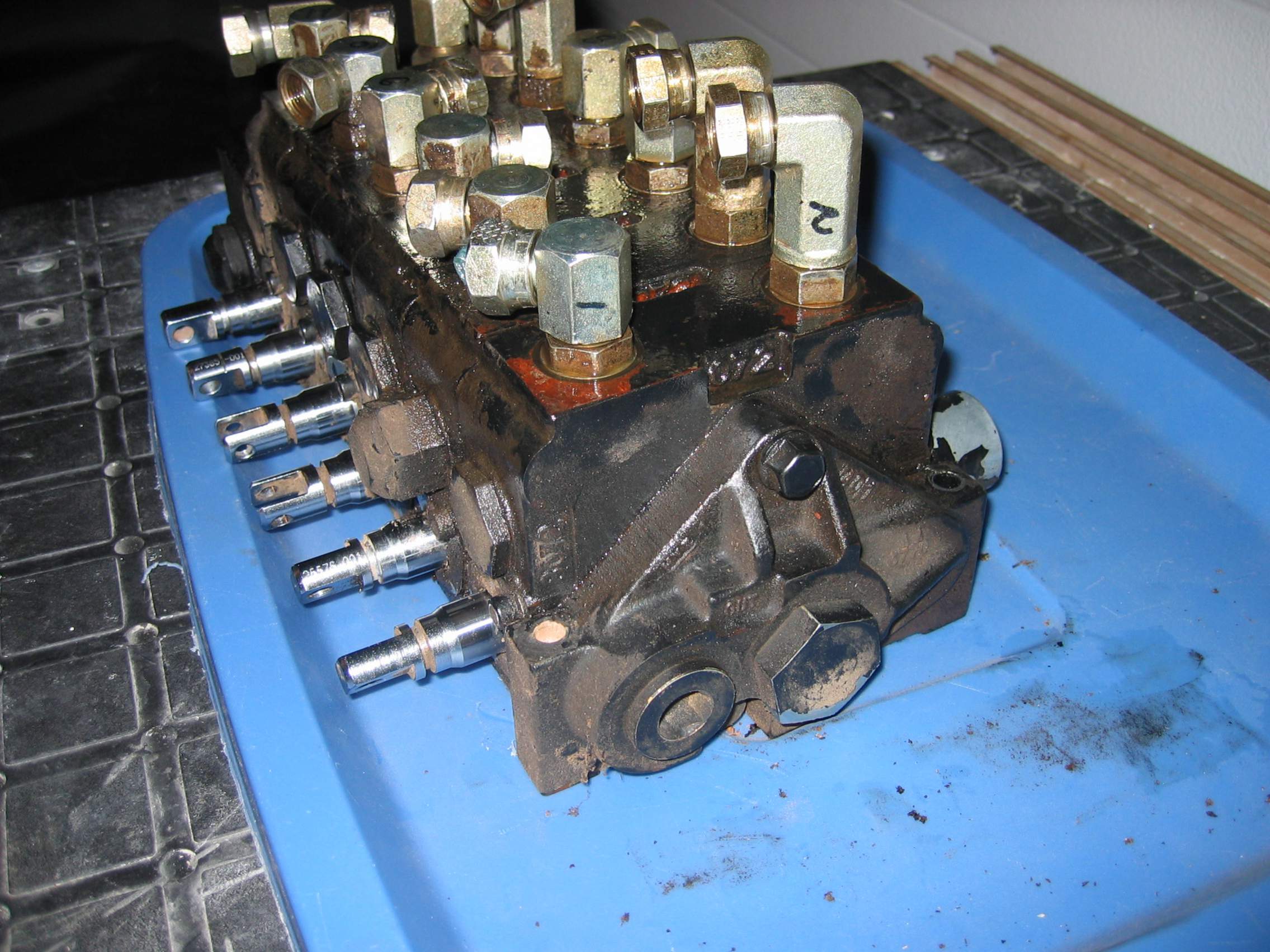

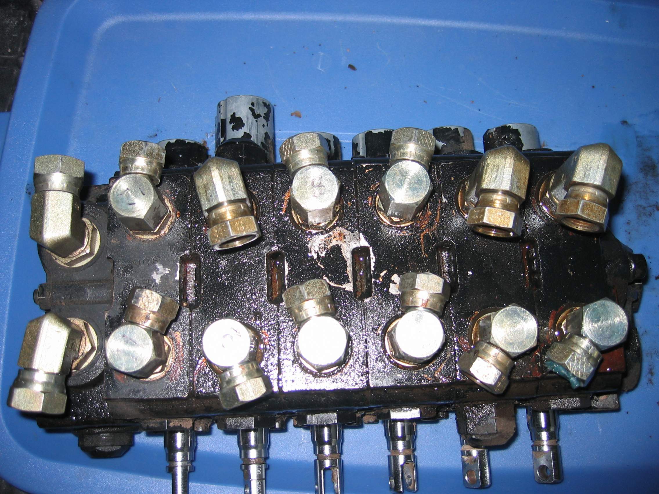

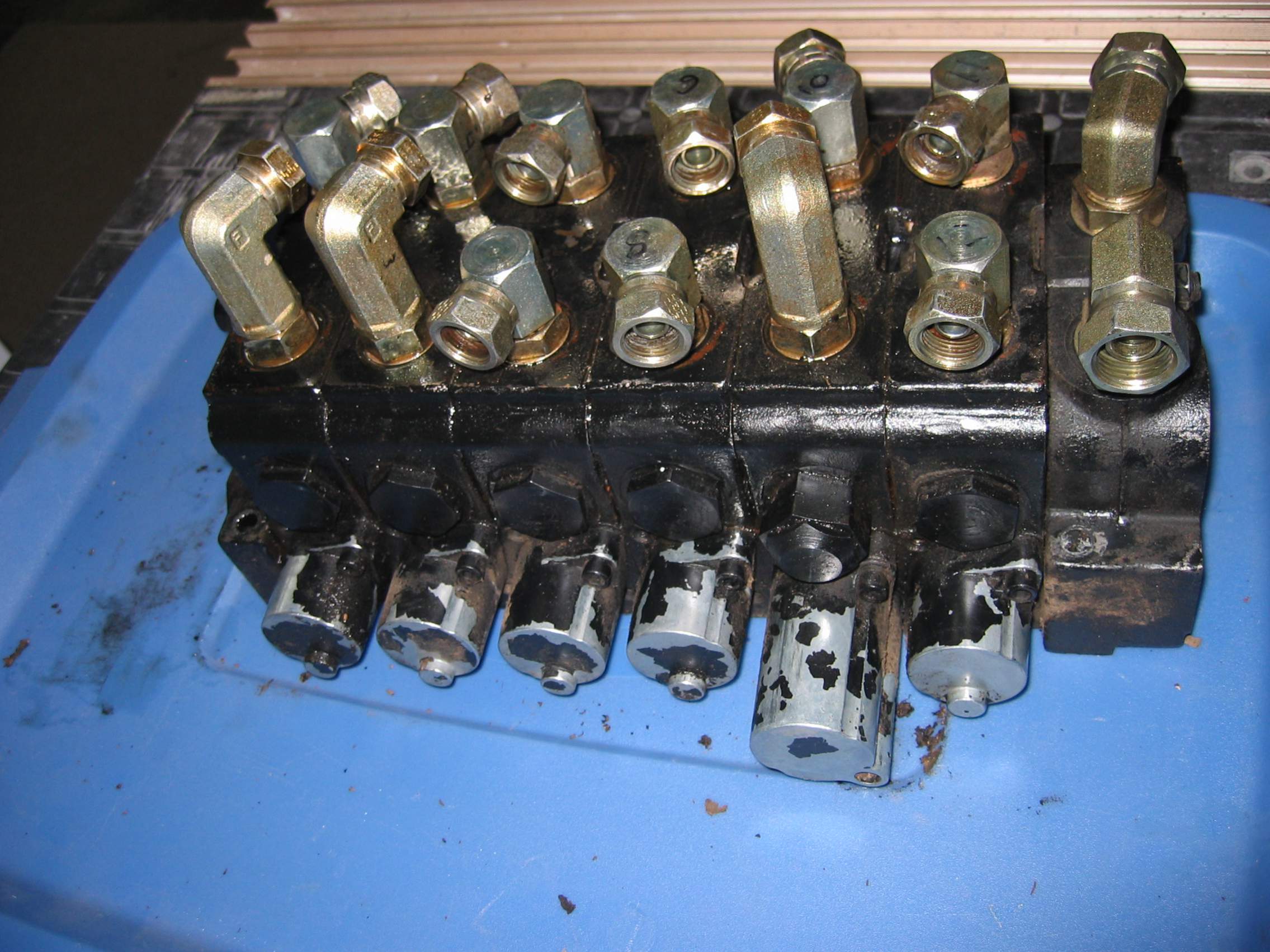

Okay, finally got the time to go further. Switched hoses today and the stabilizer cylinder is fine. The problem simply switched to the other stabilizer so now I know it's in the BH valve assembly. I spoke to the Ameriquip tech who said I'd need to take the whole valve out. So, marked all hoses and began the knuckle busting of removing all the hoses and getting it out.
The tech said to check take out the 1 1/8 nuts on the top and bottom of the problem valve area and have a look. Not sure what the technical term is but on one the rounded mushroom like thing was not pushing in and out very well on the bottom side. Cleaned it up and it moved much better.
So, not I've got this heavy valve sitting on a temporary workbench(building a house so I'm living in an apartment).
What should I do to check this thing out? I attached pictures of it. The problem section is the number 8 and 6
IMG_4409.jpgIMG_4410.jpgIMG_4411.jpgIMG_4412.jpgIMG_4413.jpg.
Should I disassemble from the where the main pressure side comes in or should I pull it apart from the other side?
What should I be looking for? Remember, this BH has never been used and probably was defective or there is a piece of trash somewhere from the factory. As I took it apart on various fittings I found junk that looked like teflon...? Also, all other hydraulic areas work great, it's just that one stack there numbered 8 and 6.
I do have the instructions from Ameriquip although they are very hard to read.
