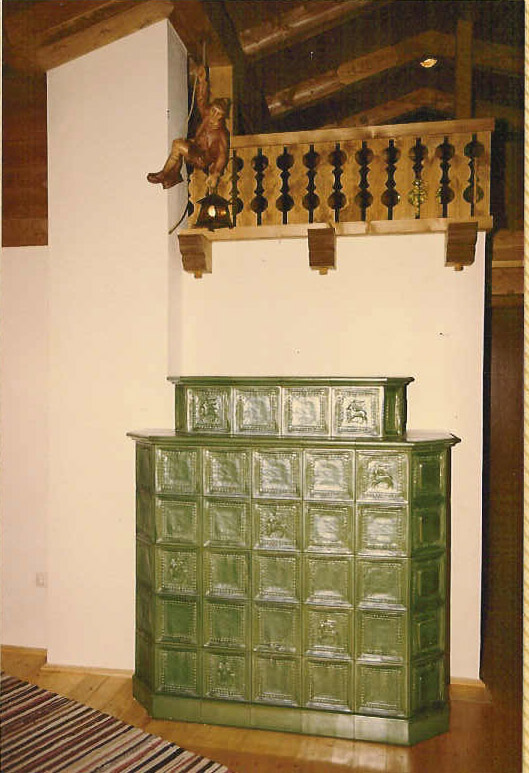

Sounds like just what is done in the Alps with the tile stoves... never goes cold the entire season... one load daily and two when it gets real cold...
It is the only heat I have at the Austrian cabin... the good thing is the large thermal mass makes for even heat over long periods... the bad thing is the large thermal mass means it takes hours before any heat is produced...
Perfect when someone is around... but not so good when you are our all day and then want to "Fire" up the oven...
I guess you could call it outside air as the air comes from the unheated basement where the door to load is... so no wood in house proper...
It would be a dream to have one in Olympia... most have a seating bench but the cabin is small... I have used it when it was 5 below outside and comfortable inside.
