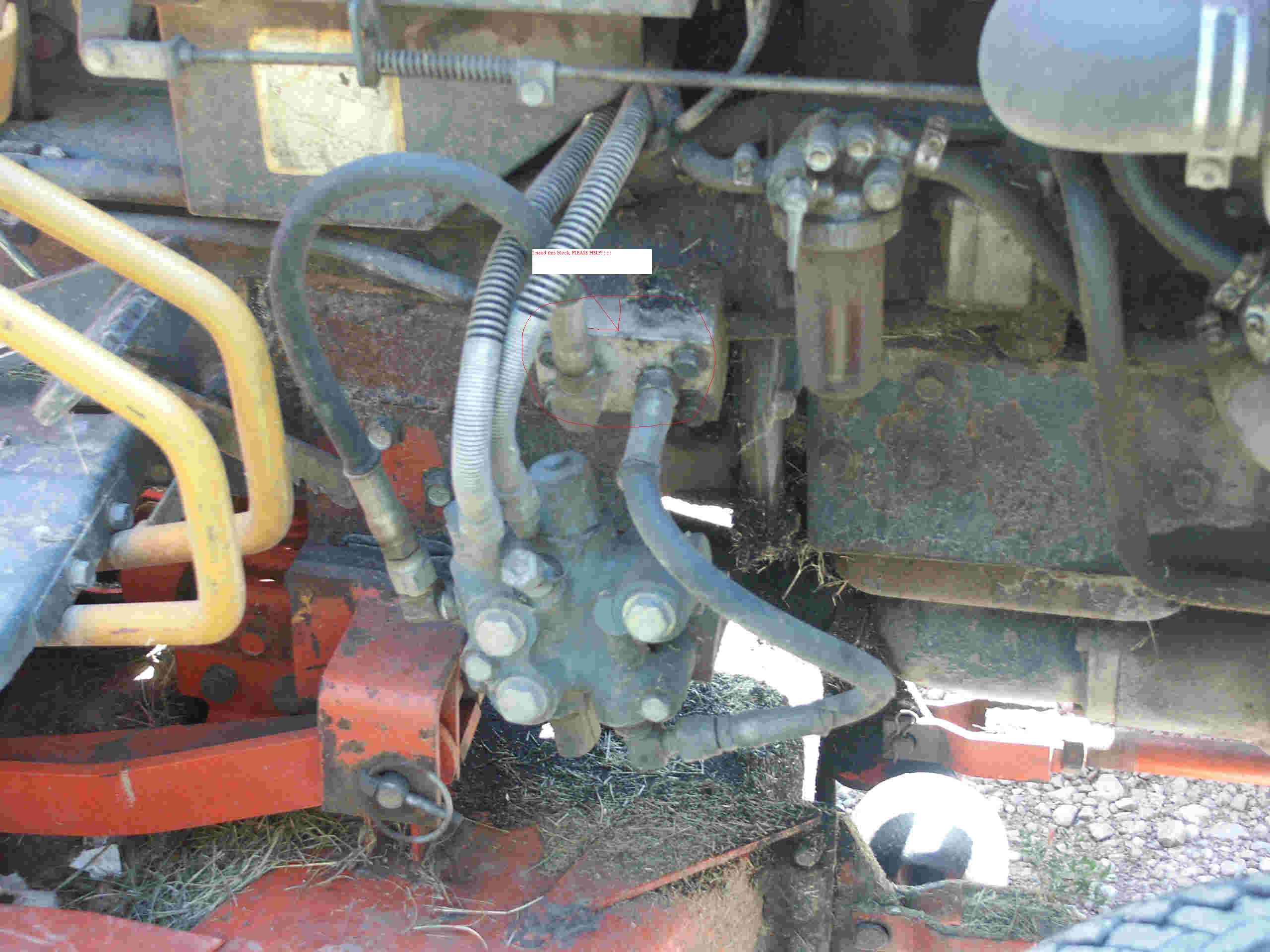

I can't get the hydraulic block I need from Kubota. They ordered one but it was not even close. Anyone have any idea what the part number is for the hydraulic block with the holes already tapped in it.
I have 2 of the regular blocks, I could drill/tap those for the lines easy enough, but plugging between them might be a pain.

To tap in to the hydraulic block you need a new front half for the block on your tractor. It interrupts the oil flow sending it through your hydraulic implement or whatever then back to the other side of the block. I think that part number for a B7100 is 75536-68110. This may or may not still be a good number. It is the new hydraulic block cover used for a front end loader, snow blower, front blade or whatever to supply hydraulics to them. I hope you system works, but you may need a flow divider to separate the hydraulic flow, part to the power steering and the remainder back through the hydraulic block to run your 3 pt. hitch or other hydraulics on your tractor.
This number is what I used, the part I got is WAY too small, it is half the size and only has 2 bolt holes. Any ideas??
I need this part, the tractor is 2 1/2 hours away from here. It is up to my parents place, I brought it up there so my Dad can help me with the conversion. And I wanted an excuse to go spend some time with him. I am going back up next Wednesday to work on it again.

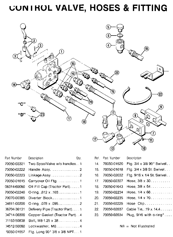

See if this will help. It shows a different part number and shows 4 bolt holes. All my information is older, and I no longer have the information from when I bought mine. This is from a front blade for B6100 through B7200.

Thank You Elsi71, that is EXACTLY the one I need.
I live near Bangor, Maine and had to call a dealer in PA to have them help me find what I needed, they are sending me this one. They said they would look into it and call me back, I figured they would never follow through with it. About 20 minutes later they called and said they found it. Darn thing is $73.00 for it though, kinda sucks but the PS will be worth it.
