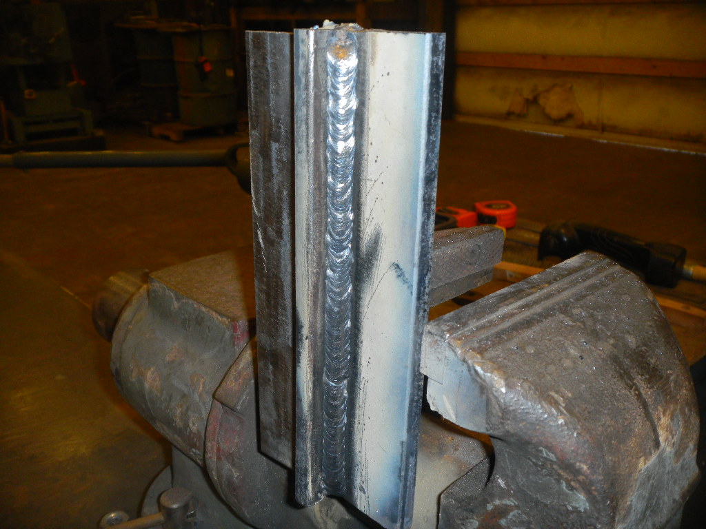

Got all my mowing done before the rains come back this afternoon, maybe it wasn't such a good idea to get rid of the horses after all!:laughing:
Anyway played with the new PA-300 a little this morning.
1/8-inch 7018 vertical up. 126-amps, 1 on the arc force. Really starting to like this machine!:cool2:

I hope my welds look that good someday! I see a couple of tape measurers in the background. They are either Lufkin or HF... since there are two, I am guessing freebee HF. :D

Wow! Very nice, and thanks for posting the settings :):thumbsup: I know where to start with my practice sessions this weekend. :thumbsup: When I get comfortable with verticle up I'll be ready to build something!
Is that 1/4" plate?

No they're Lufkin 25-feet tapes.;)

Is that 1/4" plate?
No that was 3/8-inch flatbar. Also keep in mind that 7018 came right out of the oven. So you may need to go up a few amps if your rods aren't hot.
