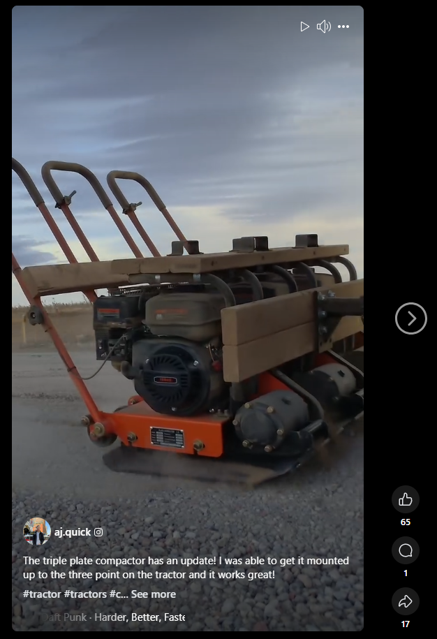

I can't seem to find it right now, but there is a Facebook group called "Homemade Attachments" (or something to that effect) and one of the recent posts was a guy who made a vibratory compactor attachment out of three small plate compactors that are fairly inexpensive compared to these large machines. He pulled the three small plate compactors behind his tractor and it seemed to do a fairly good job of compacting. If I find the post, I'll try to steal a pic and post it here.
The plate compactor's work OK, I've got an older one that I use on my projects. They move at their own pace, which is maybe 1 MPH. I'd think if you pulled one along behind anything, it wouldn't be in contact with the ground long enough to do much of anything. They're relatively light and depend on dwell time in a given area to do much compaction. I even hold mine back to let it dwell longer than it would if it traveled along as designed.
Plate compactors are for small areas, thin lifts and asphalt in small areas where a roller won’t fit or may leave marks due to its size and the contours of the area to be compacted.
I've never told my compactor that, and wouldn't dare as I don't want to chance it working less effectively after it realizes it's not suited to the job at hand :geek:
