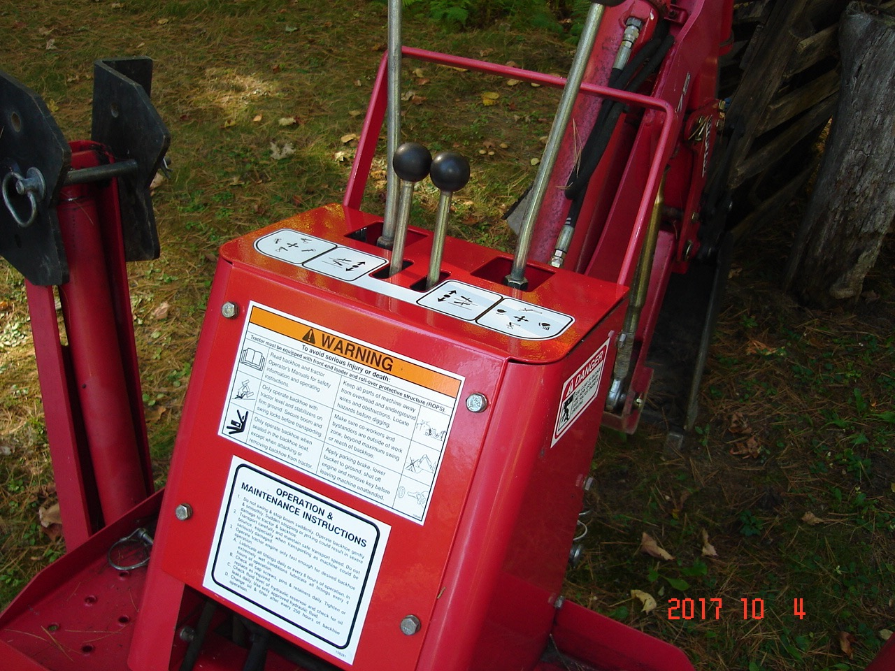

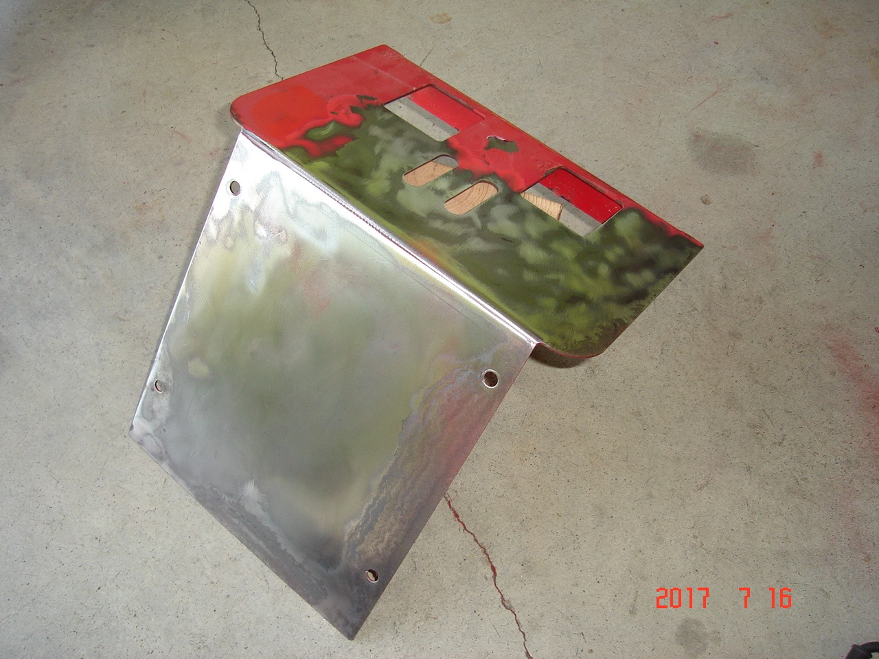

I suspect you're right, Ray. When I started to sand mine off (prior to deciding it was worth it to have it blasted instead), there wasn't much evidence of primer. I'll put a photo below that shows how extensive the rust "creep" had become -- look at the metal discoloration; I was getting more & more large flakes peeling off as time went on, very annoying to an OCD person like me! :)
The other thing I felt was that the relatively sharp edges of the original piece of steel made it so paint on the 90 degree edges was extremely thin-- that's where the problems started. The nice thing about the media blasting was that all the edges became rounded a bit, an improvement, I think.
I thought I'd be able to re-use the old stickers, but it wasn't worth it -- for less than $30 I got a new set from AGCO. The red powder-coat paint isn't a perfect match, but it's close enough for me. Result was I'm happy, and it shouldn't have any paint peeling & rust issues again... at least that one part!
BTW -- you can see this was done in 2017; I got the tractor in Feb of 2008.
View attachment 719943 View attachment 719944 View attachment 719945
Nice job. The cover is different on yours than mine. Mine is just one big opening up there for the joysticks and stabilizer levers. I like yours better.

Manufacturers don't like to spend time doing things like rounding the edges of metal after they cut it. The reason that is important is, sharp edges don't take paint. Try painting the sharp edge of an old knife, and you will see that even after 50 coats, you can still see through it, on the sharp edge. Couple that with a cheap paint, that has no undercoat system, and it's inevitable that it's going to fail like it did for Irving.
