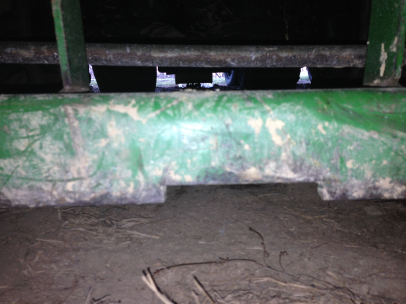

Ill have to look at my set, but I don't think they are removable. They are heavy though. When I adjust them I raise the loader up and point the forks straight down at the ground so all the weight is off the slide. They move in and out much easier that way.
   / Pallet Fork Question #27
They went on, They will come off. How else do you replace worn out forks?
   / Pallet Fork Question #28
Good point but I know I have put them together in the center for digging. Not sure how they come off. Ill look at them and take a pic tonight. They are frontier. Not sure of model #

There's a notch dead center for one fork. Never looked for it or really paid it much attention. Hope I won't need it anytime soon. This set is way stouter than I need but it was a deal I had to take.
