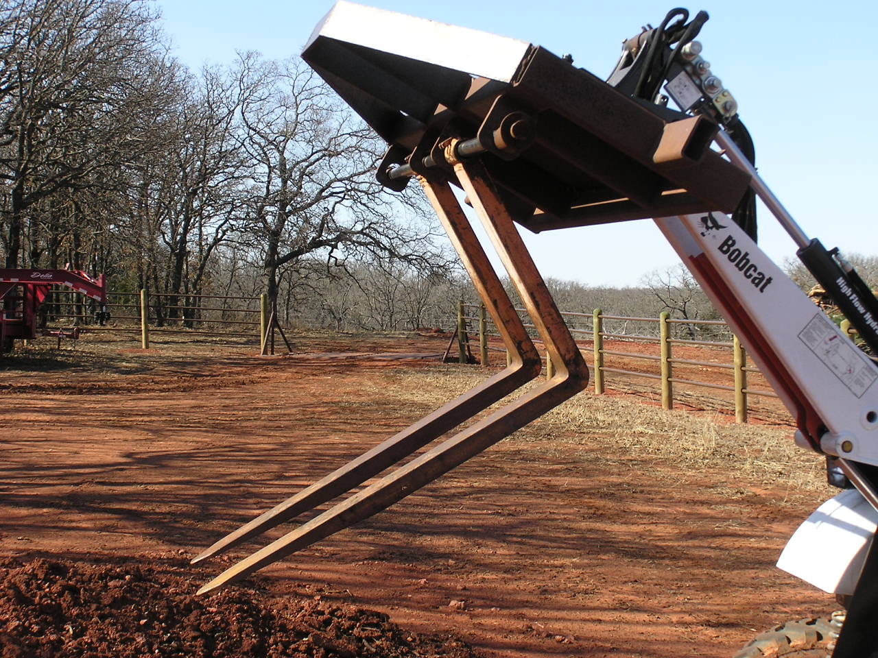

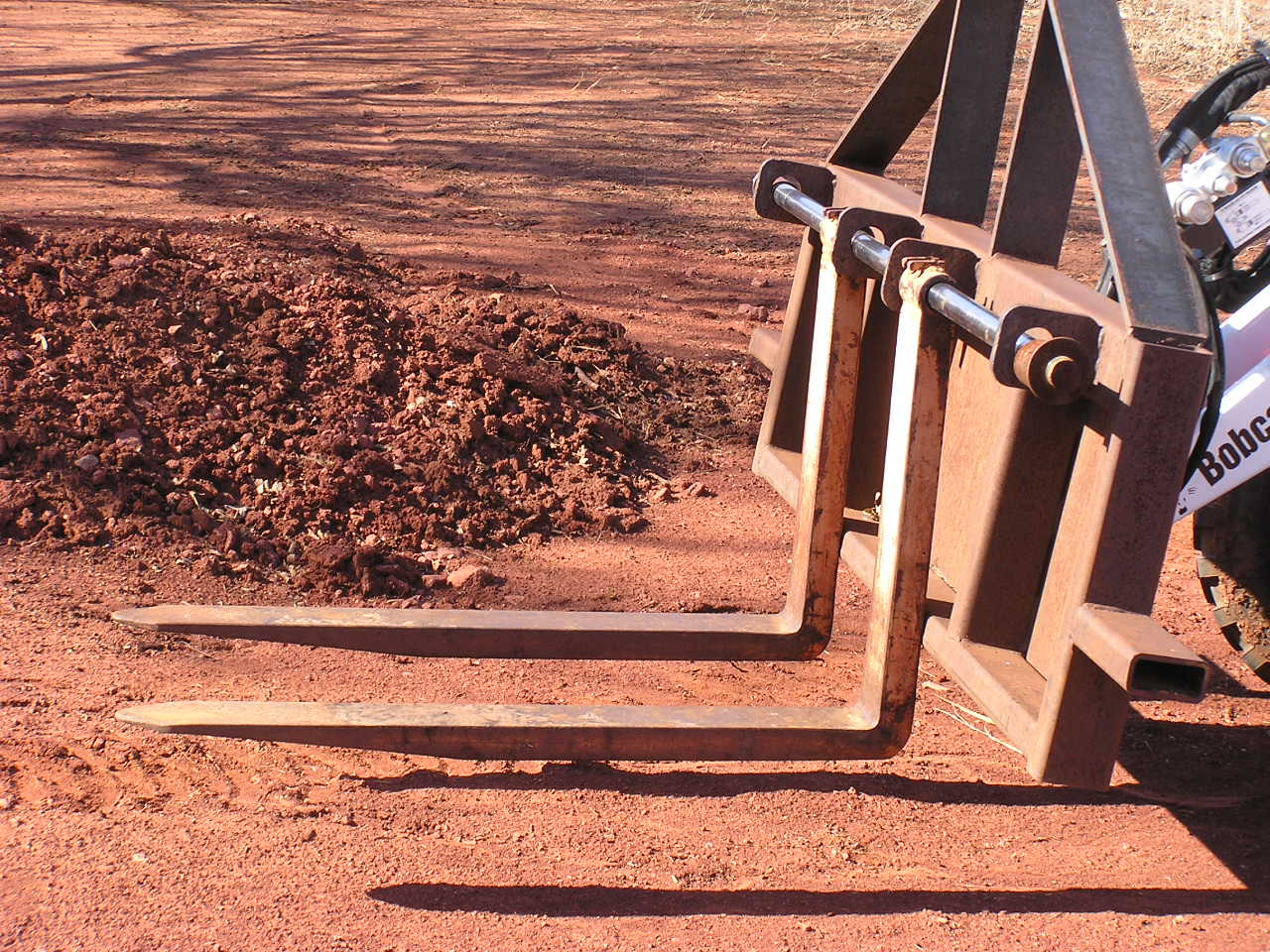

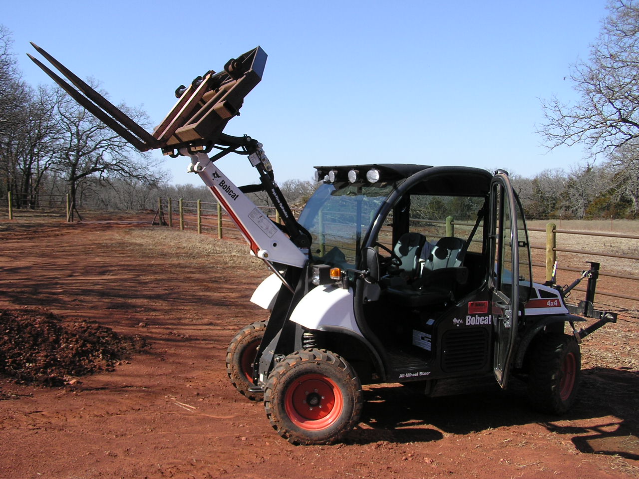

I have the floating forks, they work better on uneven ground for picking up brush.
I put a chain around them at the bend so they can float a little, and still dump.
