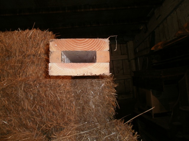

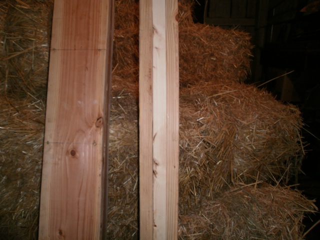

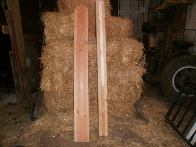

P2080012.jpgP2080013.jpgP2080014.jpgIf you have shorter pallet forks and you want to haul bales, you might try some wooden extensions
