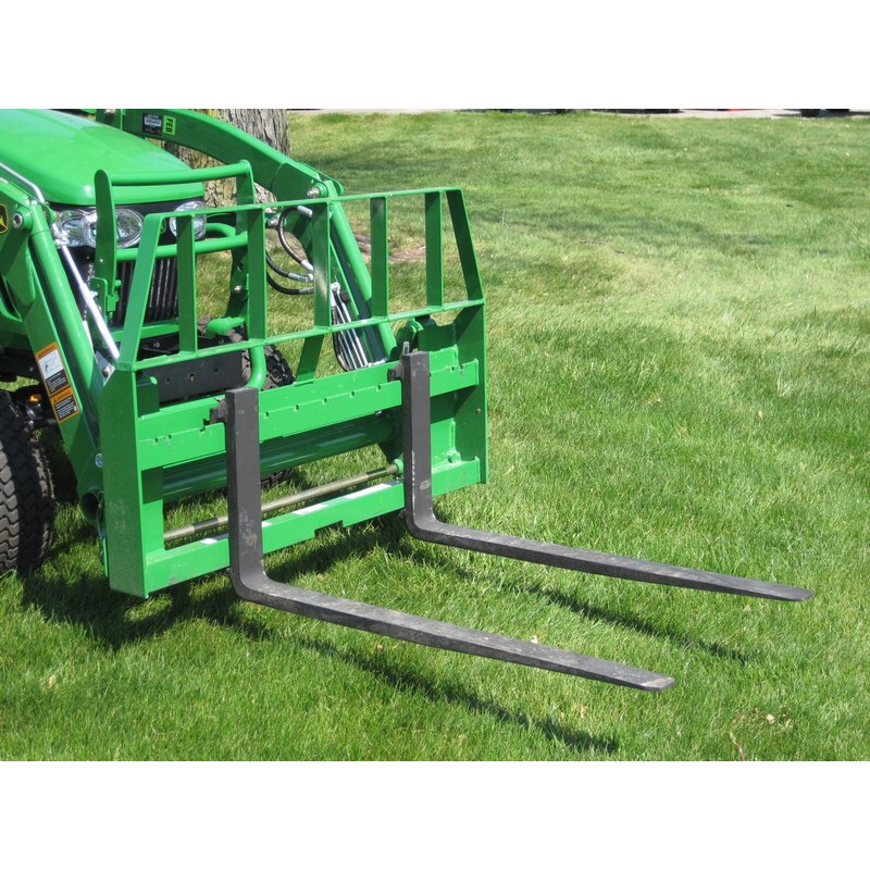

I've got 42" forks. For general use (not just pallets) I wouldn't want them any shorter.
/ Pallet fork suggestions #3
Everyone has their preference but make sure the 36 inch is long enough to pick up the pallets or packages your using. Many pallets in use today are very light and poor construction. Some prefer the shorter forks cause of operating in tight spaces.

That's fine but what about the tilt deal are your built that way or like these?

I believe mine are 42 as well but never measured them, they came with the tractor, very useful tool and a very useful size, idk about 36in though, would be interesting on a loaded pallet.
/ Pallet fork suggestions #6
I agree you should get either the 42 or 48" forks and nothing shorter.
I don't have additional rollback but have not needed any more rollback than I get with the loader curl.
I'm not 100% sure I know what you mean, but I think I do. You're asking if my fork tines are perpendicular to my SSQA plate, right? If so, I'm not sure. They're close, but might have some rollback built in. I'm not sure about your loader, but the LA844 on my MX has a fairly wide range of dunno action. I can tilt the bucket way down or way back. I can't say as I've ever wished for more rollback on my forks, but I can see if they've got any built in. I have a set of Construction Attachment forks, by the way.

Like these, grandpa has the construction forks on his too with the additional roll back built in and you can tilt them suckers waaay back.
http://www.palletforks.com/uapfatt-skidsteer-palletfork-attachment-with-42inch-blades.html

i drove to Memphis last month and bought a set of 48 in forks on sale. great deal and i have been using them.
they are perpendicular to the back plate and could sure use a few more degrees of tilt- but i still love em.

Ordered the 48" set just now thanks for all the quick replies.

These have some extra rollback built in:

I just used my forks to lift a 4x5 round bale off a trailer and drove it to my feeder, I was surprised how well it handled a round bale from under, I guess I don't need a spear after all. I still didn't measure mine but they didn't cover the whole base of the round bale so I would guess 42" forks. I wouldn't have wanted any shorter, I had to have every inch under the bale with a good slant to keep it up there in travel. Worked out good though, accomplished my task.

Bales can be moved with forks, that's for sure, but be careful. A spear pretty much prevents the bale from rolling back over the top of the implement and coming towards the operator. With forks, the only thing preventing this is the operator.
I'm not saying that it's gonna happen to you, but it's happened to many farmers. Here's one example:Kimberton Farmer Recounts Paralyzing Accident, Advocates for Farm Safety
There's a radio story about that farmer also. Point is, a spear is safer. If you use forks, be careful.

I bought a set last January. Dealer stock had 4000# stamped on the side, adjustable, straight blade. Several weeks ago I used them to move 3ea. 24"x 20' corrugated horns (galvanized steel culverts) and place them side by side in a creek to make a crossing. Just drove up and put the forks under one, put my joystick in the lift direction, culvert rolled back to the backbrace and away I went. At the drop zone, I had driven stakes in the ground to limit the forward travel of the horns once I tilted the forks down and let them roll off. Worked just fine.
/ Pallet fork suggestions #16
I bought the 48" forks and from the operators seat I can just see the ends, if I would of bought the 42" forks I would not of been able to see the ends, I'm glad I did not get the roll back cage as it would of blocked my view. Before you purchase, cut two boards one 42" & 48" placed them at the front of the tractor and get in the operators seat and see if you can see the ends, if you can't see them picking up pallets will be hard.

Yep, bales, logs, whatever, you lift it up high, you'd better be paying attention. A false move with the joystick can send stuff heading back your way.
