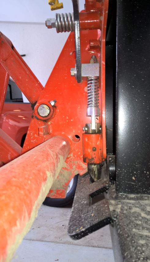

I bought a set of quick attach pallet forks from Titan attachments and sometimes the forks will disconnect from the quick attach. I'll have to open the 2 quick attach release arms and let the forks fall back in then rearm the quick release arms. Does anyone else have this issue and is there a fix for it? This happens whens the forks are under some pressure. Sometimes I will be moving a pallet, go to let it down and pull away and the forks disconnect from the quick attach. I made sure that the quick attach arms and fully engaged when I attach the forks. Not sure why this happens, but my FEL bucket never does this and sometimes it is under allot of pressure depending on what I am doing. It happens allot and is very aggravating.

I'll get some pictures posted later today. The top lip stays in, but the bottom pulls out. Really odd that this would happen.
   / Pallet Forks disconnect from the FEL quick attach #4
When you push the quick attach arms down how far do the spring loaded locking pegs protrude though the bottom slots?

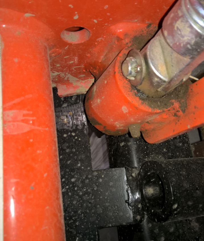

The first pic you can see that the pins don't seem to go down far enough. The second pic shows marks where the pin scrapes the forks when it disconnects. I could weld a piece of metal in there to make the pins catch more like a metal plate to build it up.
Here is a better side shot of where the pin goes in.

I think a shim makes sense. Or you could zip off that bracket, move it up "tight" and re-weld it.
Pretty much B.S. having to do either, but you can do it and move on with life.

No that is not the answer. The pins are correct. The forks are out of spec. A shim welded in will fix this. Some people have got titan to apply a credit. To pay for a repair. Ask for some monetary relief and have the forks repaired or do it your self for the money. We have seen this before on this forum.
   / Pallet Forks disconnect from the FEL quick attach #10
Oh. And do it quickly because it can "spring" your little SSQA torque tube if it gets twisted. Then you have to cut the tube and reweld it. Don't wait to long to fix this.
