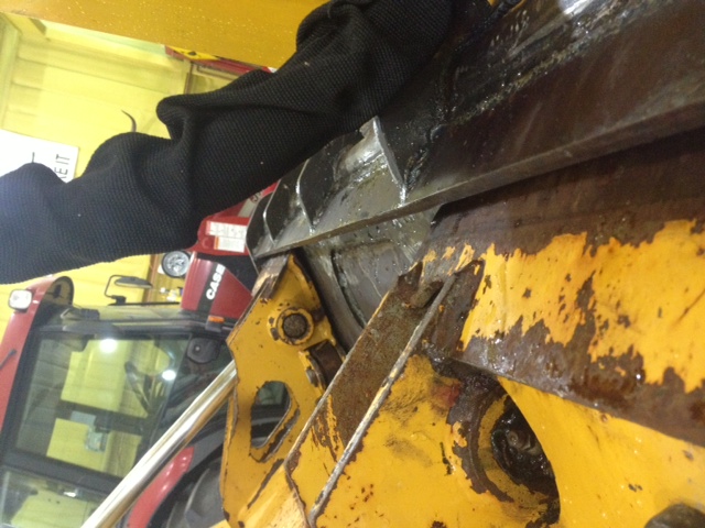

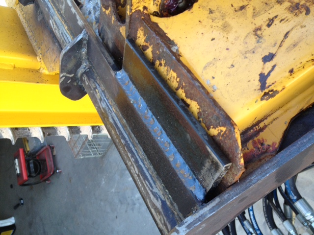

I bought a quick attach plate a few years ago from Skid Steer Solutions and it didn't fit my Deere skid steer properly. The attachment would pop off similar to what you are describing. I welded in a shim made of 3" x 3/8" material and remedied the problem. Attached are before and after pics. Note in the before pic showing the gap I am pushing down on the implement to drive the pins in and show the gap on the top.

Holy cow: that entire bottom plate needs to be raised up 1/4" or the top plate lowered or shimmed down 1/4"
