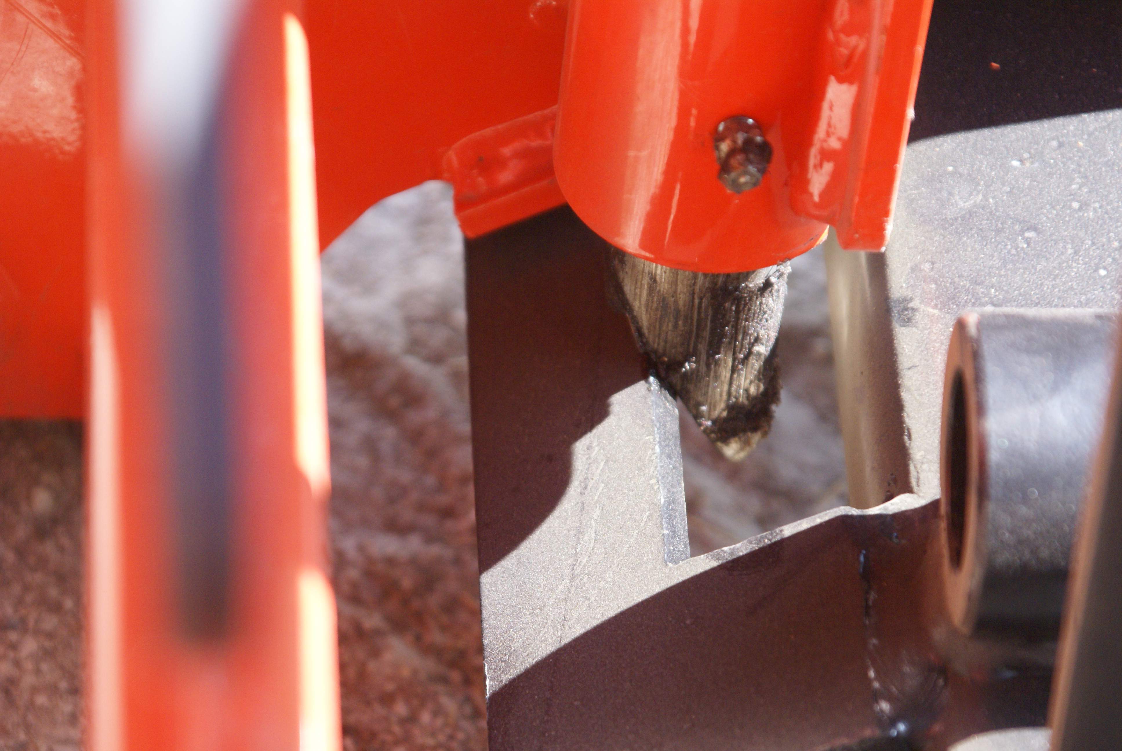

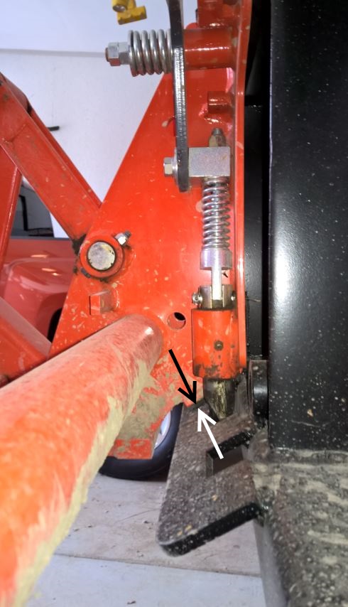

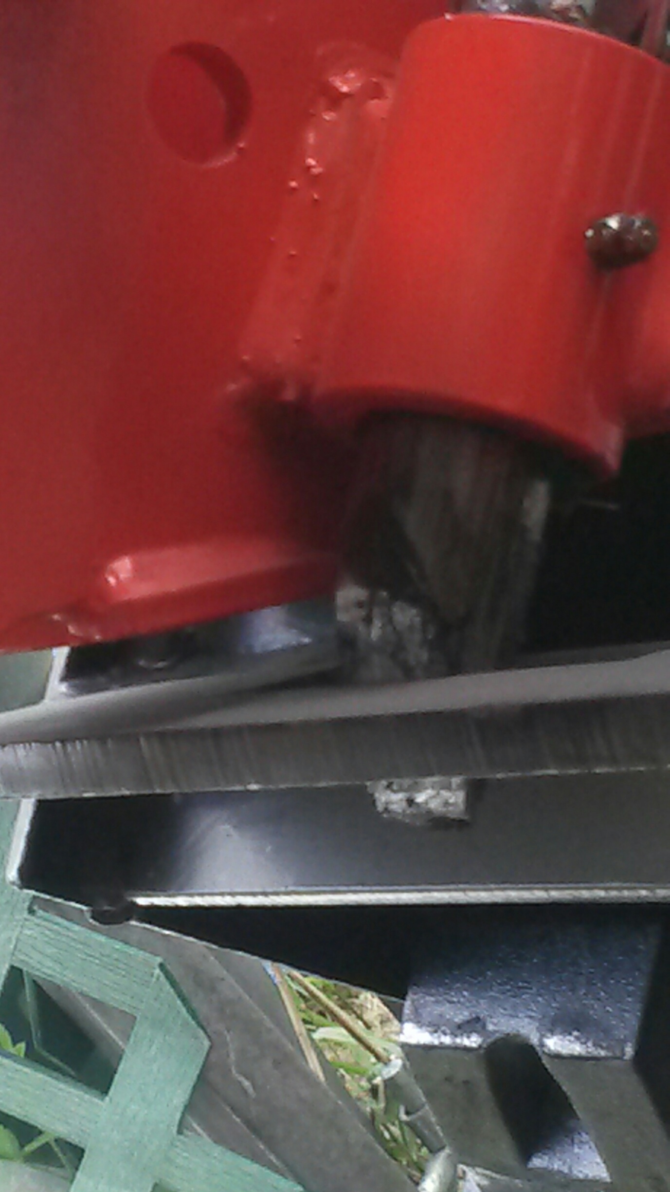

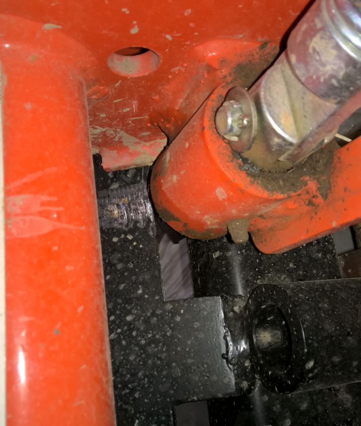

Ask and you shall receive. 20150519_102755_resized.jpg20150519_102818_resized.jpgDSC05075.jpgDSC05077.jpg
   / Pallet Forks disconnect from the FEL quick attach #32
I would be happy with some compensation. I think the shim will do the trick and it is an easy fix for me.
They sent me custom plasma cut out shims that match the bottom cut outs on the attachment. I gather they cut numerous shims at a time. Did you call them today?

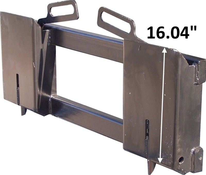

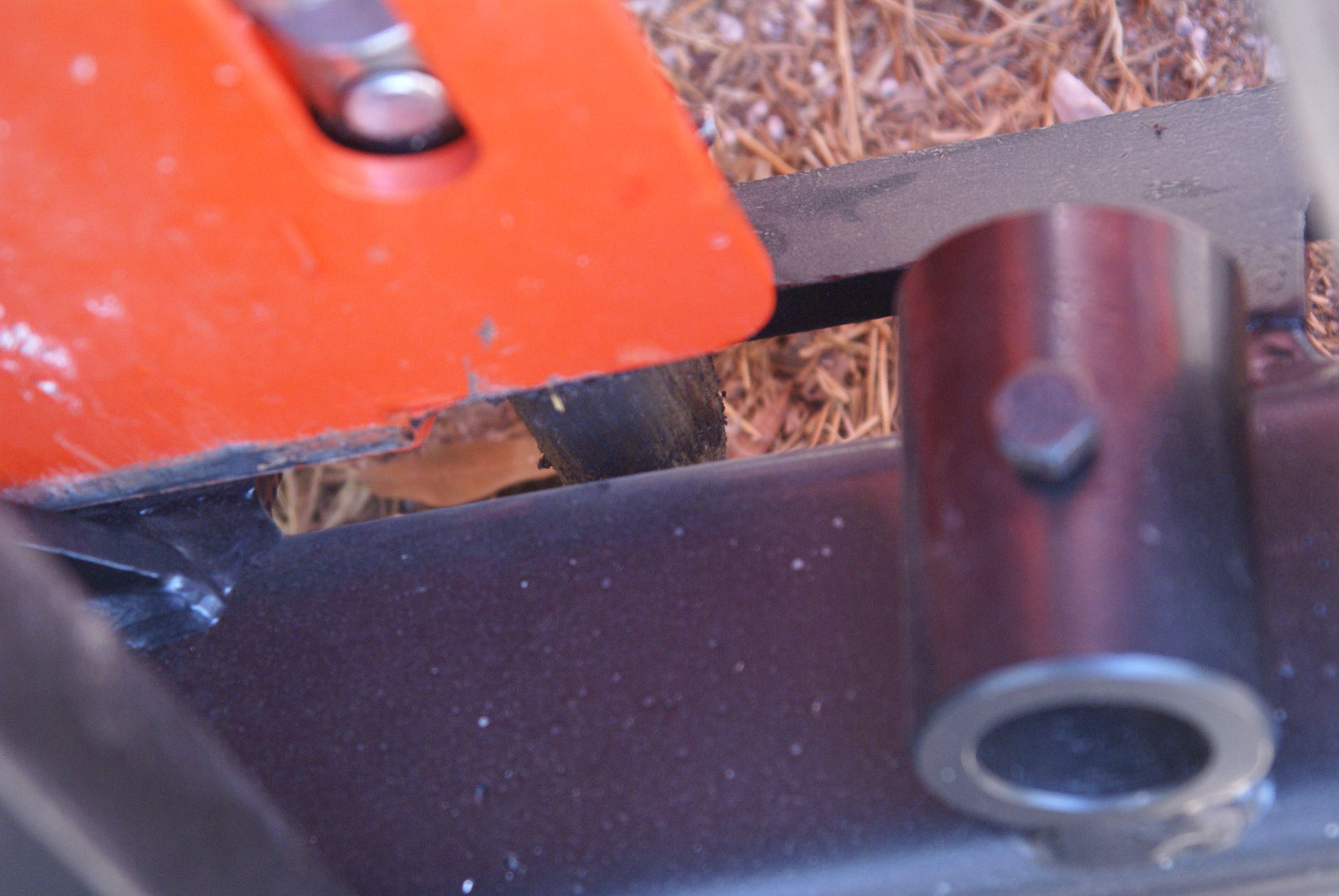

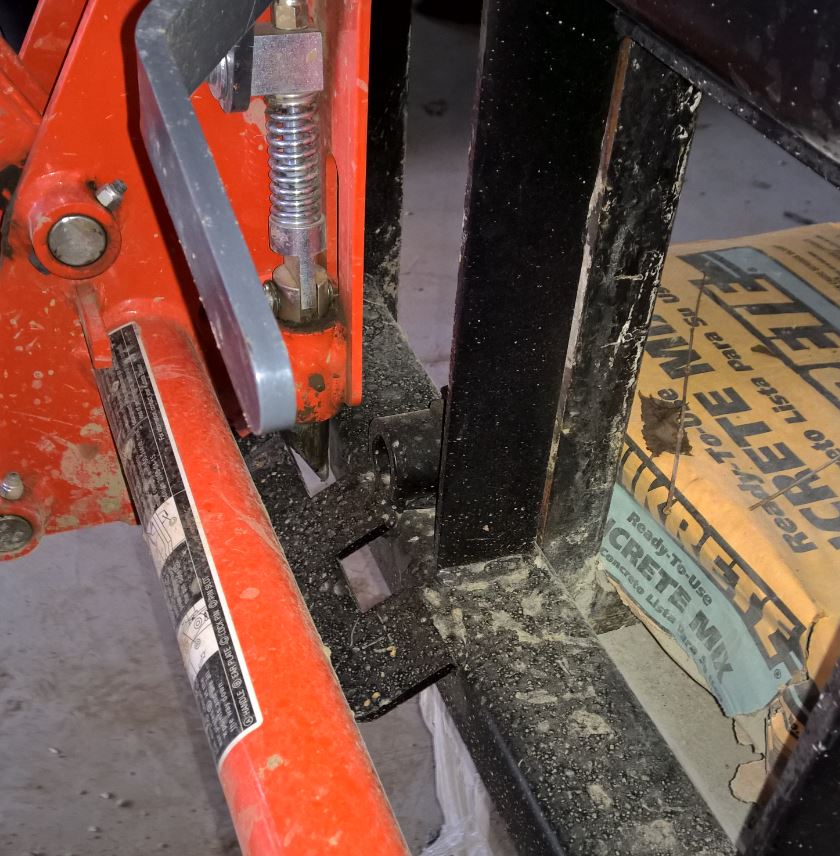

Here is a better side shot of where the pin goes in.
There should not be a gap at the bottom. The plate with the slots for the pins is too low, it should be 16" from the plate at the top of the forks, to fit on the quick attach snug.

Hey guys, definitely agree it should be right the first time. Mistakes in fabrication can happen and we need to do a better job of detecting them before they ship. We have doubled our QC efforts and are working overtime to check every frame and attachment in stock. We apologize for any that got by us, but know this...we will always stand by our product and make it right!
