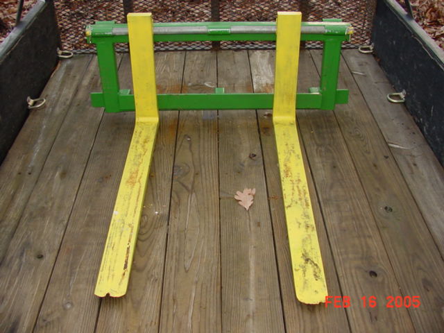

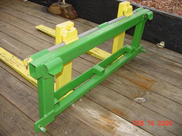

I made mine from used parts from a Cat dealer. The tabs with holes are for mounting my snow plow. The forks stay on the tractor more than the bucket.

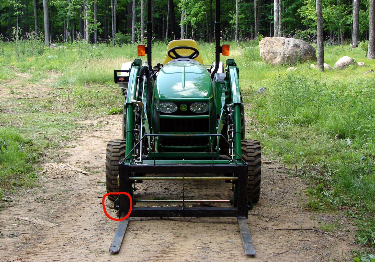

I would be careful with these, as I would assume the bucket holders will stick out past the forks and eventually you will break it.
These forks do not clamp on the front of any bucket. From my experience, those clamp on forks really aren't good cause they might bend your bucket.
The Construction Attachments forks go directly to the quick attach and are made specifically the John Deere quick attach. Sounded like you thought that the hooks could somehow attach to the top of a bucket.

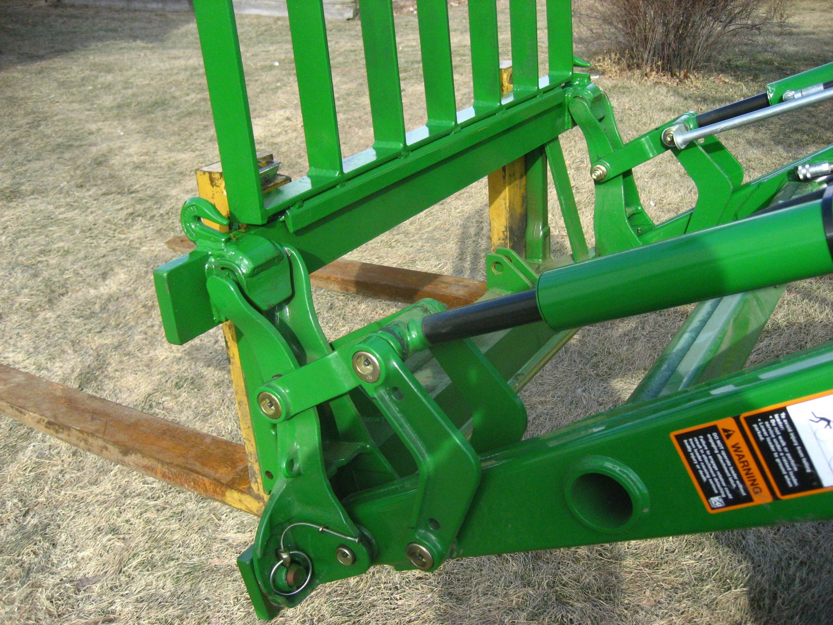

Got a welder? Make your own;)

Somehow we got crossed up. Double Click on the picture and take a look at the red circle. I am sure the bucket holder ear will get waffled sooner or later and that is what turned me away from the Construction Attachments forks.
