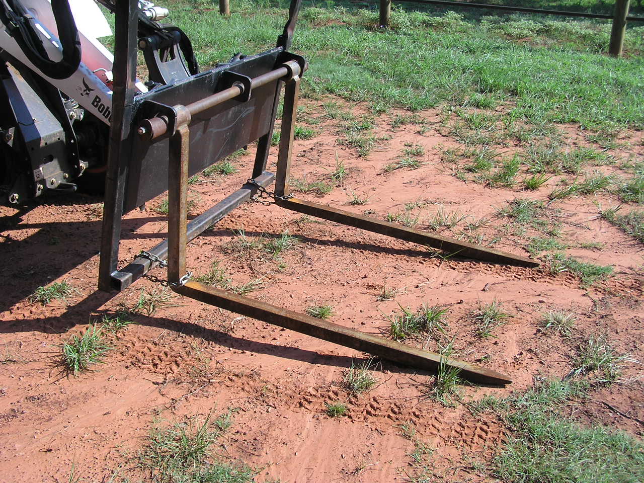

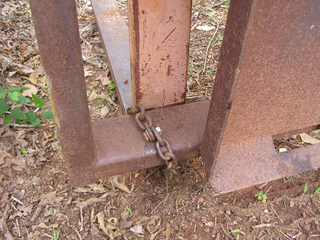

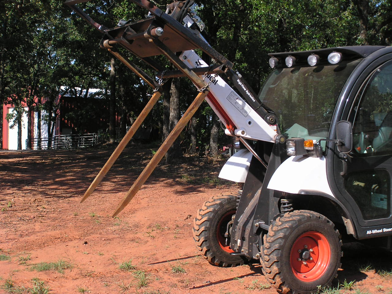

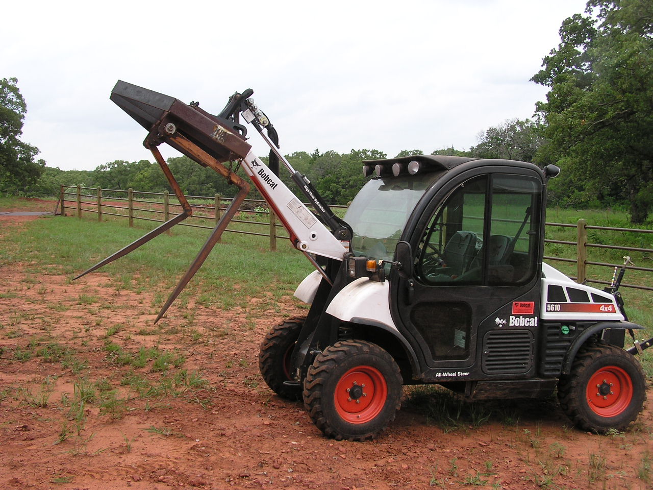

Ted from Everything Attachments says he hates floating forks, I think because you can稚 point them down? I致e used my non-floating forks in ways you shouldn稚 like digging out a rock so I don稚 think I壇 like floating either.
I prefer floating forks. If you need to point them down or apply down pressure, use a short piece of chain.
The 48 inch floating block forks:
The 42 inch heavy duty floating forks with one chained to show the difference:
