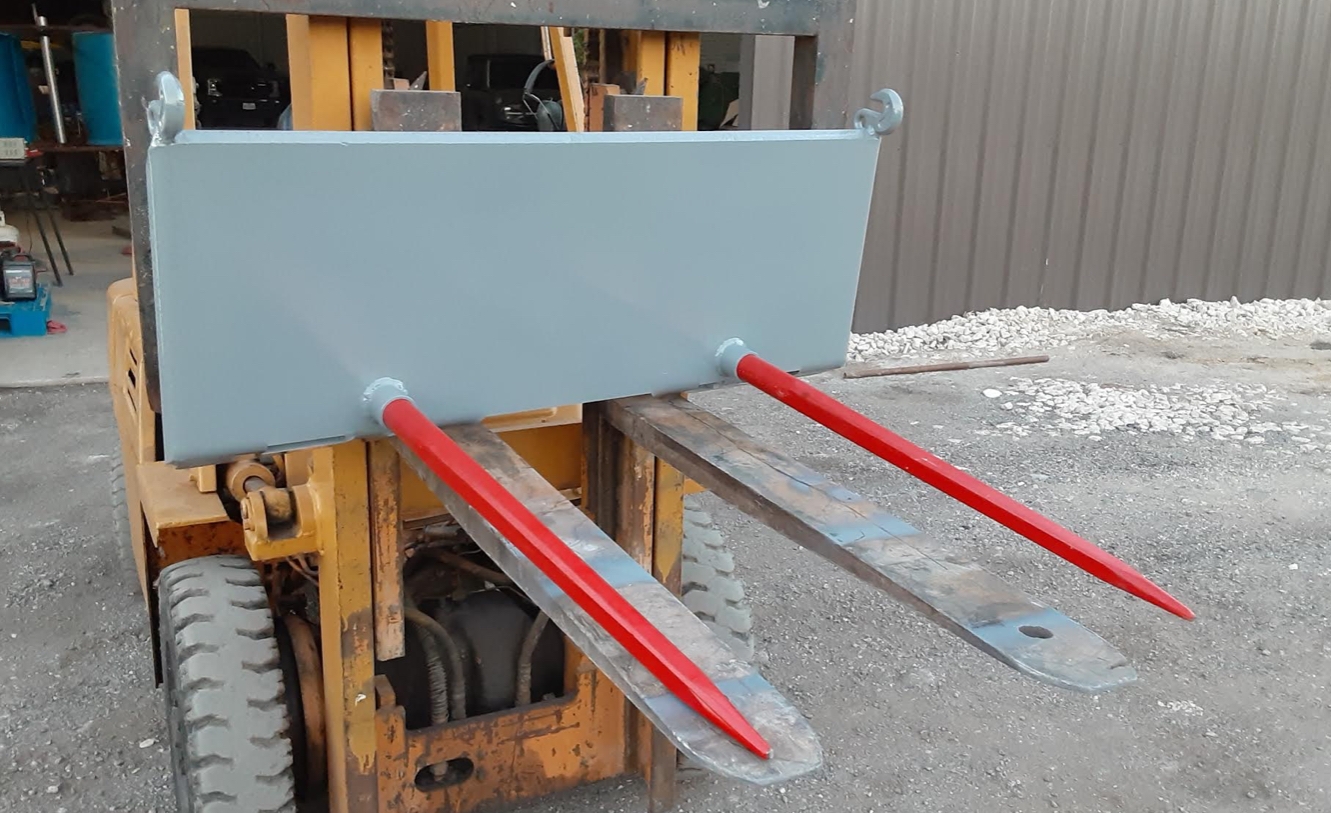

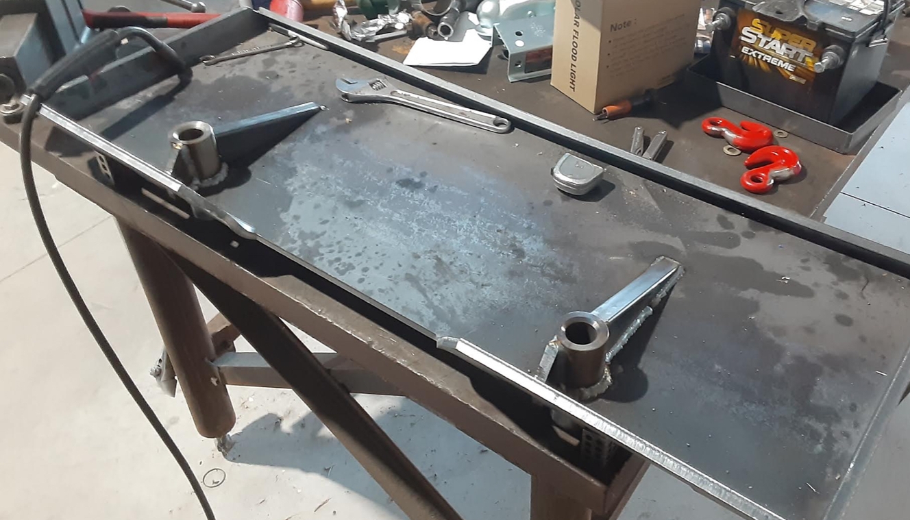

Slow going but it can be done. I’ve had better luck using forks on the flat side. If the forks are removable, I made up a spare fork hangar with a spear cuz I was too cheap to buy the whole thing.

I kind of went the other direction on my last build and put hay spikes in place of the forks, to set round bails into my above ground feeders I have to poke into them higher.
But I can still use them for things I would otherwise pick forks for.

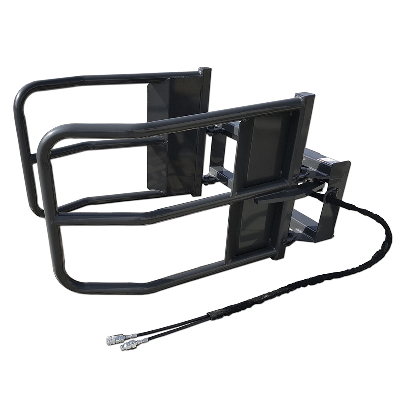

If you end up handling a lot of round bales the squeeze grapples for round bales are the best way to go.

The inherent issue with a 'squeeze' is, you still have to 'upend' the bale to grab it, why I never bought one. I find the SSQA pallet forks to be easier (once you master the technique that is). Besides, I have more than enough 'implements' around now.
   / Pallet forks to move round bales #10
No you don't, a bale laying on it's side you just drive up to it curl your squeeze down and set it down over the bale, squeeze, lift and curl now it's ready to be set on end.
