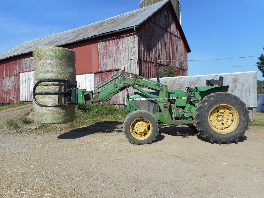

To the OP if he comes back. Had a customer use a pallet fork to move round bales from field to wagon to barn. Thousands of them over the years. He didn't have hills he had HILLS. Was a pain round baling but got good placing bales. Only lost one out of all the years I baled for him.
For the grapple idea. I originally bought one in the early 2000's for only one reason and that was to feed the cattle on pasture. I got so annoyed taking a bale to them, open and close gates. Have them crowd me while trying to remove strings. Pissed me off. Bought the grapple. Take strings off at barn. Grapple. Lose no hay on way to pasture. Open gate, drop bale, leave, close gate before the cattle even knew I was there. Side benefit was stacking 4 high safely.
