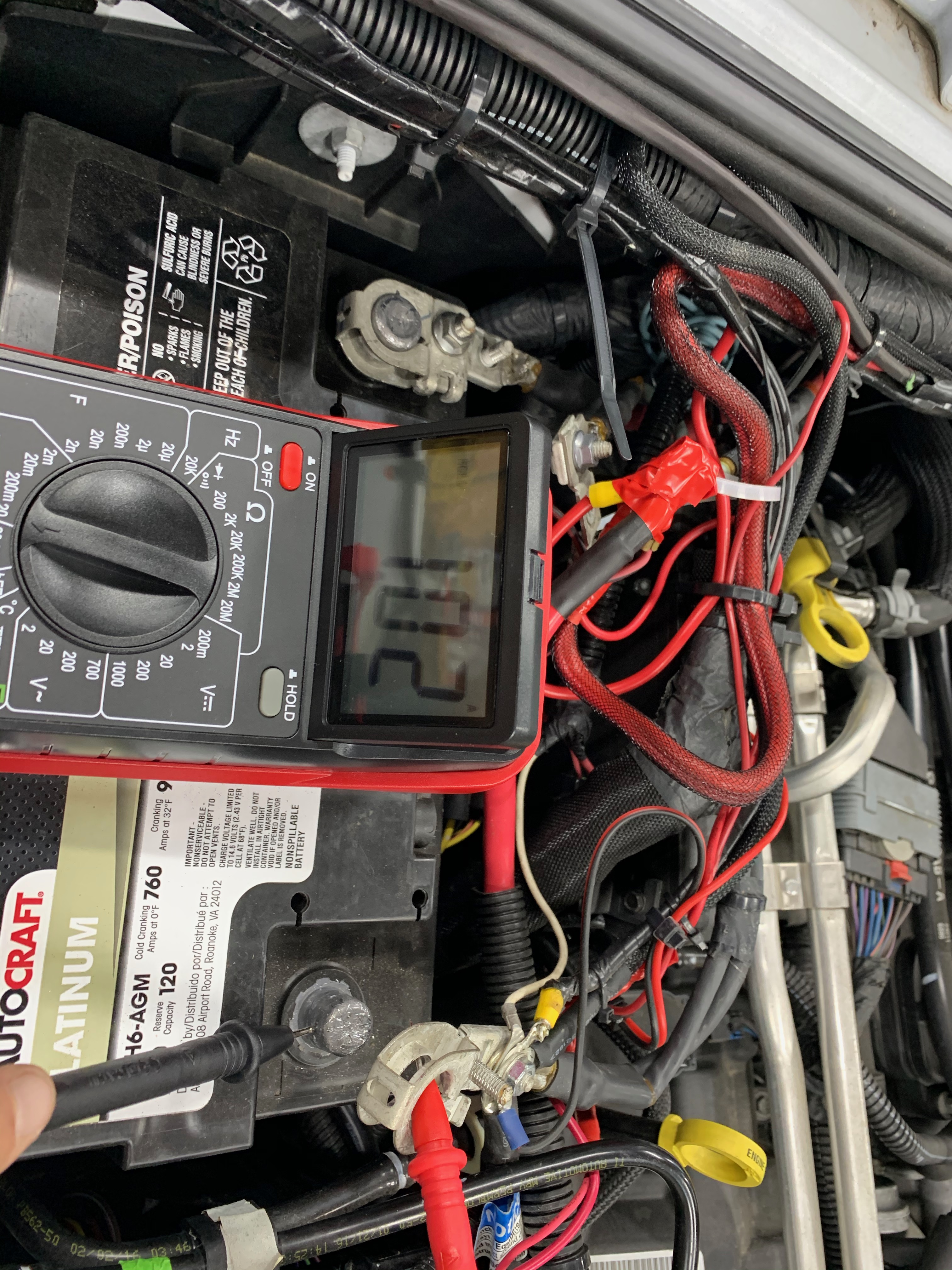

#36
Went and disconnected ALL accessories - and you can see the meter reading - bounces up and down a 1/10 but this is where I am at. Thinking now it is in the Jeeps electrical system for sure and not my add ons. I also disconnected the alternator and no change. Didn't have time to disconnect the starter yet- will do that, clean everything and see if I still have an issue. If so thinking it maybe time to drop it at the dealer. I have. lifetime warranty on the Jeep with a $50 deductible so if something is wrong they can do it and Im not out anything but $50. Plus there is two recalls that need done so get it all knocked out at once.
Anyone have any other ideas Im missing?

   / Parasitic power draw on Jeep JK Wrangler #40
Do you get the same exact VOLTAGE from the disconnected battery cable to the disconnected battery post, as you do across both battery posts?
You should, except for very unique circumstances. Test results will eliminate or confirm circumstances.
