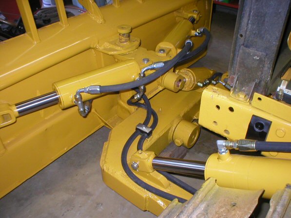

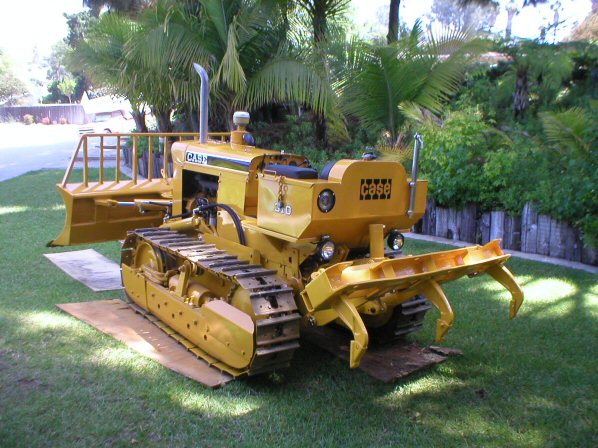

Go to DHH and get the reusable ends and make the hoses yourself. You can easily make them up yourself and they will be perfect. :thumbsup: I replaced every hose on my dozer this way, it worked out great. Forget about doing the press deal, you will just be looking at trouble in the long run without have all the correct stuff, along with spending waaaaaaaay to much money. :eek: But then you may not want to use their stuff because some of it does come from China. :rolleyes:
Just my :2cents:, good luck. ;)

VERY nice job on the Case my friend...boy that was a LOT of work.

Ditto on the Case, paint looks better than new :thumbsup::thumbsup:

Thanks guys, amazing what a little hardener in the paint & some new decals will do. It is my first tractor and it was finally time to replace a few things and spruce it up some. It has been a very good machine for me. ;)

Oh yeah, that's one heck of a dozer!
