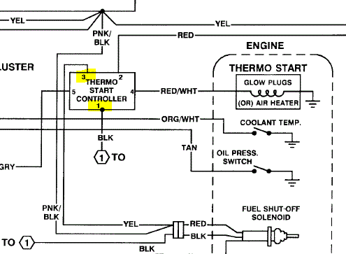

The last tid-bit to take of was the hour meter. The mechanical hour meter on the stock tach quit working, so I had to address that issue before I started using the tractor. I didn't really feel like dropping $107 on a new tach/hour meter, so I bought a small electric hour meter to keep track of the time put on the tractor. It's a small rectrangular (1" x 2") but I'm still undecided on where to mount it so I just did a quickie temporary "mount" for now. I needed to find an easily accessible point to tap into key-on power without tearing deep into the electrical system since I don't know where the hour meter will finally land. I chose the harness for the grid heater control module.
Pin #1 is the black ground wire and pin #3 is the yellow ignition-on wire. Now... where to put the meter. For now, I just taped it the grid heater control module with electrical tape. At least it will log the hours until I decide on a permanent home for it.
