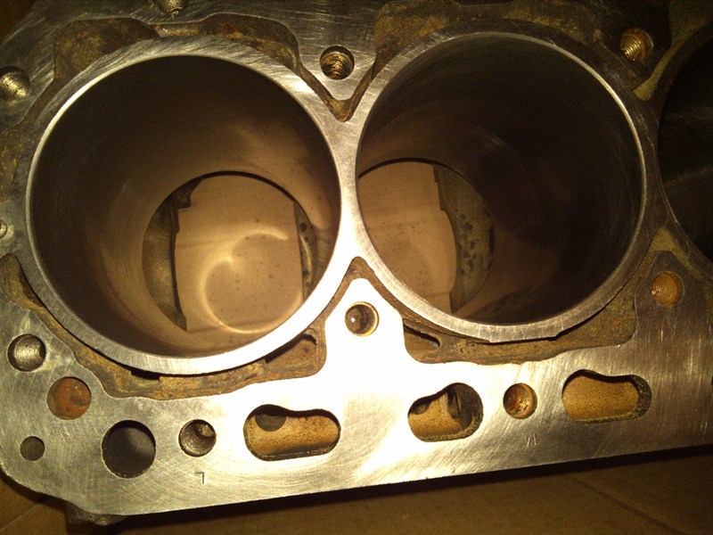

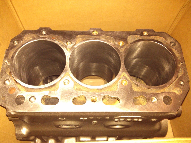

Finally got the block and head back from the machine shop today. If you look really close, you can just barely make out the line between the sleeves and the block. Now I have nice fresh round and straight bores and I can begin the re-assembly.

   / Partial overhaul on Yanmar 3TNE88 #44
Can't wait to see how this rebuilt turns out. A video of your first start-up would be cool. :)
