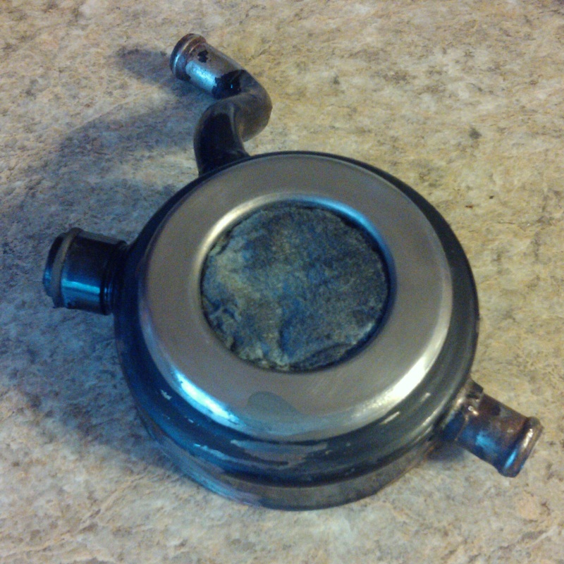

Bolted more parts on... blah, blah, blah. Started to put the oil cooler on and noticed a slight dent on the oil filter sealing surface right inline with where the oil filter gasket rides. That would explain the annoying little oil drip I had from the oil filter area. So I took a break from assembly to address that problem. My first thought was to build up the dented area with some weld, but I was afraid that the heat may un-solder some of the joints in the cooler. I ended up filling the dent with JB Weld and letting it cure.
Once the JB Weld had cured, I chucked the oil cooler up in the lathe to cut down the extra height of the built-up area. The dial indicator showed that the oil filter gasket surface was not true. It had a couple of waves in it... nothing much just a couple thousandths. After cutting down the extra height of the JB Weld, I took another light cut across the entire surface... just enough to true the surface. Then I polished the surface by lapping it with 220 and 400 grit paper on a hunk of marble I use for a lapping surface.

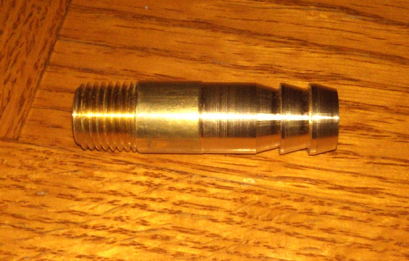

I also needed a 1/4" NPT x 1/2" hose barb fitting and couldn't find one in town. Since I was at the lathe, I went ahead and turned one out of a 1/4" NPT brass nipple. I haven't made up my mind yet, but I may bore out a brass nut and silver-solder it onto the hose barb for wrench flats.
When I test fit the hose on the barb, I dang near couldn't get the hose back off. I'd say it's the perfect size.

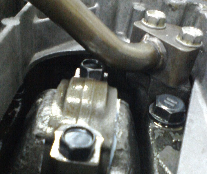

Ran into an interesting glitch last night. Put the crankcase extension, oil pickup and oil pan on and flipped the engine over. After mounting the head, waterpump and valve train, I set the valve lash. When I turned the engine over by hand to adjust the last two valves, I felt something in the rotating assembly lightly hit something else and "rub" past. So, I had to flip the engine back over and pull the oil pan to investigate. Turns out that one of the rod bolts and oil pickup tube were competing to occupy the same space. I replaced the rod bolts for new ones and for some reason, the head on the new bolts are a little bit taller than the old ones.
Put it in your lathe and turn down the ridge. Unless you can only stretch the bolt once. then, turn the motor back over and file on it upside down.
