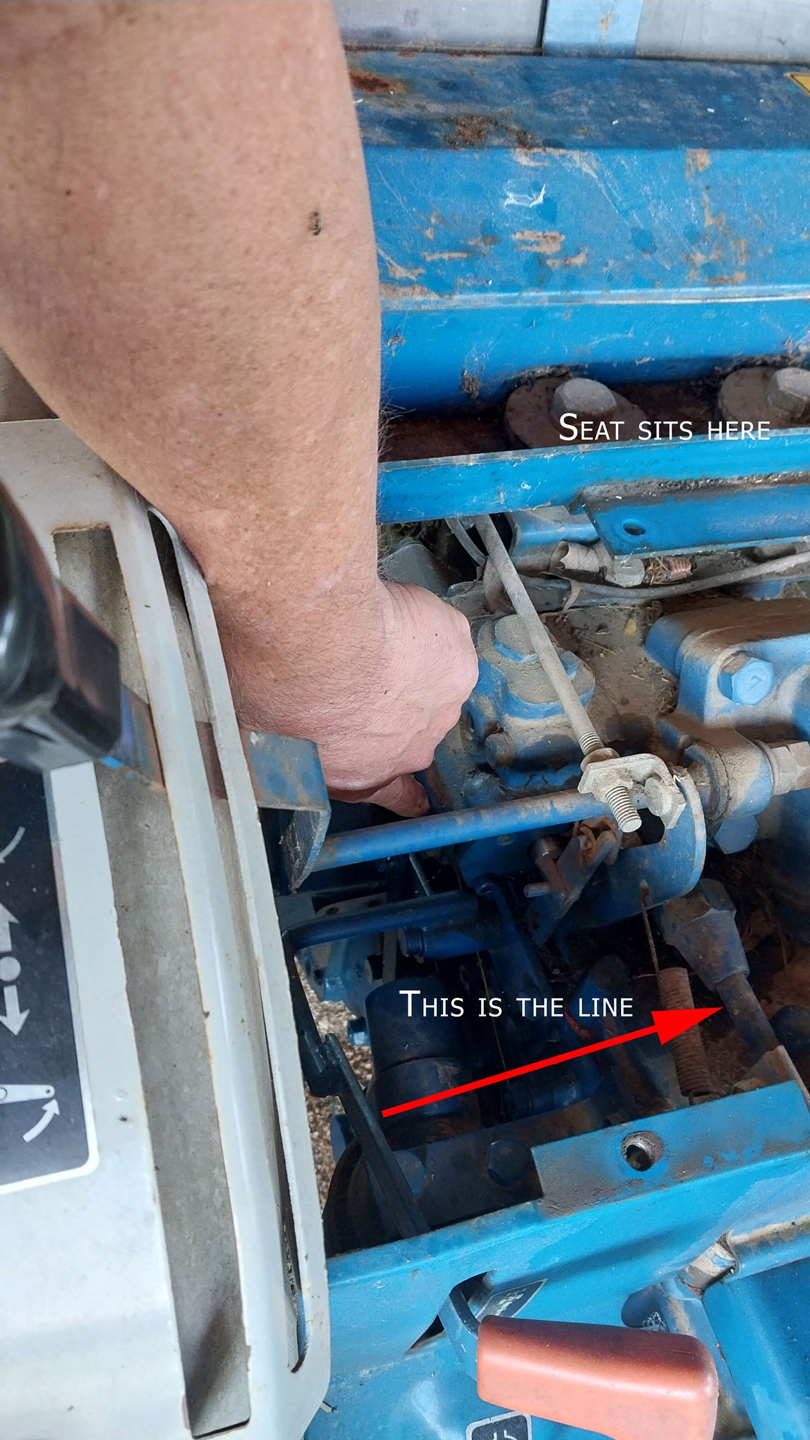

Hello All,
Please accept my thanks in advance.

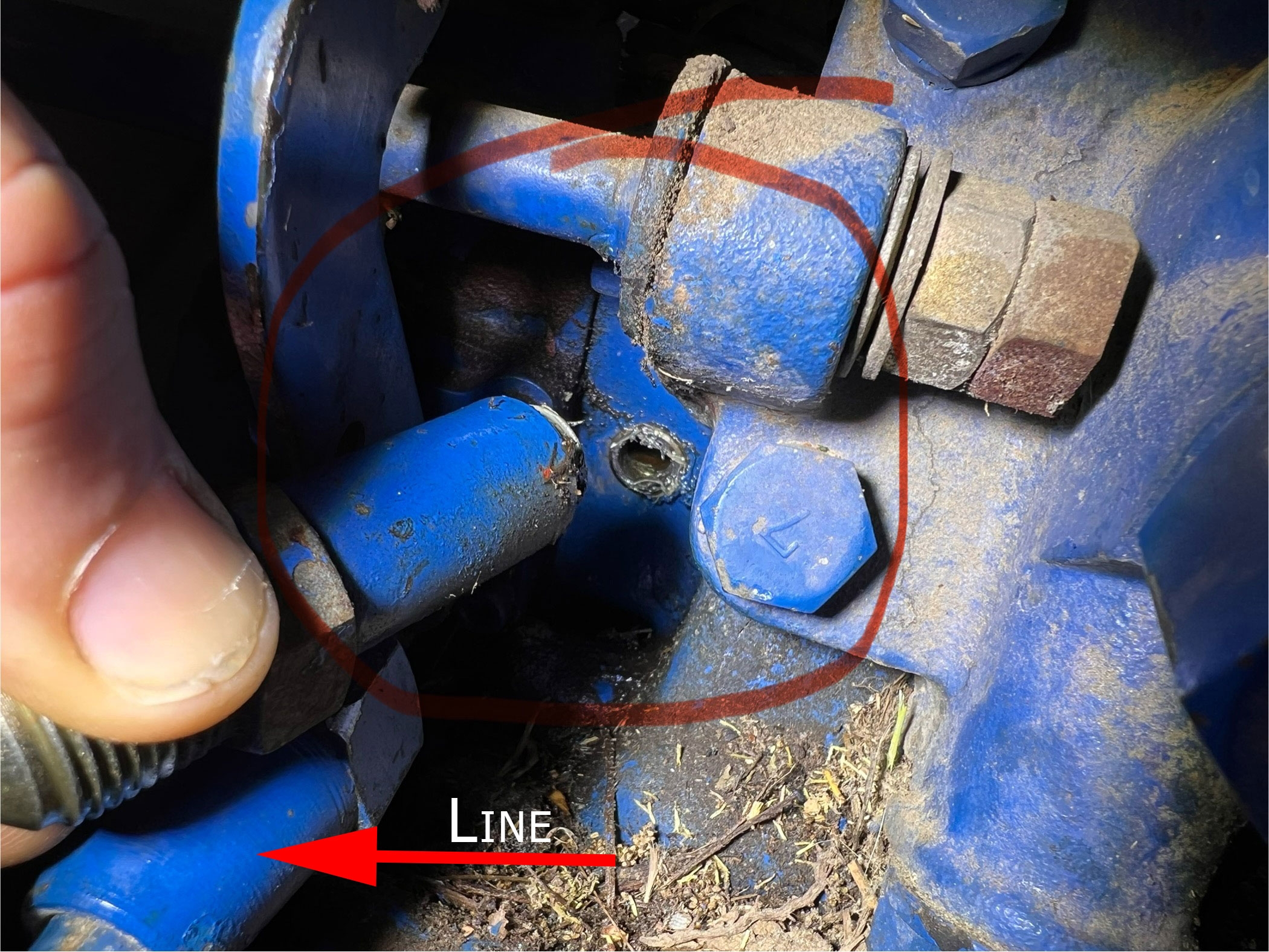

I'm working on a Ford 1220 and found a leak in the hydraulics. It's a "step-down" on what I believe is the return line from the power steering back into the hydraulic compartment under the seat. The tractor was gushing hydraulic fluid and when I tried to loosen this part it broke off, with the broken part still in the hole. Hoping this makes sense. I've attached two photos, one of the line and the other of the broken part removed. There doesn't seem to be a clear hydraulic diagram for the 1220.
Thanks again!
d.

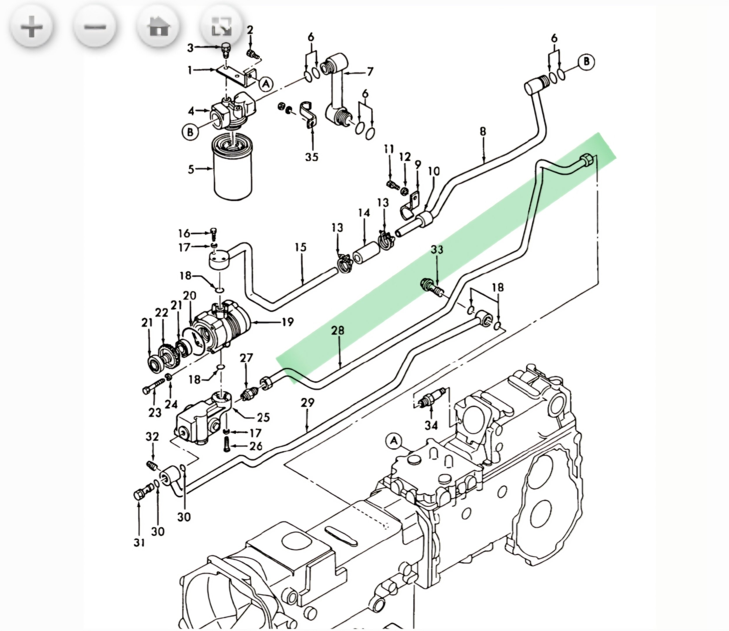

I believe it is the pressure line to the 3pt top cover, #28:
SBA340707320 TUBE, RIGID

Number 34! That's it!!

Thanks Tractortech, part #34 is what broke. Do you have a part reference number for that? THANK YOU!!

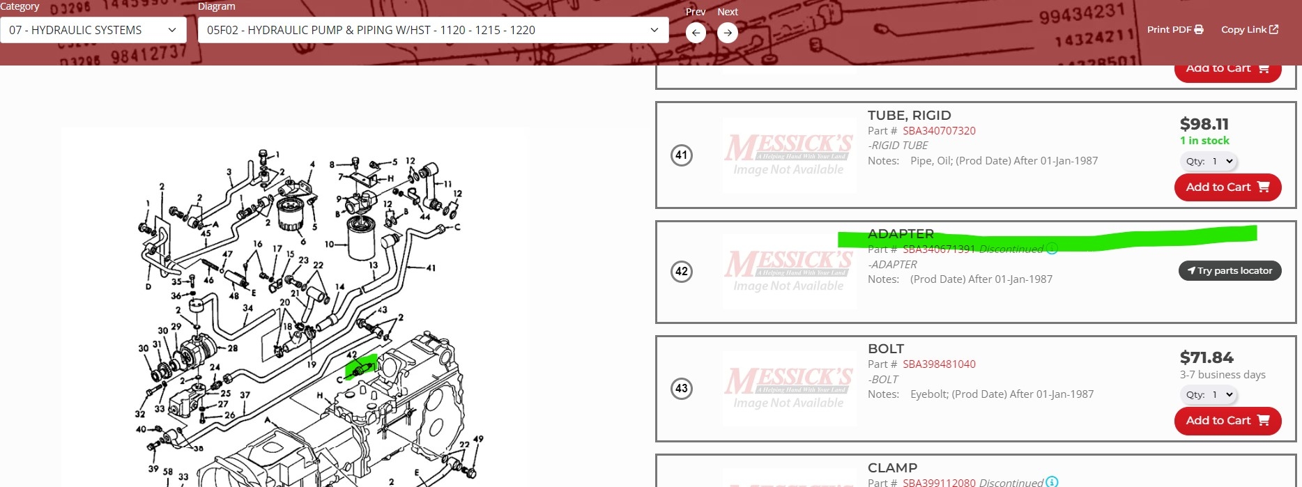

Got the reference numbers. it says discontinued. Wondering if I can bridge the gap with two separate pieces.
   / Parts identification assist, please, for a 1988 Ford 1220 Hydraulic line #7
#42, an adapter, PN: SBA340671391 in the 1220 picture above is what broke.
In the TC21 diagram, that is referenced as #34 and is PN: SBA340673250. It is still available.
I don't know why the part numbers are different as the one in the 1220 reference says it fits 1120,1215, 1220, TC18, TC21 and TC21D, while the one in the TC21 reference fits the those and many newer models. Parts book needs an update.
