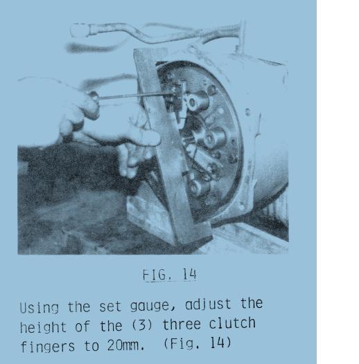

Yeah I wish I was able to get the clutch from Jack as it sounds like a better modern style pressure plate but it went months without getting anything and he stopped responding to my emails and calls. I live about 3 hours away and drove down to see him and he couldn't give me the parts as he didnt have them and said he would send me a check for a refund but in stead we bartered and I got a set of wide flotation tires instead. So Im not out my money at least.
Unfortunately Im still struggling to get my tractors clutch to work. It appears there is very little room for error and with the adjustment tool I made and what I set the fingers to and the fact that I filed down the throwout bearing surface where a groove was from the damaged prior pressure plate the clutch would not dis-engage the engine.
IM waiting for a new throwout bearing center and im re-adjusting the fingers a few mm taller and hoping that makes the difference.

   / Pasquali 988 Clutch issue #24
Phil,
This is from my manual...hope it is clear enough...had to use a screen capture to get it. It looks like the 20mm is the difference in height between the bell housing and the fingers.
If the tool looks like a large letter E the 20mmm seems to be the difference between the two end legs and the middle leg. Honestly, I am guessing at this...
#25
Hi Joe thanks for the info, that picture you have is clearer than what I was looking at in the manual I have.
From what Tom at Italiantractors.com is saying the 20mm measurement is between the tip of the fingers and the surface of the pressure plate. He said to ignore the E shape of the tool that the shape doesn't mean anything. Looking at it I think the shape allows for holding the tool in place and spinning the flywheel without the nut that holds the finger down hitting the tool.
With the tool I made I cannot spin the motor I have to lift and move the tool to adjust each finger.
I expect to get the new centre by Tuesday and should be installing it on Wednesday so Ill have an update then.
~ Phil
   / Pasquali 988 Clutch issue #26
Phil,
Measuring from the pressure plate does make more sense. When I had mine apart I did not adjust it and lucked out that all was ok.
