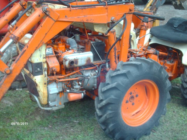

I bought my first 997 in 2007 and my second this summer (2011).
I have purchased parts from Tom Brach that were ordered from Italy. The experience was exactly what it was supposed to be, honest and straight forward with exceptional communication.
I have found from my own experience what Tom has said in the preceding posts to be exactly the truth.
I will order any and all of my Pasquali Tractor parts from him in the future.
What a relief after all these years to find a reliable / honest Pasquali parts dealer.
Joe
PS- Yes, Ray S. that is the machine you sold to me...getting a lot of work done with it.
