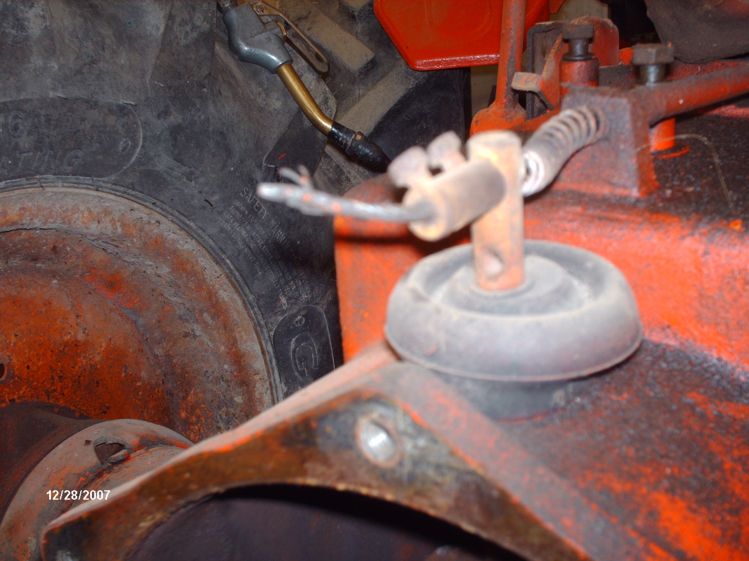

So, taking a closer look at things, the clutch arm sticking out of the transmission where the clutch cable connects looks modified. My thought is if the cable is mounted to low on the arm it will not move the arm enough to move the throwout bearing enough to dis-engage the clutch.
Here is a picture of the arm on the tranny. Notice there is TWO cables on it. The top one goes to the other side of the transmission and I think activates a interlock so you can only shift it when the clutch is pushed. The lower cable is the clutch cable. Notice it is connected to a bolt and its hard to see but the front surface of it looks welded or something. I'm wondering if the cable is supposed to be mounted higher up so it would have more of a swing.
Does anyone have a 988 that can compare what their arm looks like with the clutch cable attached?

Phil,
I'm @ 14127...the heart of snow country because of lake effects...
I take it the manuals you have are the same as the ones available from the French site?
I took a look at one for a 988.30 (a lot more machine than a 997 in every respect) and it looks like the clutch adjustment tool registers from the bell housing in this sketch (not a photo) also.
You could try switching the cables to see if you get enough disengagement ...at least it would eliminate one more variable.

Hi Joe yes I am looking at the manual from that site and I also have a different one that has photos in it showing the process to change the clutch. My setup the flywheel sticks out a lot further than in the manual.
Yes the clutch adjustment tool rests on the engine flange, I think this is to allow spinning the flywheel while the tool is in place to check the finger height easier.
I cant just swap the cables because the second cable terminates on the engine and is in perfect height/alignment with the top of the level.
But the shaft through the top of the level that this second cable connects to has a second hole in it which the clutch cable could be connected onto, right now it has a cotter pin in it.
I agree I think Ill try this as at this point I have no other options other than to just tighten the cable up enough so it dis engages the engine but doing this I think will cause it to press the throw out bearing into the fingers all the time and cause the same failure I have already had.

Hi all, an update on my clutch issues. Tom at ItalianTractors.com has a 988.30 like mine and he checked and the clutch arm has two cables on it and they are in the same locations. When he tested the clutch it just barely dis-engages the engine with it fully depressed. He is thinking/wondering if the arms that push the throw out bearing into the pressure plate fingers are worn down or the carrier the throw out bearing is held in.
Any thoughts on that? Sound plausible?
Im thinking of trying to find a way to connect the cable to the top position on the arm so it gets more throw/movement which I think will solve my issue. Hoping to have time this weekend to attempt it.

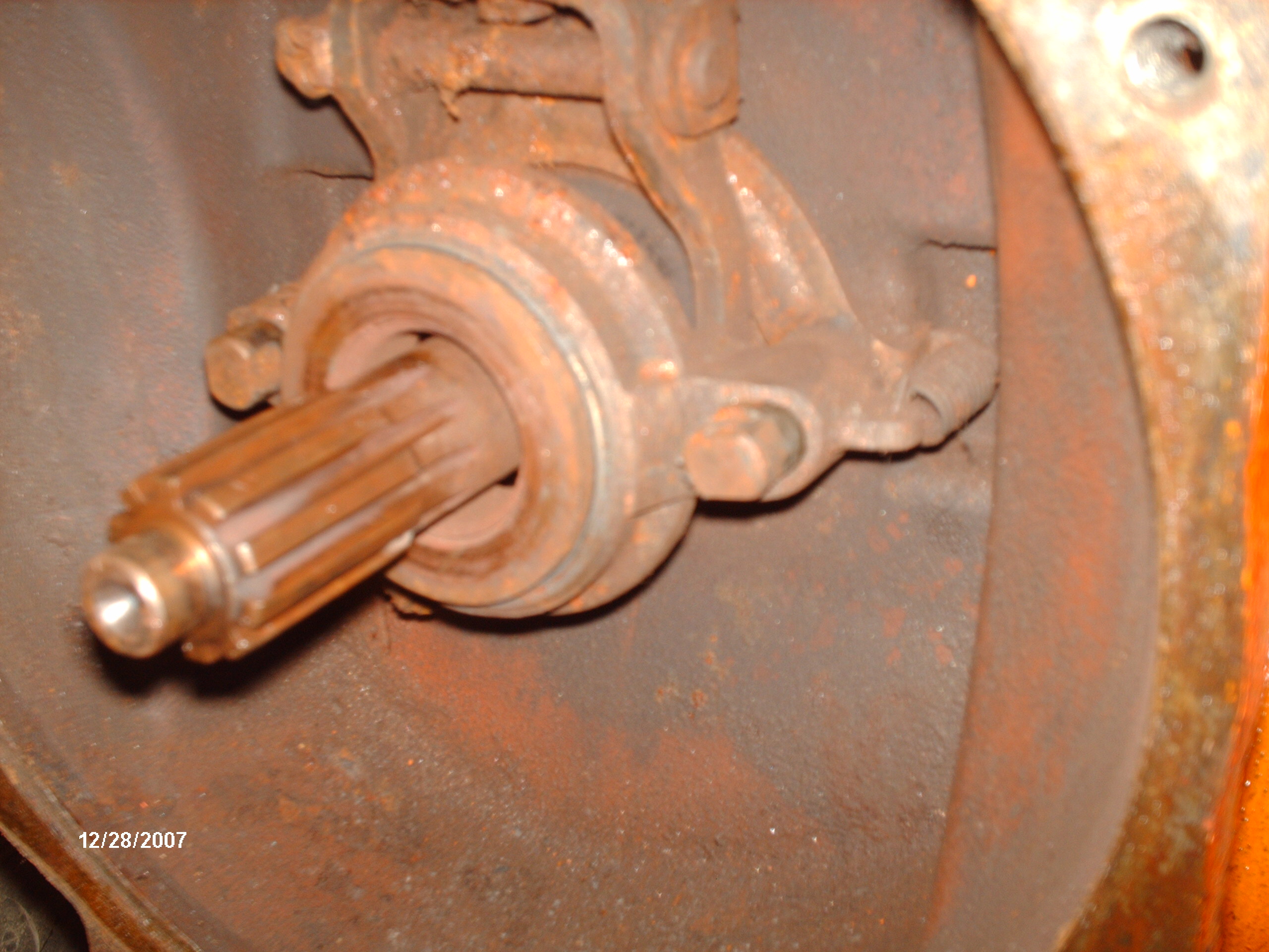

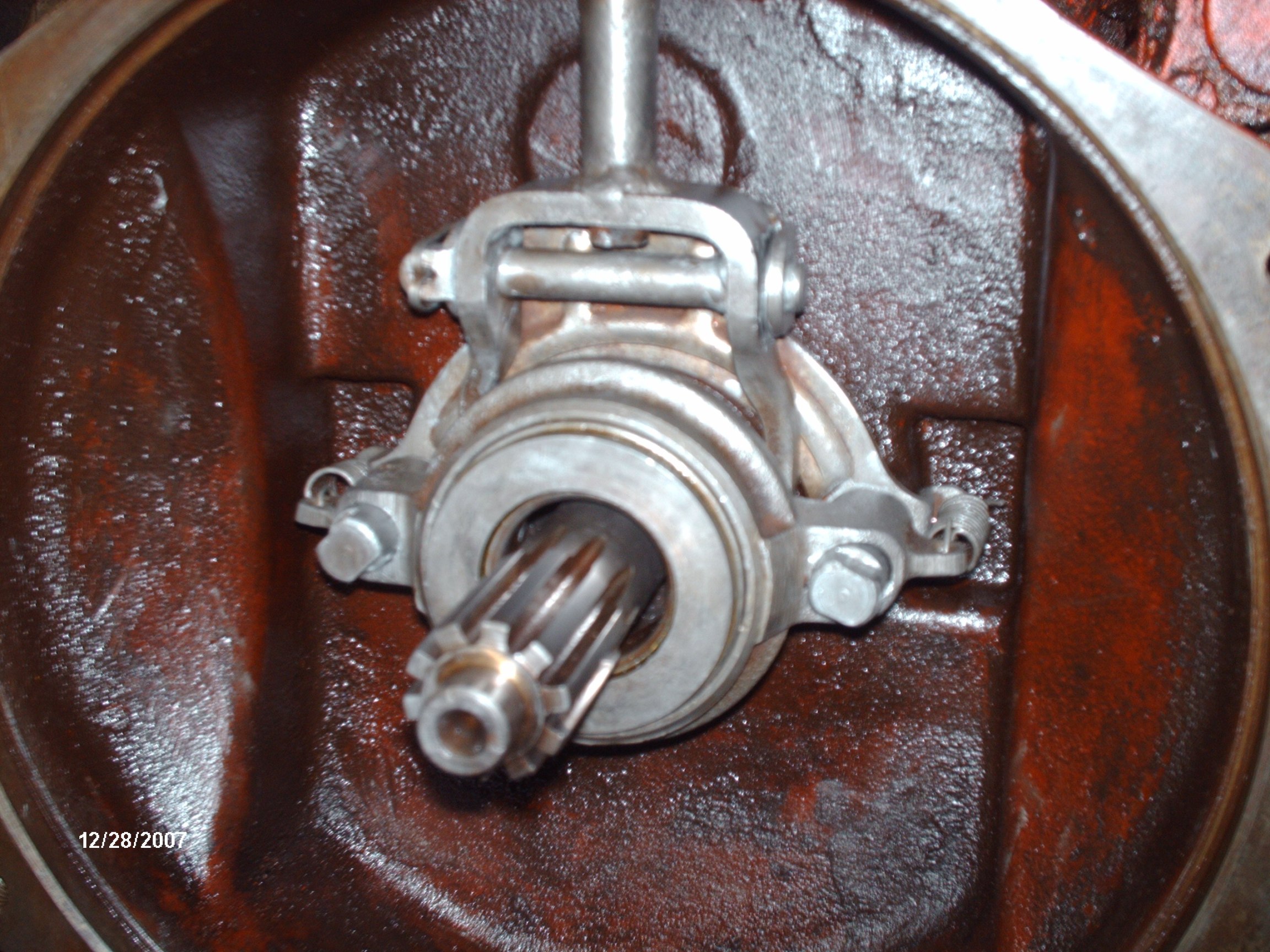

So with no luck I pulled the motor again and made some measurements. Still with the clutch cable connected and adjusted to where it should be (actually its a bit too tight) I measured the distance from the throw out bearing to the bell housing surface. Peddle not pressed the distance is 3 1/4" and with the peddle pushed in the distance was 2 11/16 So a total distance of movement of 9/16" of an inch.
Measuring the tips of the fingers to the mounting surface on the engine they are 3 1/4" so again I have the cable too tight but was trying to squeak out all the movement.
Another measurement I made was from the bell housing surface to the surface of the throwout bearing where the arms that move the throw out bearing touch and found that one side is 1/8" further back than the other, so I think one of the Arms that move the throw out bearing is either bent or worn down more than the other one. The surface on the back of the throw out bearing where the arm pushes has small grooves in them but not even a mm deep I dont think.
Now the other item I think is an issue is where the throw out bearing is riding on the two guide posts that keep the throw out bearing in place. THis first picture is of it in the rest spot, where the cable is adjust to have the throw out bearing just touching the fingers.
http://i103.photobucket.com/albums/m132/mjenphil/Pasquali Tractor/CIMG4558.jpg
Compare it to this picture with the peddle fully depressed. THe throw out bearing is almost coming off of the guide pins. If it moved any more it would come off I think.
http://i103.photobucket.com/albums/m132/mjenphil/Pasquali Tractor/CIMG4559.jpg
Close up of one side
http://i103.photobucket.com/albums/m132/mjenphil/Pasquali Tractor/CIMG4560.jpg
So, now Im thinking the arms that move the throw out bearing are worn down and not evenly. I am thinking if they were to be built up with weld and then machined to be at the same height as each other that may fix my issue? IE if the throw out bearing isn't pushed in evenly maybe its not able to release the clutch??
Otherwise I think there is plenty of movement by the throw out bearing, it moves more than 1/2 an inch. So could try adjusting the fingers on the pressure plate to be taller so they contact the throw out bearing earlier so the throw out bearing doesn't start to jump off of the guide posts. Another thought is maybe the pressure plate is not the right one for this model?? I do not have my old pressure plate, I sent it in for the core charge but If I recall it was basically identical but I cant compare them now.

"So could try adjusting the fingers on the pressure plate to be taller so they contact the throw out bearing earlier so the throw out bearing doesn't start to jump off of the guide posts."
That is what I have been encouraging you to do!!
It is weird that the Throwout arms are uneven, but they may have bent as a result of the bottoming out of the fingers. I don't think that is causing the problem tho. Get them even(bend or weld as you said) Then adjust the fingers taller! Just be sure to slack the cable, otherwise you may have a clutch that will not engage- The opposite of what you have now.
Back the bearing up all the way- slack the cable, etc. Then measure throwout bearing to trans depth again, and set the fingers to that measurement.

Ok I tore it apart again and did some measuring, I also started a thread in the general repair forum so I will continue it there.
Basically the forks are not different lenghts, I guess I was tired so that isnt an issue. But please switch over to this thread to read what I found and what IM thinking of doing.
