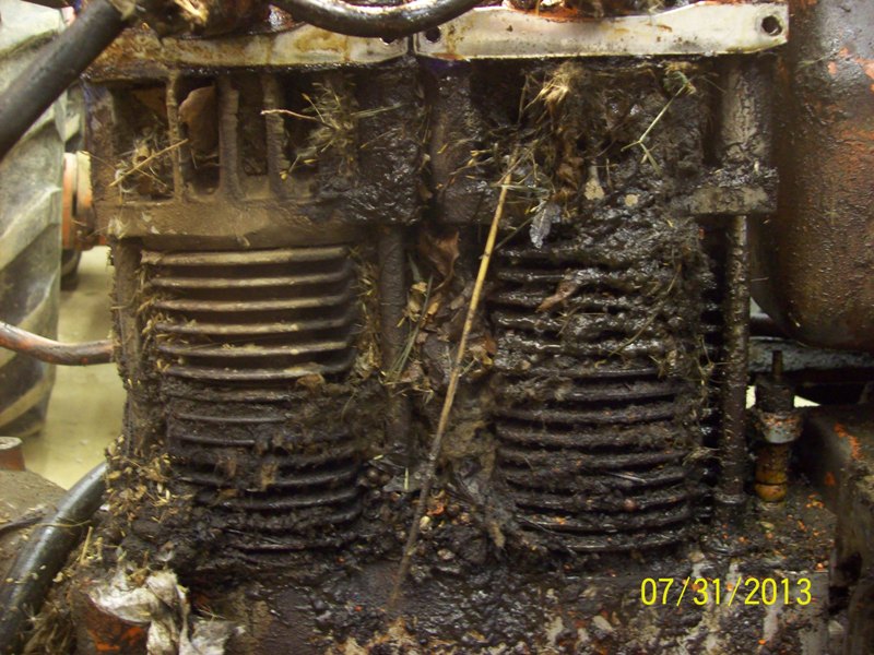

I am not very familiar with water cooled Pasquali Tractors.
I would suspect a faulty water pump and/or a debris build up especially since you are mowing with it.
Let us know what you find.
Pictured is a Ruggerini RD92/2 on my Pasquali 997 that otherwise looked fairly clean....the oil is from a bad seal on an injector pump...

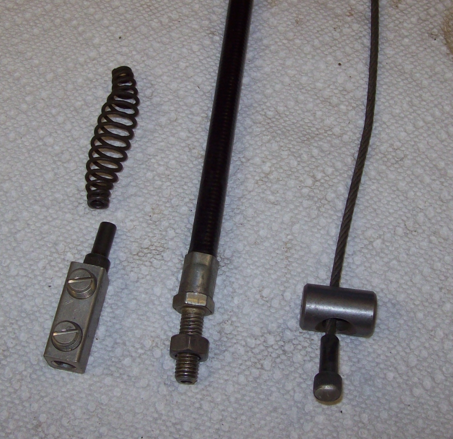

The first picture shows all of the clutch cable assembly components that I used to redo my 997.
This is a typical setup often called a Bowden cable.
Starting at the lower left is a terminal block. This one is aluminum and I have some in steel. This is available at Lowes or Home Depot in the electrical department. It is the last part to be assembled on the cable at the clutch fork under the battery.
The next part up was made from a ¼” Allen Screw and fits into the top hole of the clutch fork. It was drilled out on a lathe so that the cable would slide through it. It is not at all necessary and I only used it because I had it.
The spring is the stock Pasquali item that goes between the clutch fork and a protrusion on the transmission.
Going to the right in the picture is the outer sheath. It is 40.75 inches long and the internal diameter is adequate to pass a 1/8”
cable though it.
At the end of the outer sheath is an adjusting bolt. This was made on a lathe. It is a standard 8-1.25 x 25 metric bolt. Drilled through to pass the 1/8” cable and the hex head end bored out to accept the end of the outer sheath. This keeps everything concentric. This is installed into the threaded tube on the foot rest.
The cable is 1/8” 7x19 aircraft cable 54” long. Available at most hardware stores etc. Be careful of the 7x19 designation as there are a variety of different ways cable is constructed. This is good for strength and flexibility.
Here is where we get to the parts that are breaking. If the terminal on the end slips off the cable that is one issue. If it breaks off with a stubble of cable stuck inside that is a whole different matter.
Quit simply if the terminal slips off it was not properly attached… regardless of clutch pedal effort. In other words a cable will break long before the terminal will slip.
If there is no stepped terminal on the very end of the cable at the clutch pedal this is an issue. If the cable end is secured with any other kind of screw on terminal this is a source of problems, as it will not allow the cable to pivot properly.

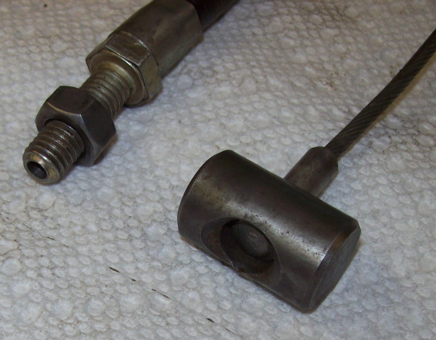

The last component is the solid steel lug that is cross drilled and step drilled. If you look at it the holes are a different size on each side of it.
Looking at the 2nd picture you can see where the cable end will not pass though this lug. As it is assembled in the clutch pedal
It allows the cable and the lug to rotate as the pedal moves. This relieves the stress on the cable and allows it to stay aligned better.
The cable that broke for me was passed all the way through both holes in the clutch pedal and then terminated with a cable clamp beneath that. A No-No in my book…
That’s all I have to say about that…
Joe
