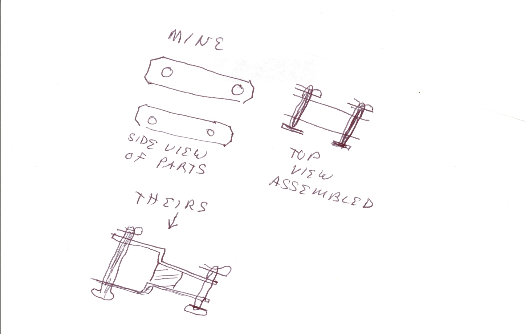

Greg, I should have realized that the EashChange would add length to the lower arms and necessitate an extension to the top. It should be obvious but it eluded me!
I took some steel and made an extension. The EasyChange folks shipped me an extension designed for Kubotas. I took mine off and put theirs on. Theirs is lighter and simpler to use. I had to install it at the implement end of the hydraulic toplink because the mount on the tractor that holds the toplink had been distorted by extreme use. The mount is essentially a couple HD angle irons with holes for mounting to tractor and holes for accepting pins. I can straighten the mount and then move their adapter to the tractor end of the hydraulic cylinder. The way their adapter is made might prevent it from pivoting when attached at the tractor end. That is a good thing as then the top link can push back on an implement (box blade) which couldn't be done with my adapter or theirs when mounted at the implement end.
I just might make an adapter that attaches to the tractor side and extends the whole mount at that end or take the stock assy off and replace it at the tractor end with one that is "deeper." My first choice is NOT to start modifying the cylinder length. I might want to revert back to stock for some reason and then the toplink would be too long.

Can you post a picture of the extension?
Thanks,
Rick
   / Pat's Easy Change Real World Test& 1 question #33
Rick, It is raining a bunch so here is a sketch.
Mine is two separate pieces of metal with holes to accept two pins. It will folld like a bicycle chain so you lose a lot of motion when extending the ram to push down on a box blade.
Theirs is three pieces of metal, two like mine only formed instead of flat connected by a third which is welded to the other two. When installed at the implement end of the ram it works just like mine. It looks like, due to the change of width, that it might fit onto the tractor end in suce a way as to not pivot and rob me of PUSHING force. I will have to straighten out my bent mount to put it there. That is where it was supposed to go but I didn't take time to fix my tractor. The narrow end of theirs should fit inside the mounts on my tractor (where the end of the cylinder goes) and will after I fix them.

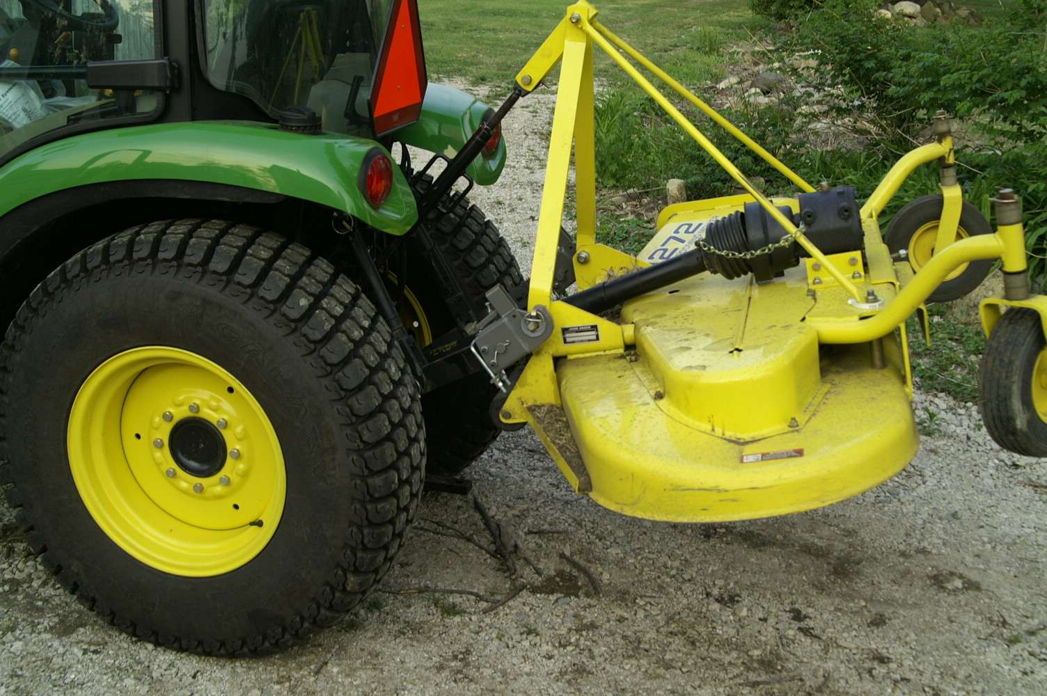

I received my Pat's Easy Change today and installed it this afternoon on my John Deere Cab 3520. I dropped my 72" mower deck and installed the Easy Change. I backed up to the mower hooked one side and then the other, piece of cake. The center link needed some WD40 and had to be taken off to loosen the equipment side. I had enough thread so that I could use the standard center link and attach it to the mower.
As usual the PTO shaft is the hardest part to install. Once I get it started I take a long big flathead screwdriver, hold it on the u-joint, and tap it in with a hammer. Maybe some kind of L shaped bolt would be better to use. I use a lot of WD40 and spray it on the shaft and couple.
I tested it out and the mower functions as usual.
The only issue I can see is that to remove the mower, the deck will be need to be lowered onto small blocks so that the draft arms can drop below the implement pins. This goes for attaching implements too. No biggie.
I haven't detached the mower and gone to another implement, but I don't forsee any more issues. We'll see how the product holds up.

I thought I'd attach a picture for those that might be interested.
