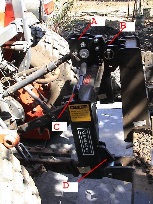

Keith,
I purchased the Gearmore GQH-1 quick hitch from a local Kubota dealer for $230. They had suggested I go with the Cat 1 unit even though the L5030 is equipped with Cat 2 arms. All my implements are Cat 1, so this seemed reasonable, but may not have been the best decision. The ball of the upper link is an 1/8" wider than the space on the quick hitch, but bolting on a couple 1/4" adapter plates (marked "A" in the attached photo) to the outside gave me plenty of room. This wouldn't be an issue if I had a Cat 1 three point, or if I purchased the Gearmore Cat 2 quick hitch (I believe it was an additional $100). By adding the adapter plates, I lose a little adjustment, but this is in a direction where I have plenty to spare. The Gearmore uses oversized bushings which costs $20/set - one set comes with the quick hitch. Cost at this level (under $300) isn't as big an issue with me as having a solution that works.
I've marked 3 other parts on the attached picture - "B", "C" and "D".
"B" shows the upper link "hook";
"C" is the lever to control the lower latch
"D" shows the lower latch.
Michael
