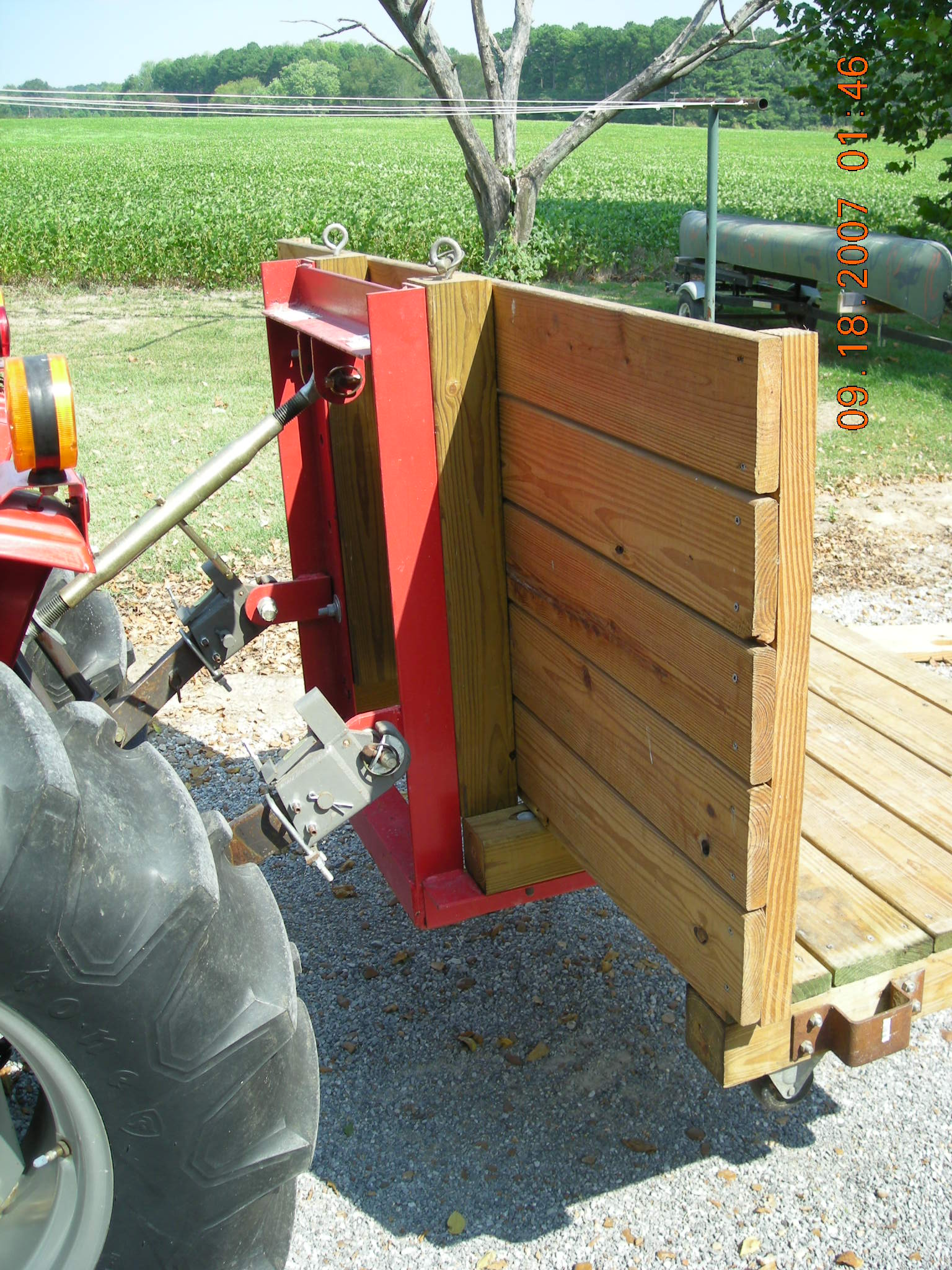

I had to get a longer top link as billbill1 said. I got mine at TSC also about same price. I use the Pats system on my box blade, scraper blade, bush hog, finish mower, plow, disk, and lifter. The longer top link is a necessity when using the finish mower. The Pats system puts the implements back 2 to 4 inches than without it. It is a very good system but as I am a old coot, I would like to have somebody do it for me while I set on the tractor, but my wife has not agreed to do this. She did have a suggestion for me, but i cant say that here.
