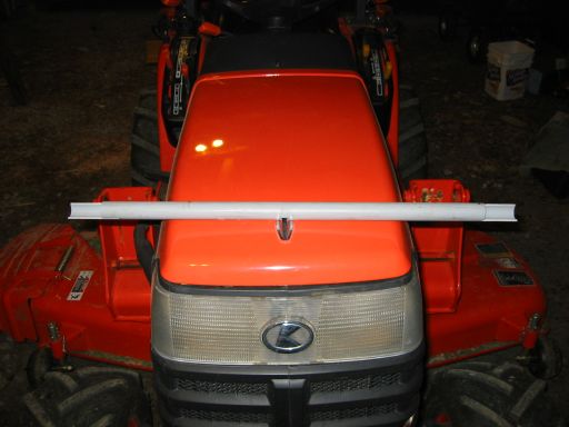

I'm thinking about buying these but wonder about the optional stabilizer bar. Does anyone have comments plus or minus about it? Is it worth the extra $20?
   / Pat's Easy Change System - Order Online! #79
Re: Pat\'s Easy Change System - Order Online!
I have the stabilizer and use it every time I hook up just to keep the arms apart at the proper width. I remove it when the implement is in use cuz it's easy to mangle when using implement if you leave the Pat's couplers loose like I do, ie, no side set screws and slightly loose u-bolts. I don't need to change the width as my implements are close enough to the same width. You could easily just take a 3/8" rod and bend 2" ears on each end to accomplish the same thing if your implements are about the same width and you leave the couplers loose. I bought mine "used" from a very nice TBN member who threw in the bar with the deal so it saved me making 2 bends in a rod. Pat's bar is well designed and made and I wouldn't want to make it to sell it for $20 but I'd definately make one out of scrap instead of spending $20.
Cheers!
   / Pat's Easy Change System - Order Online! #80
.20 cents worth of pvc pipe made this one.......then I found out TBN gets a commission on sales thru them and I felt bad.........
