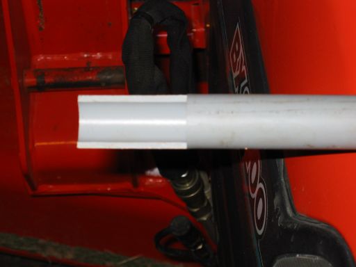

the other side of the ends

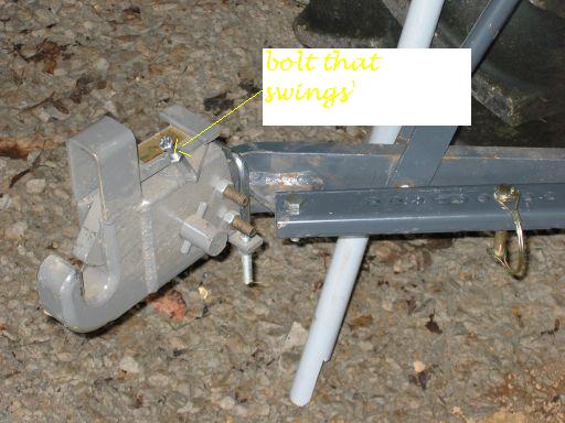

So, looking at the picture on the top of the thread, I can see that the tabs inside these mechanisms are probably spring-loaded right? When you raise the hitch, the pins push the tabs back, then the tabs snap back out to hold the pins in place at the bottom of the slot. Cool.
So, how do you then take an implement off of these? Is there some mechanism that allows you to push the tabs back and lock them so you can release an implement?
TIA,
Dave
   / Pat's Easy Change System - Order Online! #83
Re: Pat\'s Easy Change System - Order Online!
there is a bolt that swings UNDER the tabs to hold them open. These are a good investment if you have to change implements even a few times during the week.
