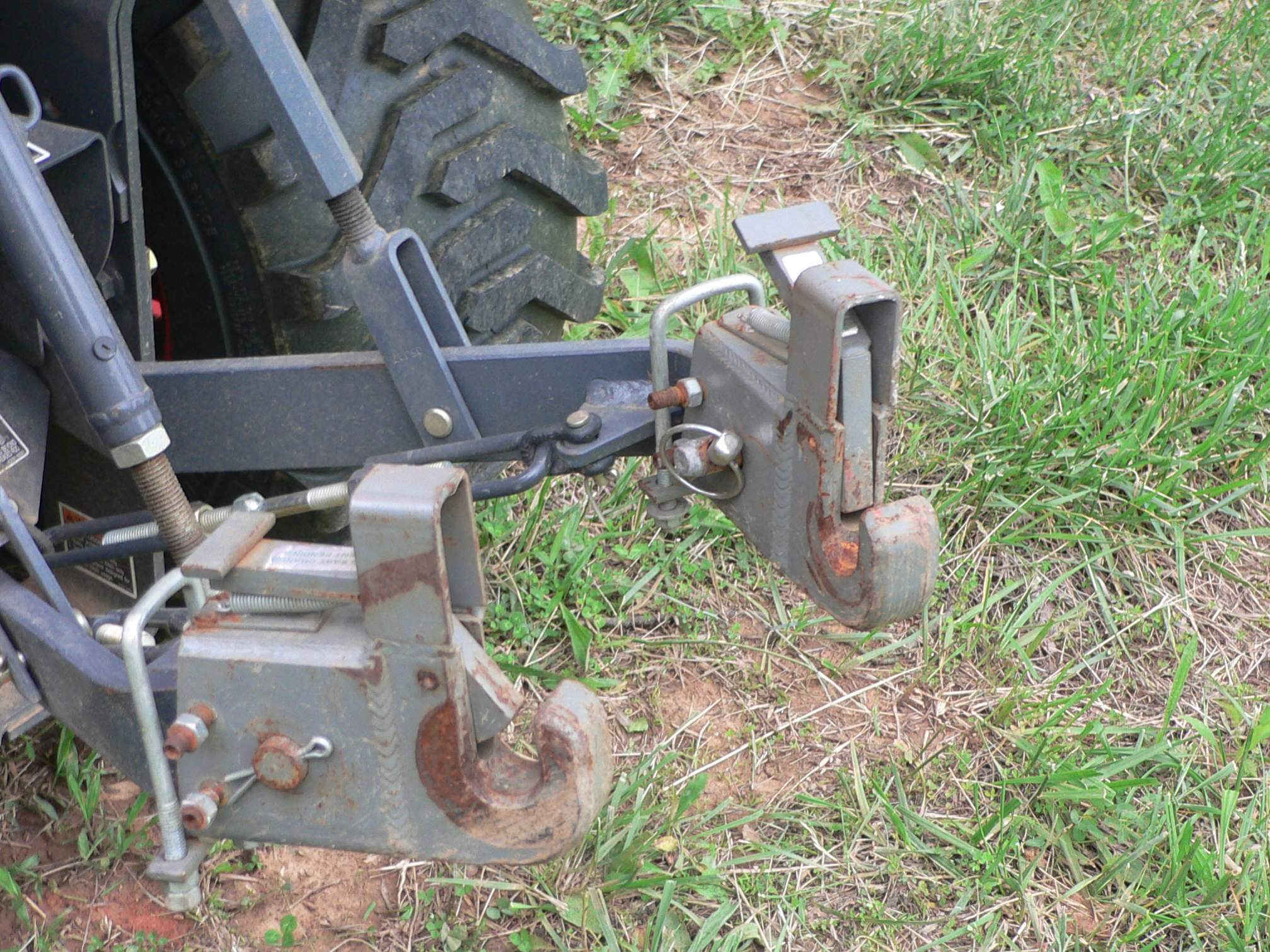

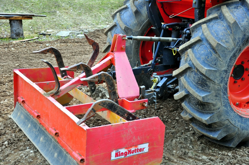

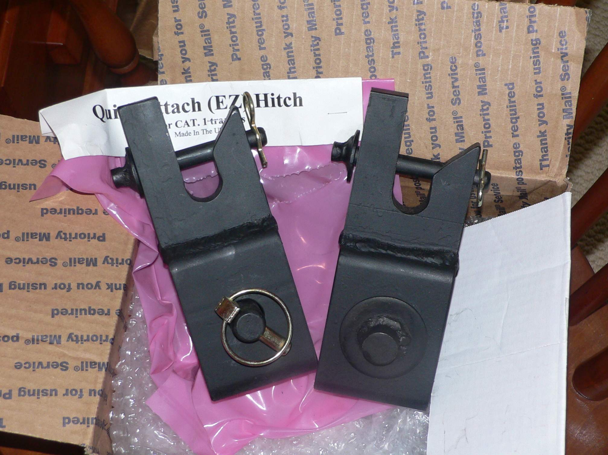

Any update on those? It seems like they would flop back and forth.
I was going to update on those today with pictures. 34 degrees here now but going to get up to 70 so will post pictures later. I did install them, took less than one minute. With them standing up the arms did not drop enough to set under the pins on the boxblade. Choice, lift the boxblade up to seat them, take them off and install other set that comes straight back that was 60' away in my garage or turn the top set ones upside down. Turned the top side ones down and dropped arms down on pins, locked them on, hooked up upper arm and adjusted it and took off. Pulled boxblade through rocky area for a few hours, got stopped by catching a few hugh under surface rocks a few times and then returned tractor to it's building. To take the cheap ones off and on are so quick and simple it's almost unbelievable. I bought Pat's for my first set. Pat's are great. Pat's are wonderful. Pat's are super. Glad I bought Pat's. Glad I sold Pat's and bought these new cheap ones. Pat's are great, Kubota insurance is great. What ever some of you have bought are the greatest. Mine are not the greatest, they are doing the job and I'm not questioning what anyone else has bought and not putting anyone down for what they have bought, just trying to tell what I've bought and how well they work or don't work for me. Just providing my experience and some times my reasoning. Price and performance. More expensive does not automatically make some thing better, some times it doesn't even make it as good. I'm not anti Pat's and I'm not even encouraging the $70 set I bought on Ebay because the seller did not even leave me positive feedback after I paid for them.:)

Being "cocked" inboard the way they are, how can they possibly work at all? :confused:
3PH arms are cocked/bent inboard. When you follow the "cock/angle" through an extension the "cocked angle" becomes more "cocked/at angle". Good thing 3ph arms have adjustments to spread them out or wider. Since they do have the adjustment out then one can hook up the Pat's which is the longest for the greatest "cocked angle" as well as the others as if they are not cocked just like you hook up the cocked angle 3ph without an extension or quick hitch attachment. I understand the Pat's will not fit on some tractors due to fitting over the cocked arm if the angled part is to cocked thus not allowing the Pat's to slide back far enough to lock down/in. The other ones may fit on those that won't accept Pat's. Almost sure those that hook up on top/bottom will fit all 3ph arms unless the angle/bend is to sharp.
