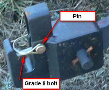

I saw pat's and liked them. and I saw the $70 ones that JohnThomas has..
I could not justify the cost for Pat's at all..
Over the last 2 years the cheaper ones have been great.. (let's call them the ebay specials)..
the ebay special's have had the following issues:
1. lost a pin that locks in the grade 8 bolt in place- working in snow and it stuck to the blade..
2. the side pin went missing in the mud... just a cotter pin-- no biggie..
I didn't splay it out like JT did.. :ashamed: :eek:
3. a weak pin on the 3 point hitch came out and I lost the washer and the implement slipped out of the arm....
all in all PAT's or the ebay special are great little addon's
And thanks to JohnThomas for the great pics I edited for this...
Later,
J

Being "cocked" inboard the way they are, how can they possibly work at all? :confused:
3PH arms are cocked/bent inboard. When you follow the "cock/angle" through an extension the "cocked angle" becomes more "cocked/at angle". Good thing 3ph arms have adjustments to spread them out or wider. Since they do have the adjustment out then one can hook up the Pat's which is the longest for the greatest "cocked angle" as well as the others as if they are not cocked just like you hook up the cocked angle 3ph without an extension or quick hitch attachment. I understand the Pat's will not fit on some tractors due to fitting over the cocked arm if the angled part is to cocked thus not allowing the Pat's to slide back far enough to lock down/in. The other ones may fit on those that won't accept Pat's. Almost sure those that hook up on top/bottom will fit all 3ph arms unless the angle/bend is to sharp.
