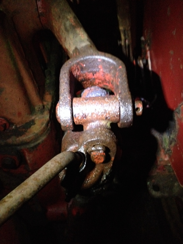

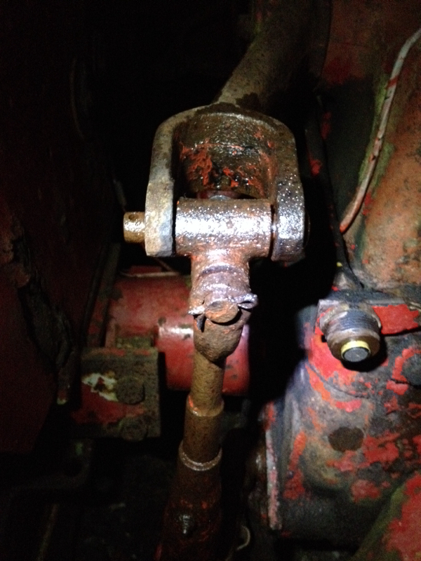

These are the pins I'm trying to remove. Also there's the sidelink adjuster is stuck which I'm trying to free up and getting the lower arm off if the tractor
Not to be a smart A## but you did loosen the set screws on those

thanks guys. i ended up today having just to cut through the pins and will make some new ones. seemed a shame to do it but i just had to get it off. even trying to press them out with heat and everything suggested i ended up bending both 1" square bits of solid bar and stretching the bolts, wrecking their thread. thanks for all your help. still not managed to get the second lower link arm off of the tractor. still spraying daily with aft and acetone mixture
