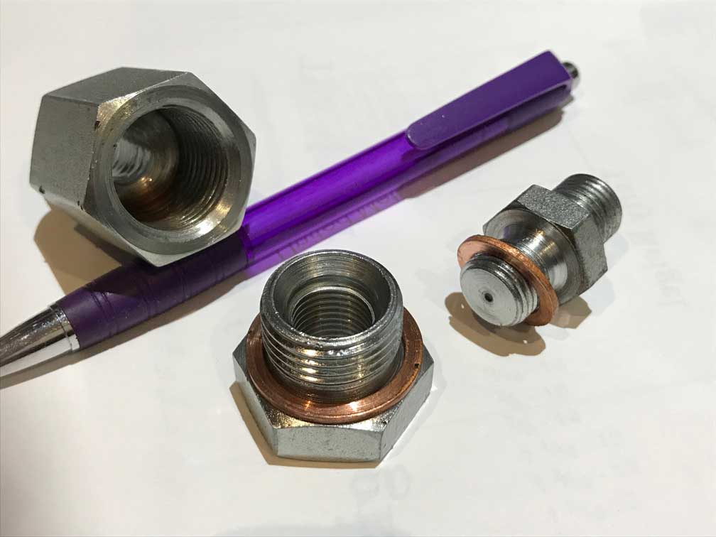

Eric,
It came with orifices in the lines:
Is there something better I could use?

Hello Terry,
You could use parker needle valves to add finer control to each cylinder
The parker metric thread needle valve with a 5 gallon per minute maximum flow rate is
part number #6N616S.
The needle valves have color coded rings to allow quick reference point and some models can be locked with an
allen set screw to prevent tampering.
The folks at Cross Hose and Fittings in Ashville, N.C., are the closest to you and they can help you quickly with what you need.
If you decide to visit them bring the mower manual with you and all your hose sizes as it should have all the information they need to provide you with the correct fittings and needle valves for all three hydraulic circuits on the mower.
You can mount the needle valves on each cylinder to control the oil flow speed on each circuit then set them and lock the needle valves in place and never have to worry about it again.
They will help you with what hydraulic parts you need for your flail mower.

Eric,
Are there any numbers on the orifices? That would let you see what size you currently have and either order a smaller one, or the correct flow needle valve.
Aaron Z
Sounds like what I need. But Asheville is two hours each way - not a very inviting drive if I can get what I need without going there.
Aaron Z
Thanks, Aaron. Any idea where they would be? I didn't see any when I had it apart, and there's noting on the machined face you see in the photo.
