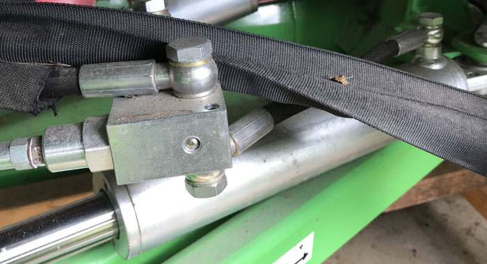

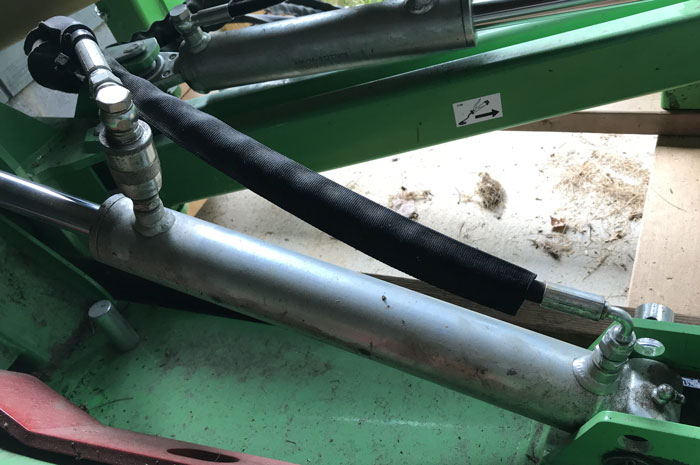

I got down to the mower this morning to understand what I actually have, and to take some photos. Here's what I found. First, the cylinder that raises and lowers the outboard end of the mower:
What's that thing on the rod end of the cylinder? Is that the over center control valve you wrote about, Leon? It doesn't look like any of the photos of them I find online.

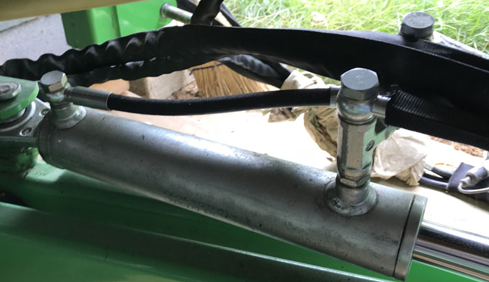

Here's two photos of the other cylinder, the one that swings the mower in and out:
It's hard to see because the hose from the other cylinder is in the way, but there's a bypass arrangement there that limits the force applied. It keeps the mower from swinging when there's too much resistance.
In any case, I'm not thinking that I want to plumb in a needle valve in either of those.

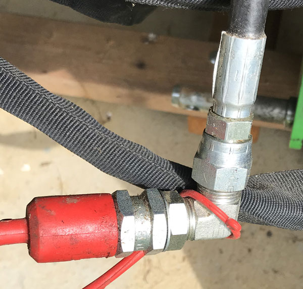

Here's the other end of the hose:
This seems a little cleaner to get at, but I don't know what the threads are on all those fittings, so I'd have to figure that out to get the right connecting adapters how to plumb in a valve.

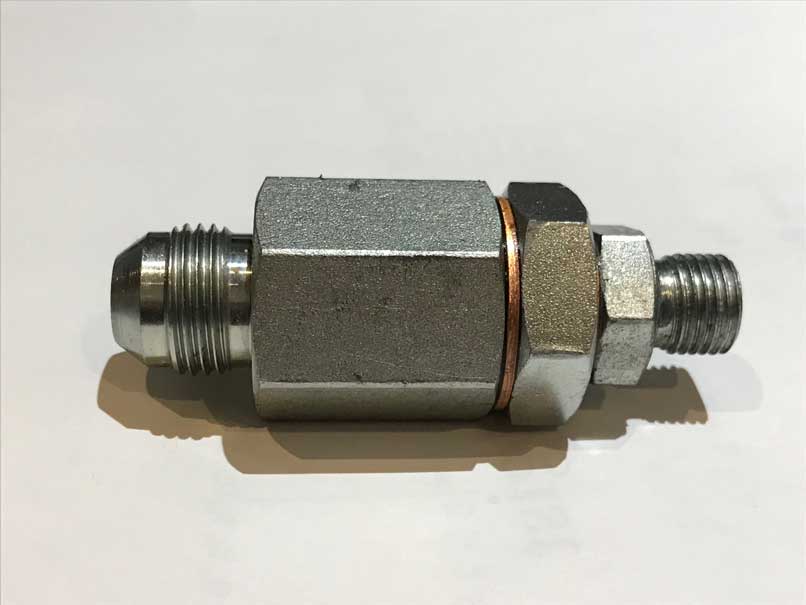

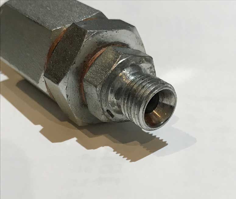

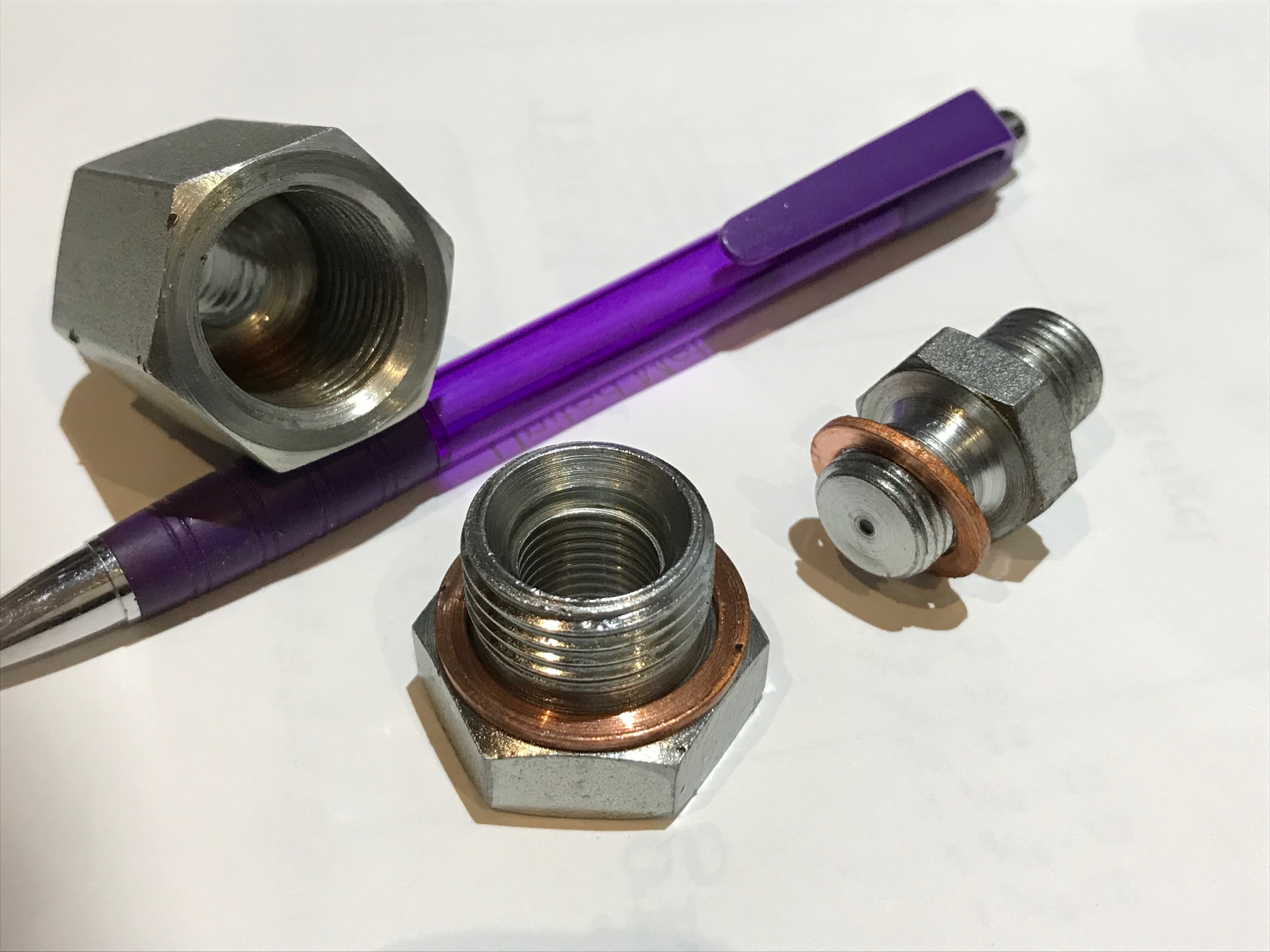

Leon suggested I should remove the orifices if I add needle valves. Doing that introduces another set of adapter challenges. The dealer added extension hoses to reach from the factory hoses to my FEL connectors. They used three fittings, including one with the orifice, to connect them:
If I removed the orifices I need to find a way to replace that connection.

No need to remove the existing orifices- they flow more than you want now. You could drill them out if you wanted but I don't think they'll be a problem.
You can put the valves between the quick connect and the elbow or on the other side of the elbow. Where you put it would depend on how it fits on the tractor. The threads are most likely common size and form for hydraulic parts. Discounthydraulichose has a nice guide: https://www.discounthydraulichose.com/v/vspfiles/downloadables/thread_guide.pdf
Quick connects used on CUTS are usually 1/2" NPT. The fitting on the other side of the elbow looks like it could be JIC or NPSM. If you're not comfortable figuring it out yourself then you bring the parts to a hydraulic hose & parts store. The fittings will cost a little more there than at discount or surplus but you'll get the right parts. You'll need adaptors to go down to 1/4" NPT female for the valves.
Don't use teflon tape as it can get in the hydraulic system if you're not careful. I like the LocTite 545 sealant made for hydraulic fittings. NPT threads need some sort of sealant- they're not the best fitting for hydraulics but that's what a lot of parts have. I use adaptors to JIC and use that for everything else. NPSM would be good too.

3000psi hydraulic fittings should be fine. CUTs generally have their relief valves set in the 2200+- 100 range.

You have a bunch of banjo hydraulic fittings with sacrificial copper gaskets that let you adjust the hoses/fittings to let them sweep properly without becoming tangled when they are connected. The copper gasket type hydraulic fittings are just another way to install hoses and fittings in close quarters like the BSP hydraulic fittings/mating surfaces and threads that use the blue dot o-rings and steel compression washers to hold them in place.
The valve block that is attached to the banjo fittings is a flow control/metering valve I believe. The least little bit of dirt or foreign particle in the control surface can make it operate in an erratic manner. We had that happen quite often on our old roof drills a lot where the feed controls had a piece of piston packing break and jamb in the orifice hole for controlling the differential feed cylinder for the drill head.
Your mower manual should have a hydraulic schematic showing everything that operates the mower.
If you have time tomorrow please call the IFE folks and ask to speak to someone in the shop and tell them you are having trouble with the finite control of your mower and ask about the this valve to find out exactly what valve it is and ask if a piece of debris could get in there and cause it to operate poorly.
If anything you will need the copper banjo gaskets anyway to allow you to remove the cartridge and check for debris and reinstall it with the new gasket as the old ones cannot be used more than once.
