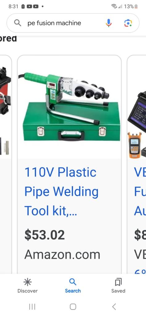

Looks like $53 for no-name micro fuser. My thought on a set up like this, is temp control, and in the videos I've seen, they basically 'melt' a bell and spigot, and not a butt weld like a proper Fusion machine. Also, with pipe Fusion, clean, perfect butt are critical; as well as temp and then holding for right amount of time with right amount of pressure.
It says it works on PE, PB, and PPR. No idea what PB or PPR is? Maybe PolyButlyne? PVC, CPVC, HDPE (often people say HDPE, but mean LDPE or MDPE) I'm familar with, not sure what 'PEX' really is, chemically.

Looks like $53 for no-name micro fuser. My thought on a set up like this, is temp control, and in the videos I've seen, they basically 'melt' a bell and spigot, and not a butt weld like a proper Fusion machine. Also, with pipe Fusion, clean, perfect butt are critical; as well as temp and then holding for right amount of time with right amount of pressure. View attachment 833402
PB is polybutylene, and PPR is polypropylene. PB is uncommon.
PEX is cross (X) linked Polyelthylene. Basically polyethylene with some bonds that link the polyethylene chains to each other making a tougher, more dimensionally stable plastic. The cross links can be generated either with extra chemicals mixed into the polymerization step, or by irradiating the polyethylene with electrons.
I would only use a cheap fusion bonding system where I a) could see a leak, and b) tolerate a leak, I.e. not inside a house. Real ones cost $$$$ for a reason.
