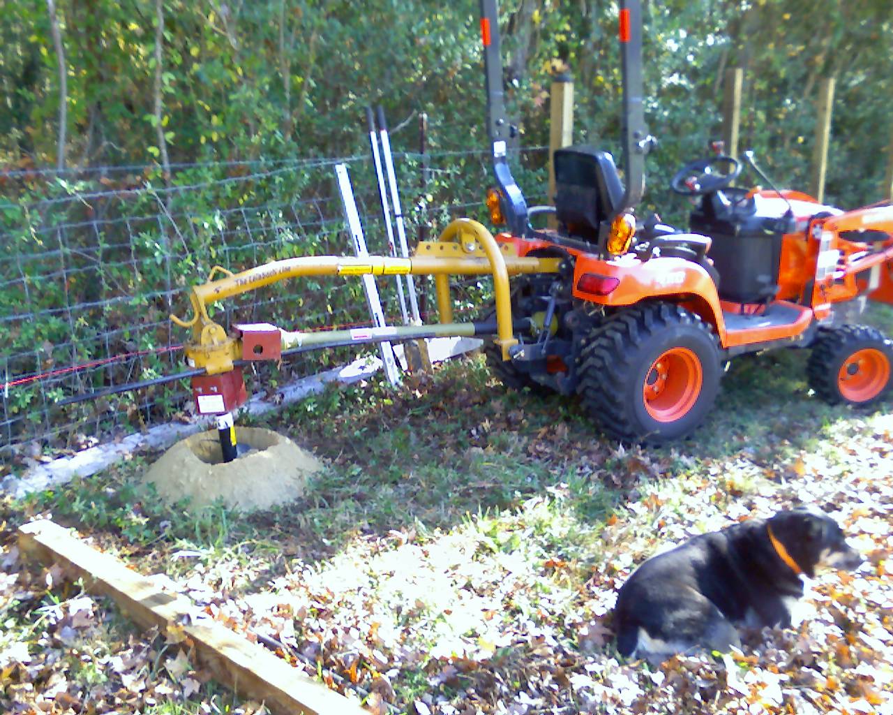

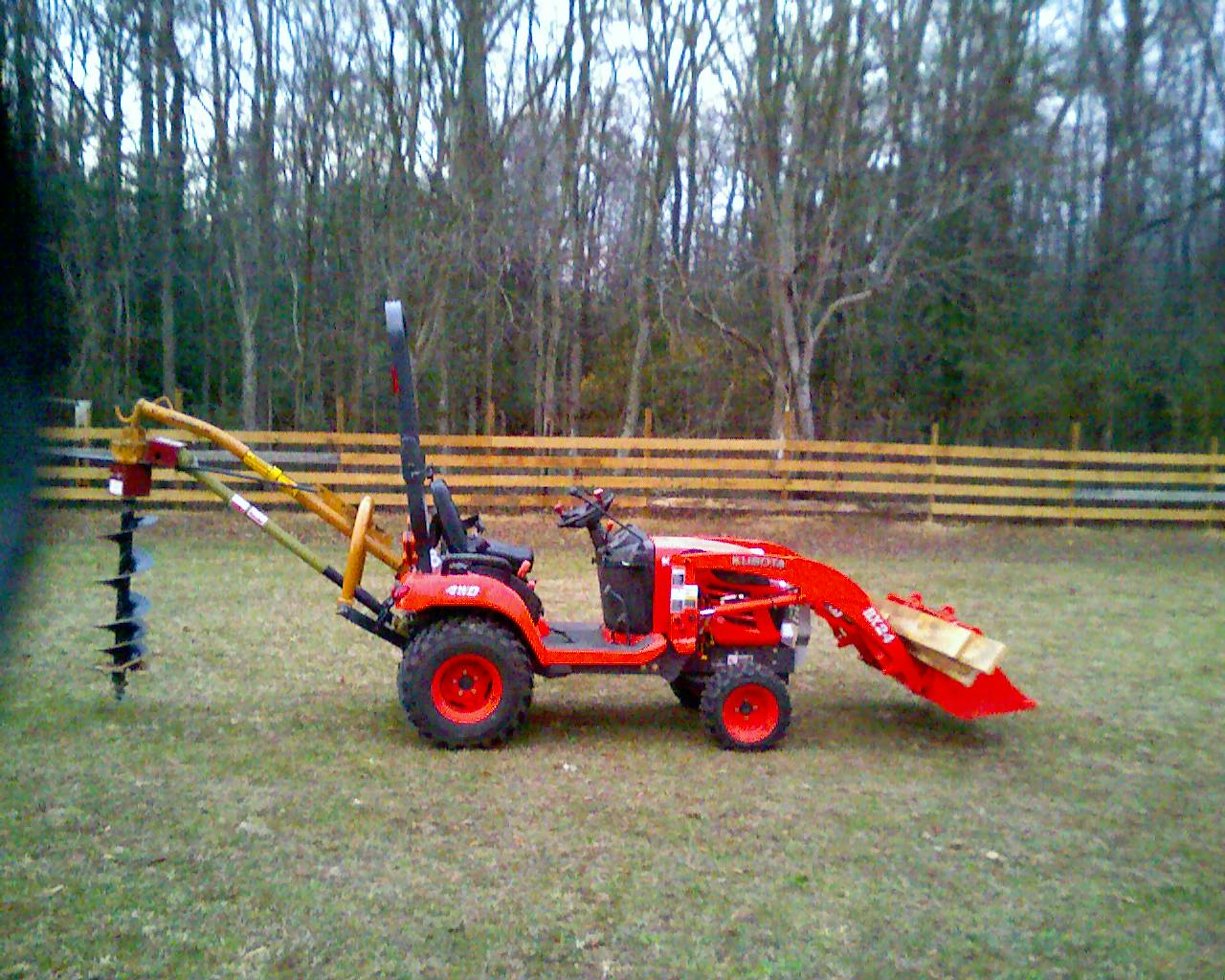

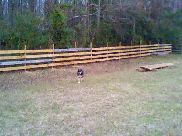

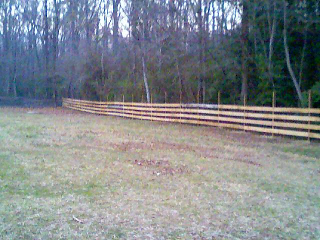

Just wanted to report back that I finally finished the fence line that I was working on using the Leinbach post hole digger. Thanks to everyone that responded with good advice. My last few holes were dug quickly, once I really got the hang of it. Each hole was different, depending on rocks, roots and type of soil. My soil seemed to change about every 3rd hole. Attached are a few pictures of the project (pardon the quality, all I had was my phone to take the pictures with).

Looks good. One more project under your belt.
Wedge
