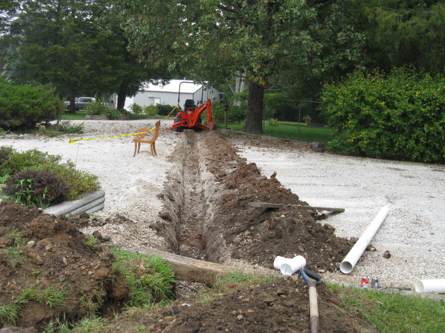

here are a few more photos of the progress i made yesterday.
i was wrong about being finished with the digging. i still had to dig the trench for the drain pipe to go into the ditch! it was the shallowest run but also the hardest to dig. it was really tough to get through 30 years of hard packed road clay and gravel. but it's done, and has a good slope so i'm not worried about draining the pipe once installed.

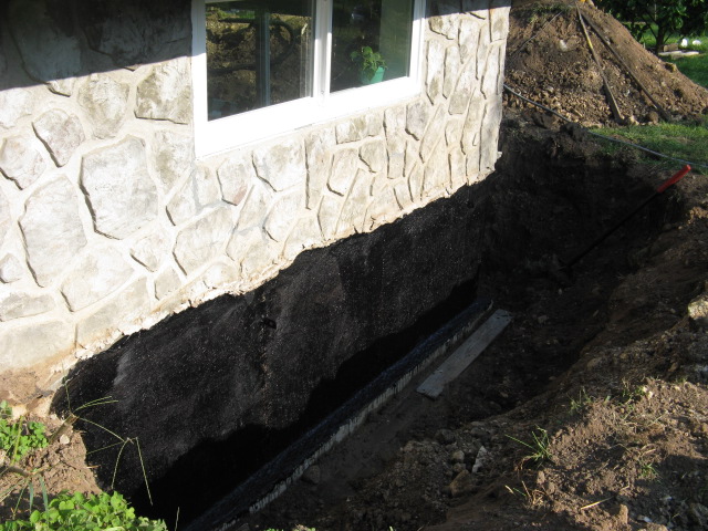

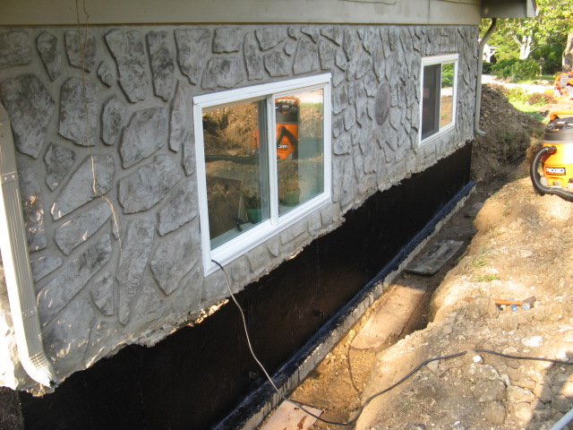

i found two small cracks in the foundation that ran roughly along the seams from the original forms where the metal ties extend out. i chiseled them out a bit (it was hard to chisel so i'm thinking thats a good sign the cement is still very strong) and caulked them good with UGL drylock caulk. then painted over everything with blackjack rubber coat which you can see in the photo.
i'm thinking its a good idea to snap off the metal ties as atgreene suggested. i was originally thinking they would stick into the foam insulation board and help hold it into place, but they would also poke through the plastic film making holes where water can get in, so i guess they are gone.

today, the first coat of asphalt sealant i put on yesterday is still drying. we had a cool, dewey night last night, so the thick stuff down near the base is still wet. after the sun comes out a couple of hours, i'll be able to apply the second coat and then start putting up the plastic and insulation board and laying the pipe.
i'll probably use contractors glue from the caulking gun to hold the top of the plastic and foam board in place until the backfill is in. as far as i can see, the only other option would be to use some type of concrete anchors and that is just putting more holes in it. any thoughts on the best way to secure the plastic and foam board? i bought flashing to go over the top of the foam board and i think i can glue it in place and that will divert any water that gets under the eaves and flows down along the wall.

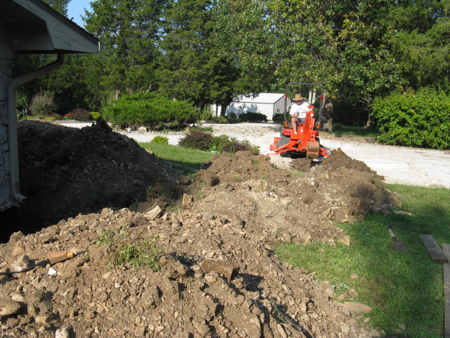

lbrown59, i agree that rocks like this should never have been backfilled. we have a whole rockgarden and pond made out of rocks this size, smaller and larger, that were blasted out to make way for the foundation by the initial builders. most of them were piled in the yard some distance from the house, but many of them made it back in when they leveled the yard (i guess).
that particular rock has been a headache for us since we lived in the house. it prevented us from planting things there as well as leveling a flowerbed border. and, i think it could have really been contributing to the leakage problem since it extended well beyond the edge of the roof and any rain water that fell on it would have been diverted back against the house wall instead of out into the yard.
yes, i was very glad to see it gone and no, we won't be putting any large rocks back in! i've been handpicking them up as i can, and will be working on the rest of them as the backfill is slowing pushed into the ditches later in the project.

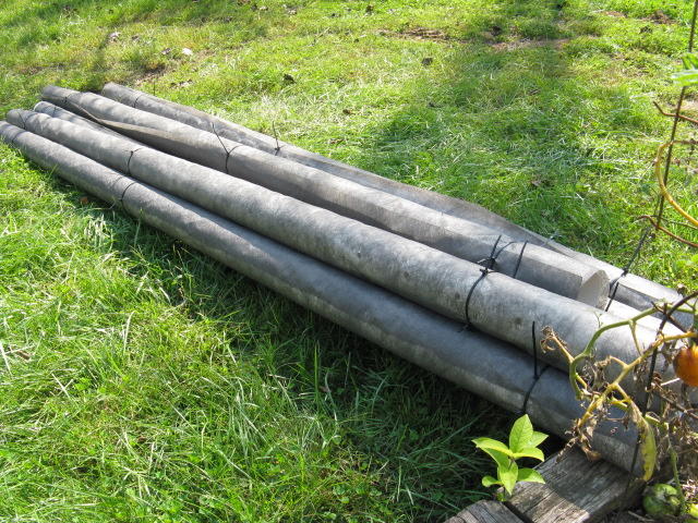

here are the pics of our "burritos". mom wrapped them with fabric yesterday and we secured with tie straps to hold it in place until the fill is packed in around the pipes.
