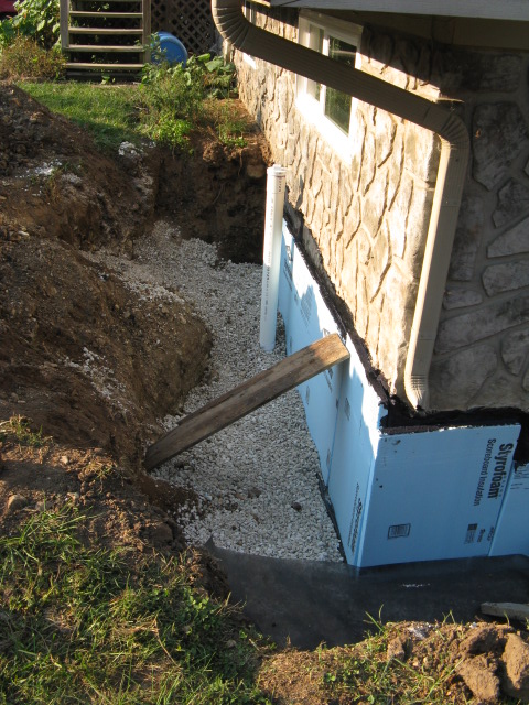

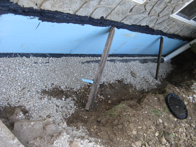

i had actually thought about that a little bit. my logic is, if the pipe freezes, most likely the water will be frozen as well, so it won't be leaking in the basement. the worst case is if the outlet freezes and dams up where it gets shallow but the heat from the house and the ground keeps the water liquid around the foundation. i'm hoping that it will drain enough away and any water that falls on the surface (snow/ice/freezing rain) will not penetrate the frozen ground until the pipe thaws.
we have several other shallow drains (two buildings have shallow gutter downspout drains and we have a grey water drain on the shop building) and have not had a problem with freezing blocking the water. of course, we are zone 6/7 but we do get down to near zero every winter. i think if you are moving warm water, you won't have a significant freezing problem.
i suppose in the exteme, you could wrap your exit pipe with heat tape anywhere it rises above the frost line.
or use a pit and pump method instead of draining to daylight.
most full basements if done properly use an internal drain with sump so the external pipe is just extra insurance.
maybe someone with more "northern" experience will chime in?

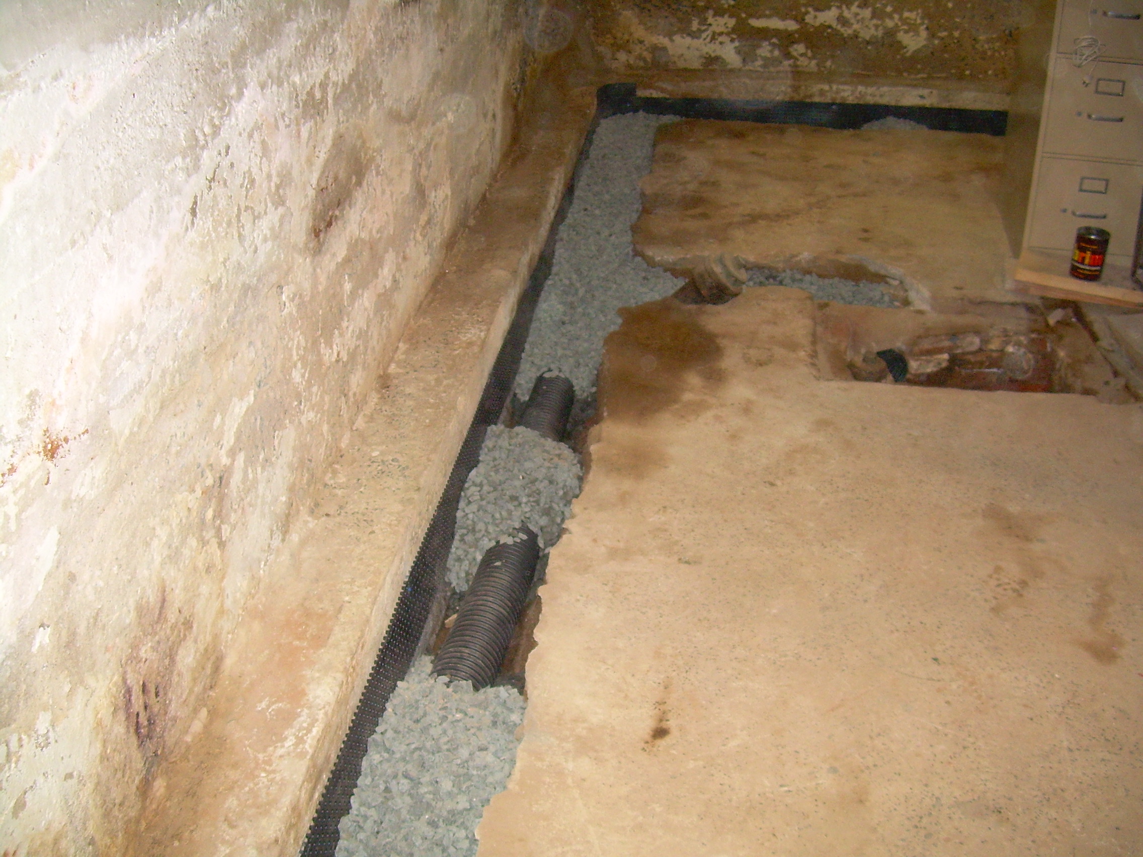

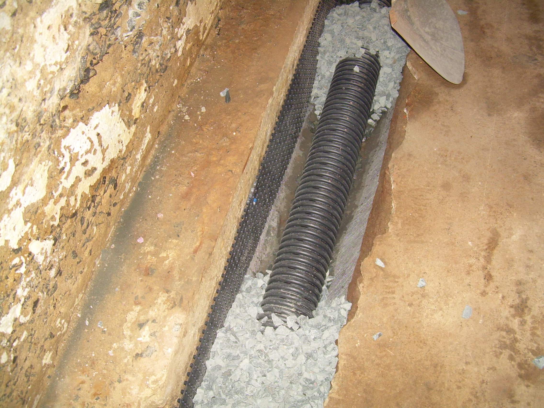

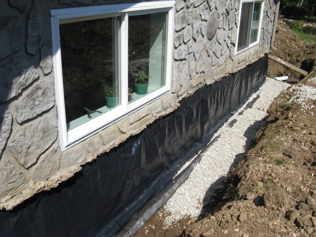

just realized i never posted a pic of the white clean rock around the pipe. it is there in the one photo, but the filter fabric covers it up. since this is probably very important, i didn't want someone to forget this step and not do it.
i laid the pipe in the hole and connected it all up being sure it was down deep enough to be below the floor - holes on the bottom of the pipe, so should get drainage at least four inches before level reaches the floor.
then shoveled in the rock being sure to get it all around the pipe. then, raised the pipe up and jiggled it so the rock would flow under and around it and used the white gravel to get my final level so the pipe sloped gradually towards the drain. (about 1 inch over the entire run to the T where the drain connected.)
the actual drain pipe has much more slope to it, about an inch per 10 foot section, but i was limited by the foundation being pretty much level so i had to keep the actually perf pipe pretty much level but did want it to have a bit of slope to keep things flowing. i also had to deal with the limestone shelf rock the original builders blasted away to pour the foundation. i didn't have the desire to start chiseling into that stuff, so couldn't get any more slope than that shelf would allow. i think it's going to be ok. you have to work with what you have.
