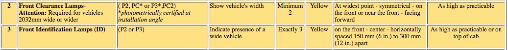

   / Pick up cab clearance lights - required? #24
NHTSA light requirements.
Above from:
BASIC EQUIPMENT REQUIRED ON ALL TRUCKS, BUSES & MPVs
Bruce

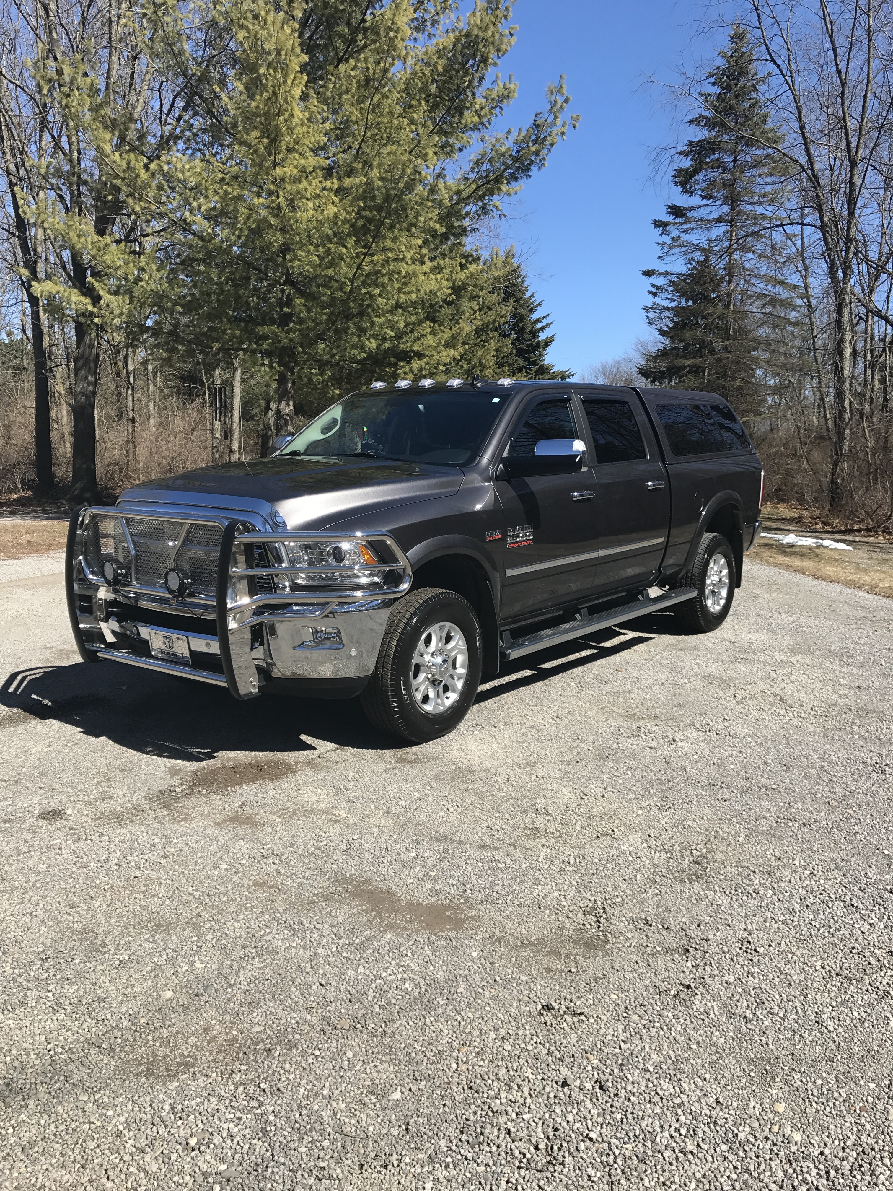

I would just add them to be on the safe side.They were $195 option on my 2016 Ram 2500..
