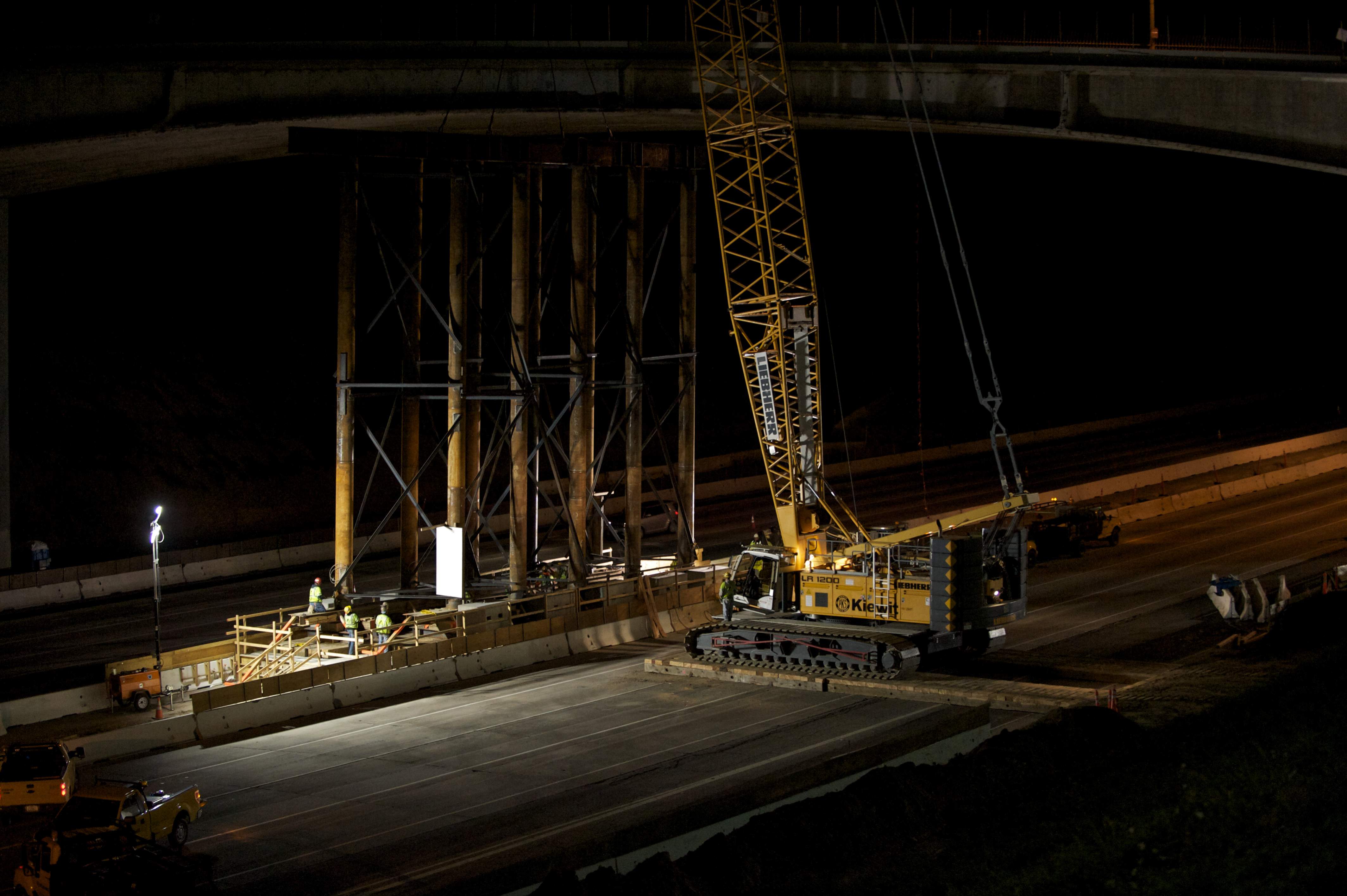

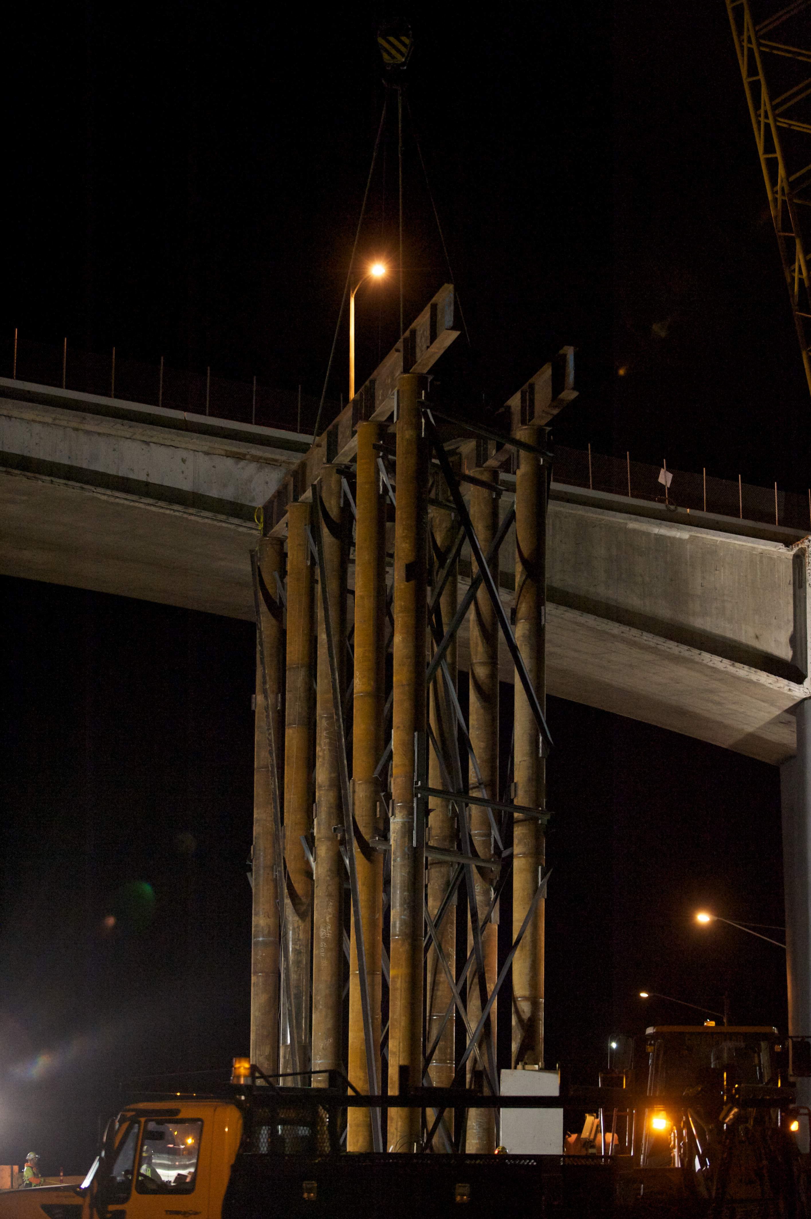

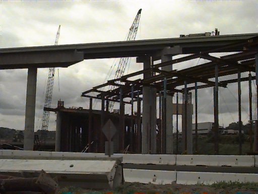

Back in my falsework building days, I can't tell how many times I had to pour rain water out of a can of 7018. Because some carpenter type left the lid to the gang box open.:
I guess I am more of a stickler for rod storage for structural welders. On our jobs, the structural guys used rods from the same storage as pipe welders, so we (my QC inspectors & welding supervisors) made it mandatory to use rod caddies for all welders and anyone found with the can not plugged up was reprimanded. Everyone had to put all rods back in hot box at night or else plug in their 10# caddies. Caddies were checked out each morning by number so we knew who the culprit was when it didn't come back in. The second warning got the welder 3 days off without pay and the 3rd warning got him fired. We threw away any rods left out rather than take a chance on those rods getting into a 100% xray weld and causing porosity. Only 6010 rods were allowed to be keep in gang boxes and those were discarded if they were left out long enough to form a white powder on them. Part of the QC program was to inspect gang boxes and confiscate any old rods for disposal.

When building false work everything was to be to AWS code. But normally that was only in the spec book, and at the bottom of the blue prints. Now anything that was a permanent structure, that's a different story. That's when the welding inspectors would come out of the job site office trailers.:D
