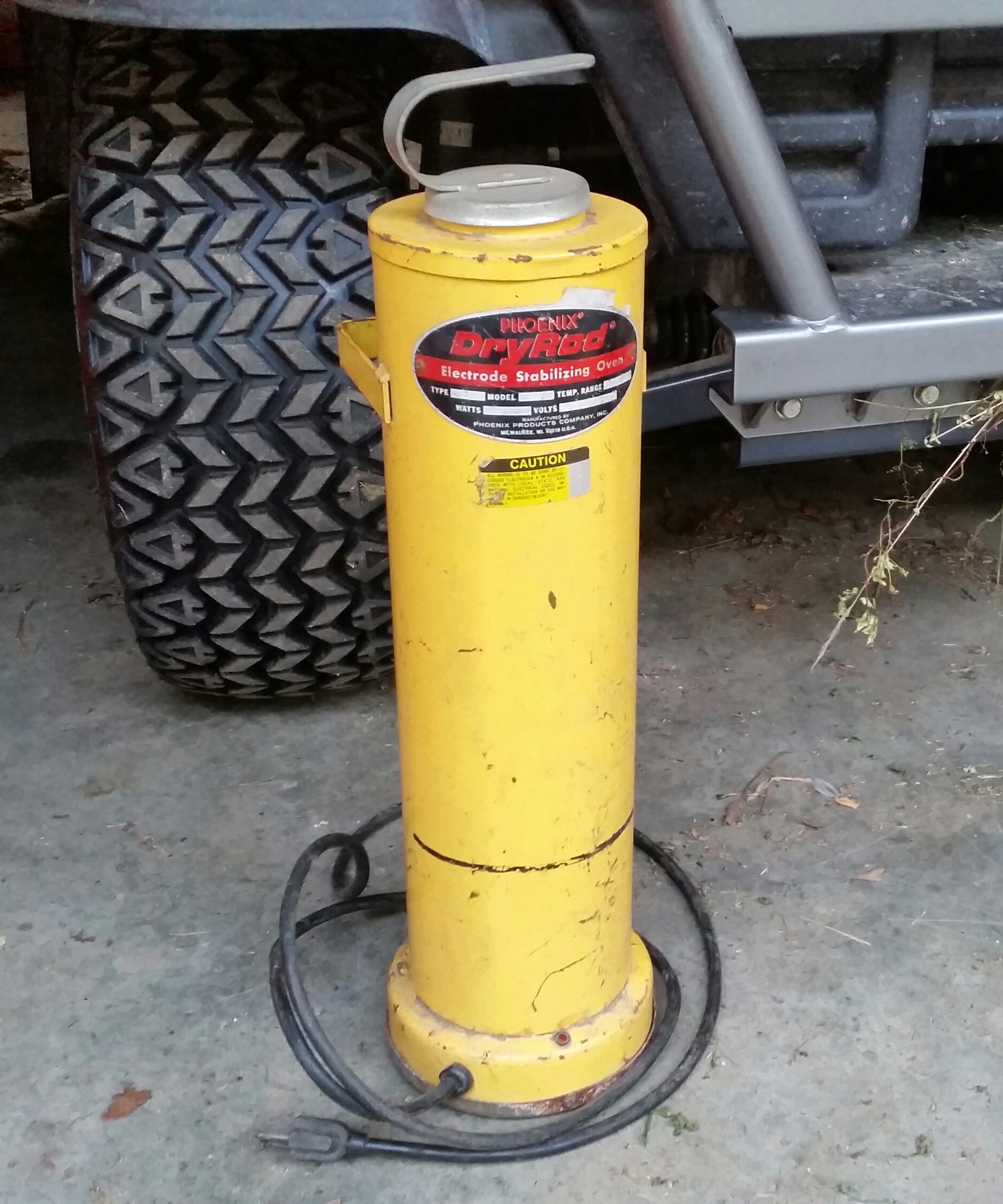

Thanks to the keen eye of Shield Arc and his watching of Craigs List,
I picked up three of the rod ovens back in late 2012 for a total of $50 that I posted about a problem in
http://www.tractorbynet.com/forums/welding/264114-rod-oven-pops-gfi-breaker.html
That problem was resolved. I have two BVT models with variable thermostats and one BHT models with a fixed thermostat.
I use the one and keep the others as spares. Probably should sell them but parts are not available for the older ovens anymore (according to the manufacturer) thus I keep them just in case.
First I am definitely not doing code work
but I do like the way 7018 burns after it has been in the oven for a couple of hours. Two hours is good but I can see a difference if I let it go to three hours. The thermostat turns them off when they get hot enough and then cycles to keep the rods at the variable set temp on the BVT's and a fixed temp on the BHT model.
You will really like the ovens for your 7018.

Those little portable 10 lb rod ovens are usually about 75 watts.
Sooooo. 75 watts x 24 hours x30 days = 54000 watt hours = 54 Kilowatt hours x $0.11 per Kilowatt hour (the price around here, your price may vary) = $5.94 per month. x 12 months = $71.28 annually. Nothing to sneeze at, but not quite as bad as $720 per year
Welding | Industrial DryRod Ovens & Furnaces | DryRod II Portable Electrode Ovens, PHOENIX 1205500 | B301834 - GlobalIndustrial.com
That is good figuring but you failed to note that the dryrod ovens are thermostat controlled and insulated so they don't run all the time. I would bet the actual cost to run is about 1/4 that or less.
I have a 350# Phoenix Dry Rod oven that is set at 275F and stays plugged in all the time. My shop is on a separate meter and most months my bill is about $40 which includes lights, fans, welding machine and lots of grinding and cutting with my chop saw. When I don't do a bit of welding for a month(like winter months), the bill is usually minimum rate. To me the ability to have dry rods and never worry about my 7018 getting rusty and unusable is worth what ever the cost is. I seem to recall that I paid $200 for my oven used on Craigslist which was also a bargain. I usually keep around 100# of rods in it, 50# 1/8" and 50#3/32" when freshly stocked.

Today I managed to pick up a nice little rod oven on Craig's List for $40.00. I'm not sure I really need it right now, but it was 15 minutes away and seemed like a fair price. What do you guys think?
That is a fair price for that oven. IIRC they run $150- $200 new.
I knew about the thermostat, but I figured I had stomped on the poster enough with a factor of 10 on the yearly cost to run the rod oven. And besides, thermostats can stick closed, and it might run continuously.:D

As noted by other poster, put 10# of 7018 in the oven and keep it powered up 100% of the time when storing rods. You can take the portable oven away from power for up to 5 hours and not have any effect on your rods but it should be hot all the time when just storing your rods. It is thermostat controlled so it will only cycle on when needed.
Phoenix also makes a 50#, 300# and 900# version of dry rod boxes for folks like ShieldArc who need the extra capacity.
