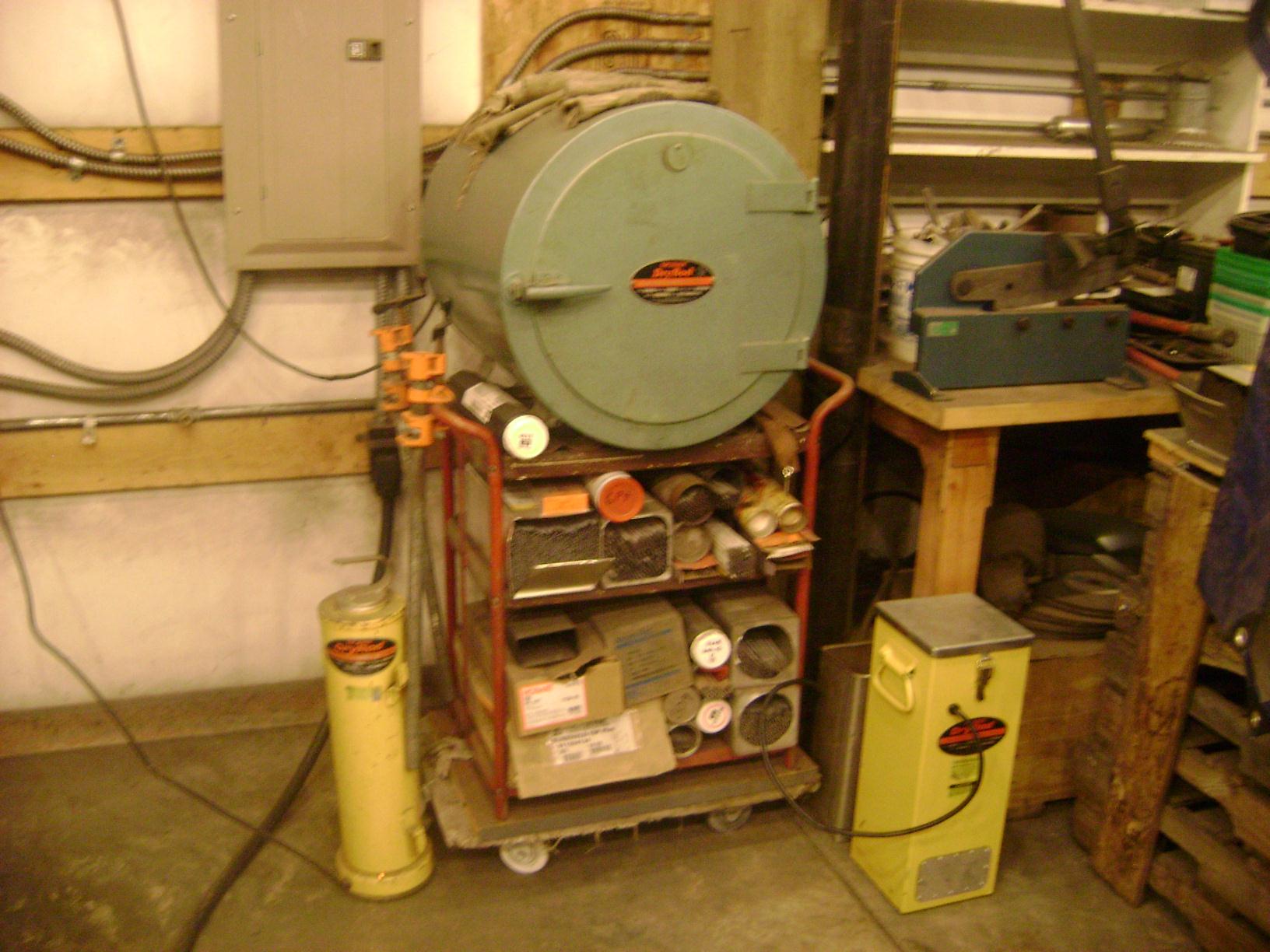

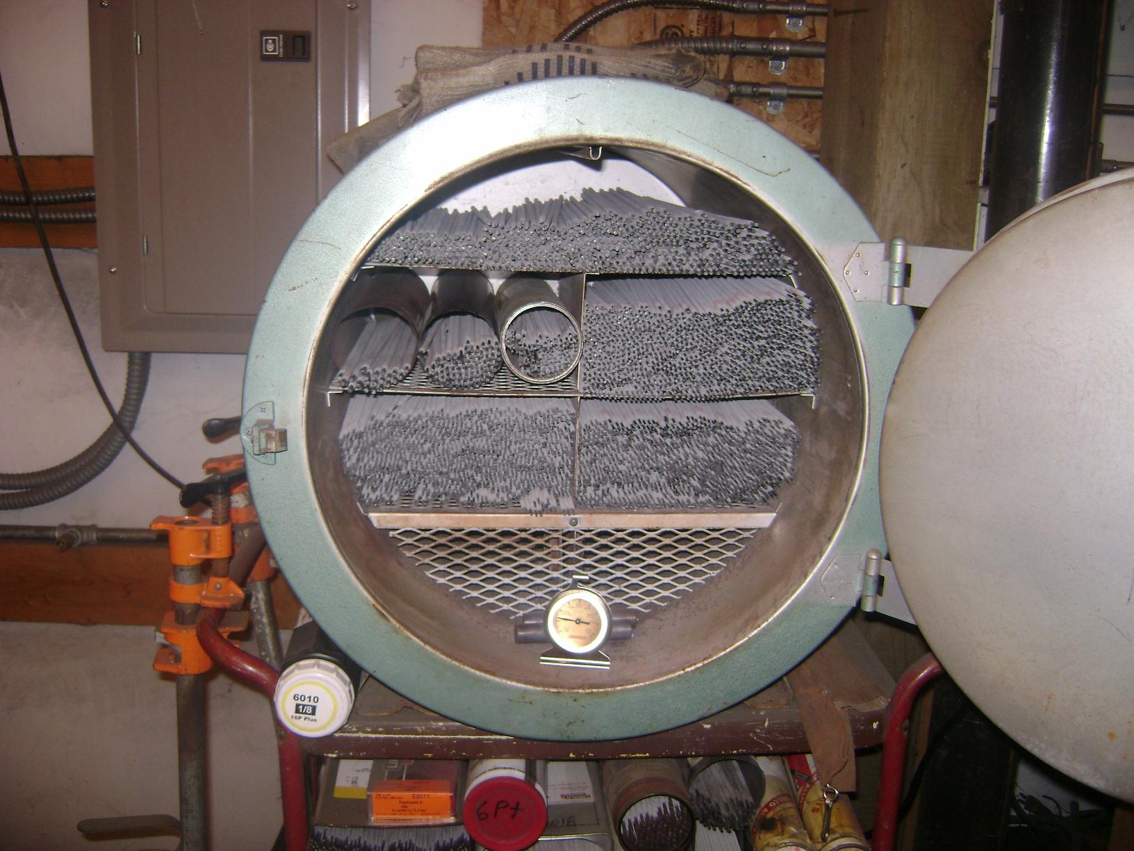

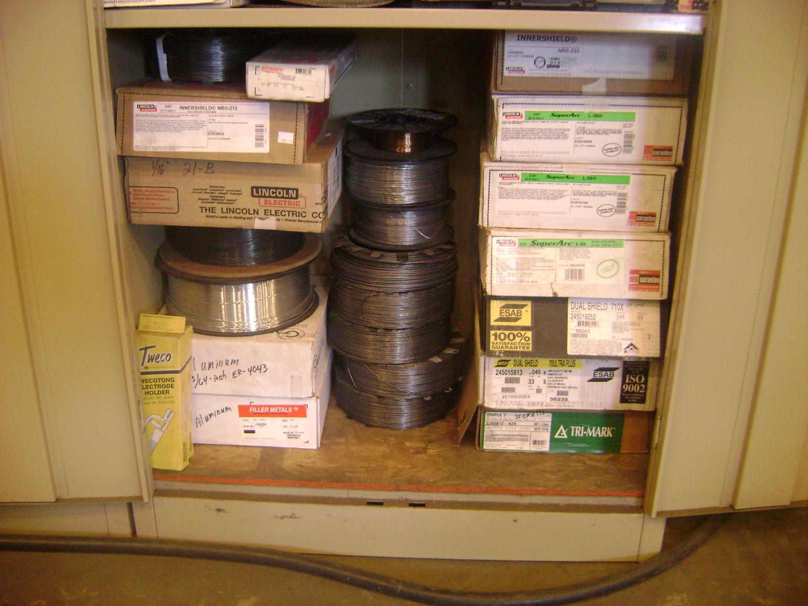

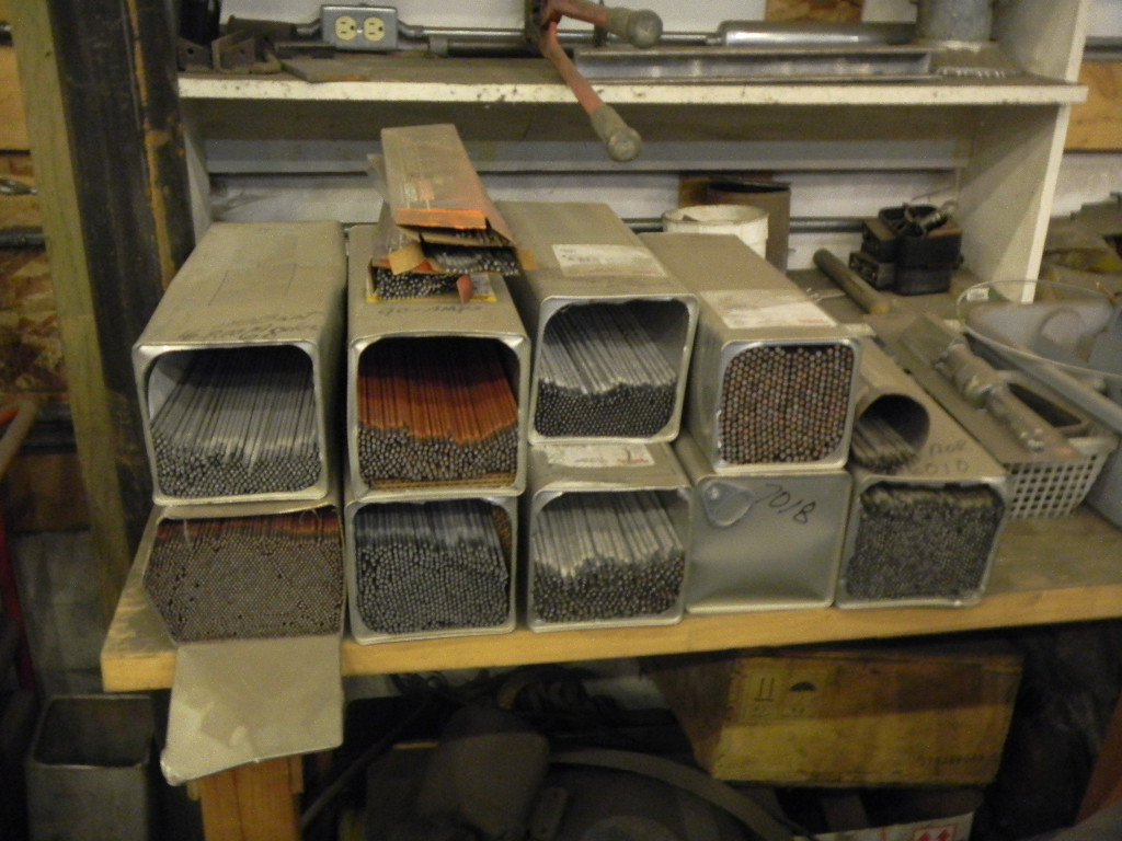

I leave my 300-pound oven on 24/7. My shop is on it's own electrical meter, it is very unusual for my power bill to be over $30.00 per month.
Holy welding rod Shield Arc:shocked:
