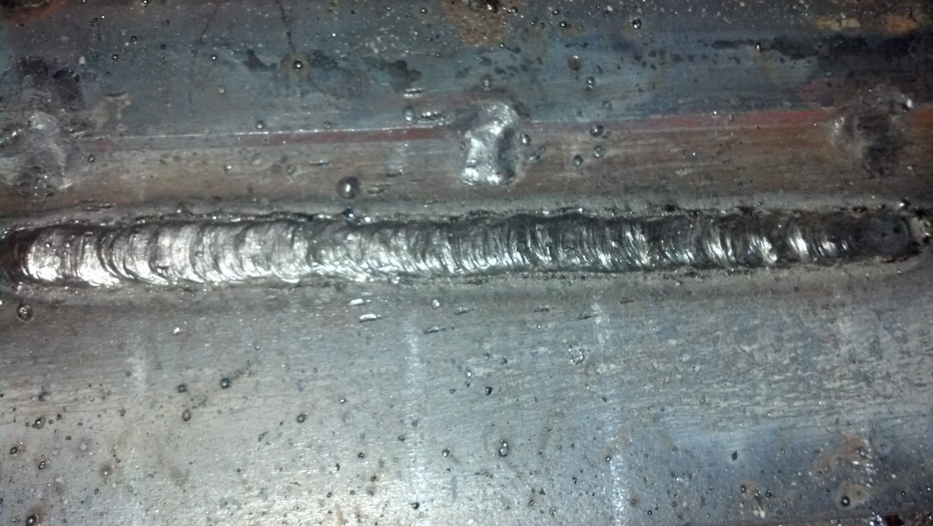

In any event, I'll attach a pic below of a bead I ran flat on a piece of scrap. It's not all the pretty, but I'm learning.

Actually, in my opinion that is not a bad bead for 6011.. I would be happy with it. 6011 does not make a as pretty of a bead as say 7018. I can see some variable travel speed if you want to get critical, but overall not bad. Keep in mind consider the source, I am no expert by a long shot.

I think the travel speed picked up as the electrode burnt down, I'm trying to get used to the initial start of the bead with a fresh rod.
   / Picked up my first welder today #76
Probably the most common thing for a beginner to do is travel faster as the rod burns down. That's where drawing parallel lines with soapstone will help to keep a consistent bead width/travel speed. Your bead doesn't look bad at all. A little colder than I'd run but pretty darn good for a newbie. I'd give it about 80%.:thumbsup: Sounds like you have a knowledgeable instructor, you just have to pay more attention.:laughing:
   / Picked up my first welder today #77
I'm also no expert, but I agree with others that bead looks okay for 6011. Part of the challenge with travel speed is that, as the base metal heats up, you have to move faster to keep up with the puddle. So if you are moving at a constant speed, you're actually, potentially, moving too slow by the end of the bead. As always, reading the puddle will tell you what you need to be doing.

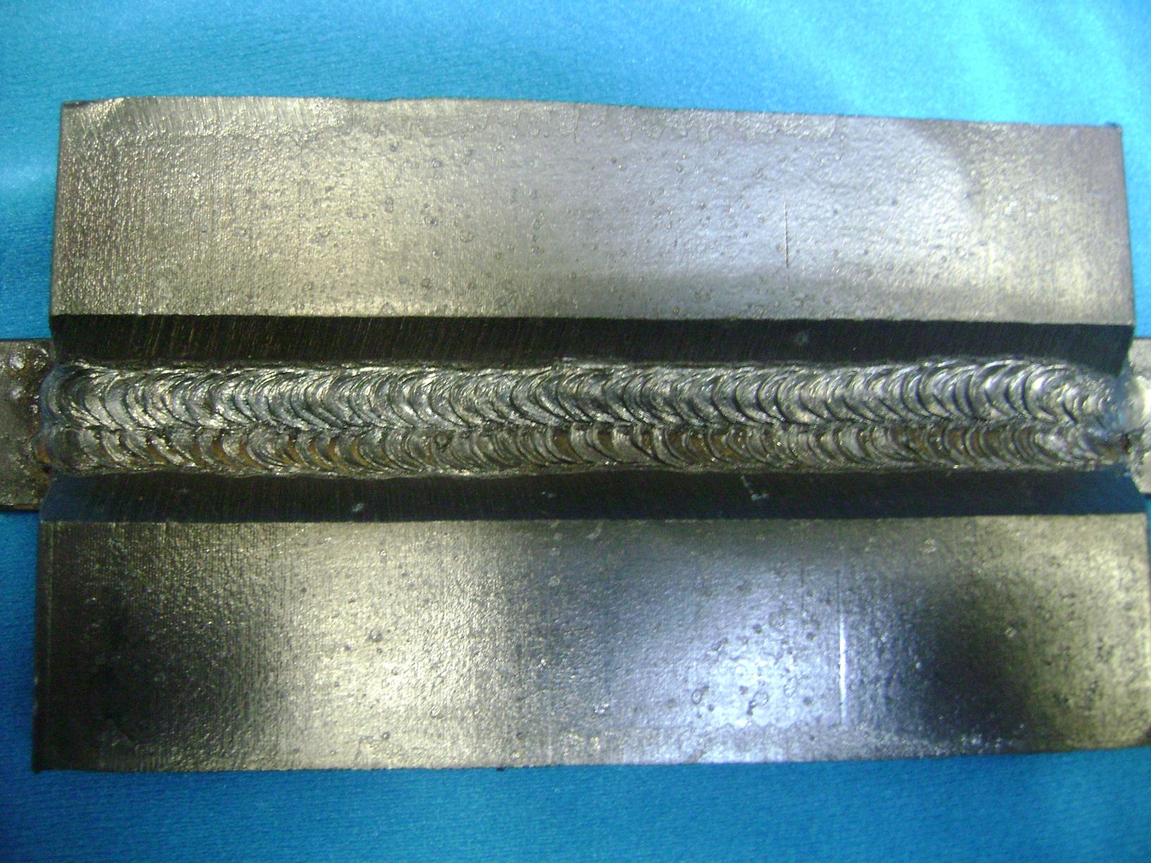

That does look pretty darn good! :thumbsup:

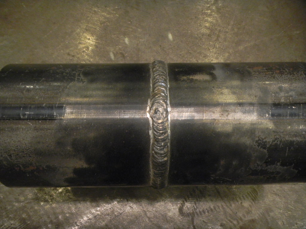

I'm no expert either, but maybe these pictures will give you an idea of what the whip and pause looks like.
