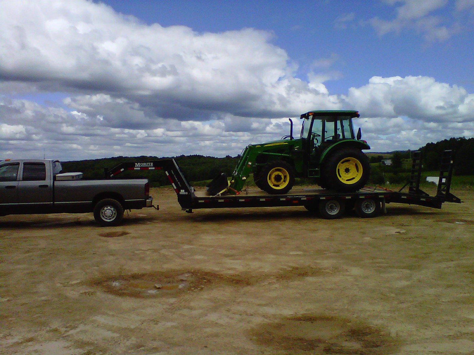

I got a 20 plus 4 dovetail gooseneck that I haul my 5085M w/ H260 loader around on. This setup is a bit heavier than a 5083E w/ 553 loader, but size is about the same I think.
It fits fine without a rear implement, but with something on the back, the bucket needs to go up on the gooseneck itself for sure.
Here is just the tractor on the trailer:
I have hauled this combo before with no issues (sorry, no pic of it loaded on the trailer), although it is real right getting the ramps up. A 5' dovetail or another few feet of deck length would have been nice, but I'm having a hard enough time turning around in tight places as it is with my crew cab long bed truck, so I'm happy with what I got.

My 1 ton SRW cummins and the brand new 5083E. 563NSL, loaded wheels, and a little bit of a pucker factor! I think a dually would help immensely with the weight.

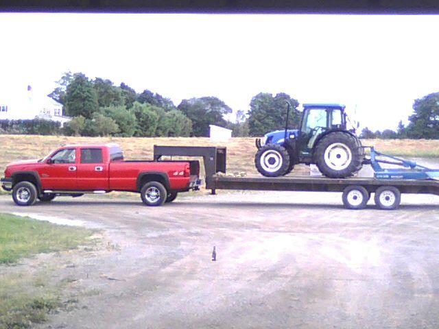

Sorry not a deere, but it's about the same size tractor. The Gn is a 22ft plus 4ft beaver tail
